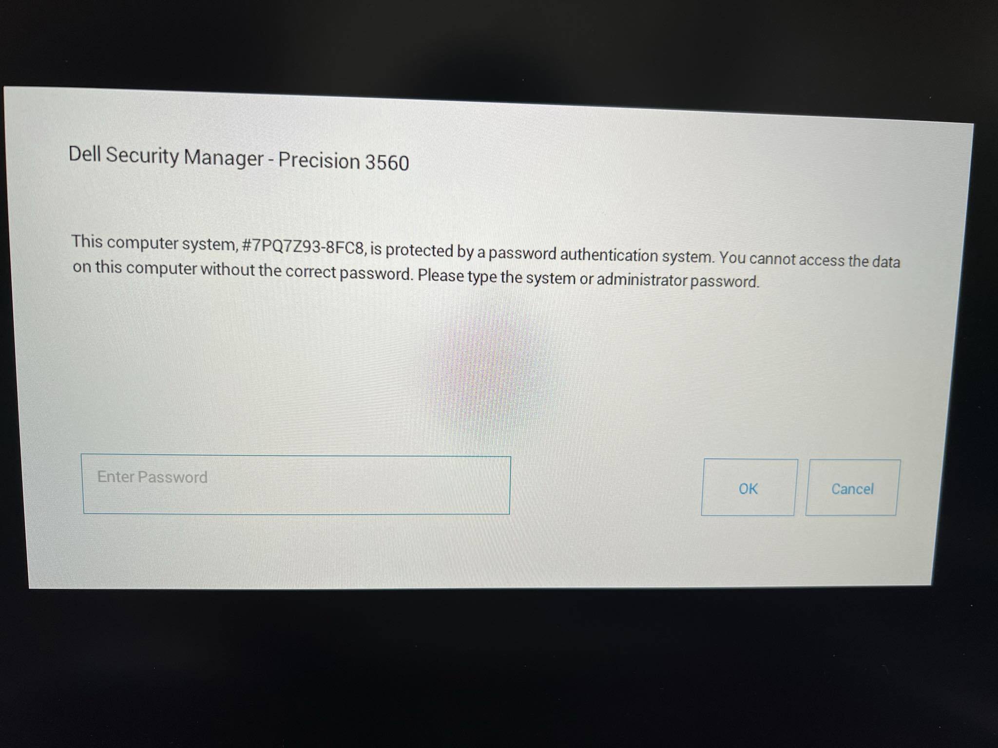

                      Can you help me to remove password Thank you|
                      Dell Precision 3560
                      Service Tag :​7PQ7Z93
                      • Markus1741
                        • Sep 2020
                        • 922
                        • N/A
                        #31
                        Unlocked file ...

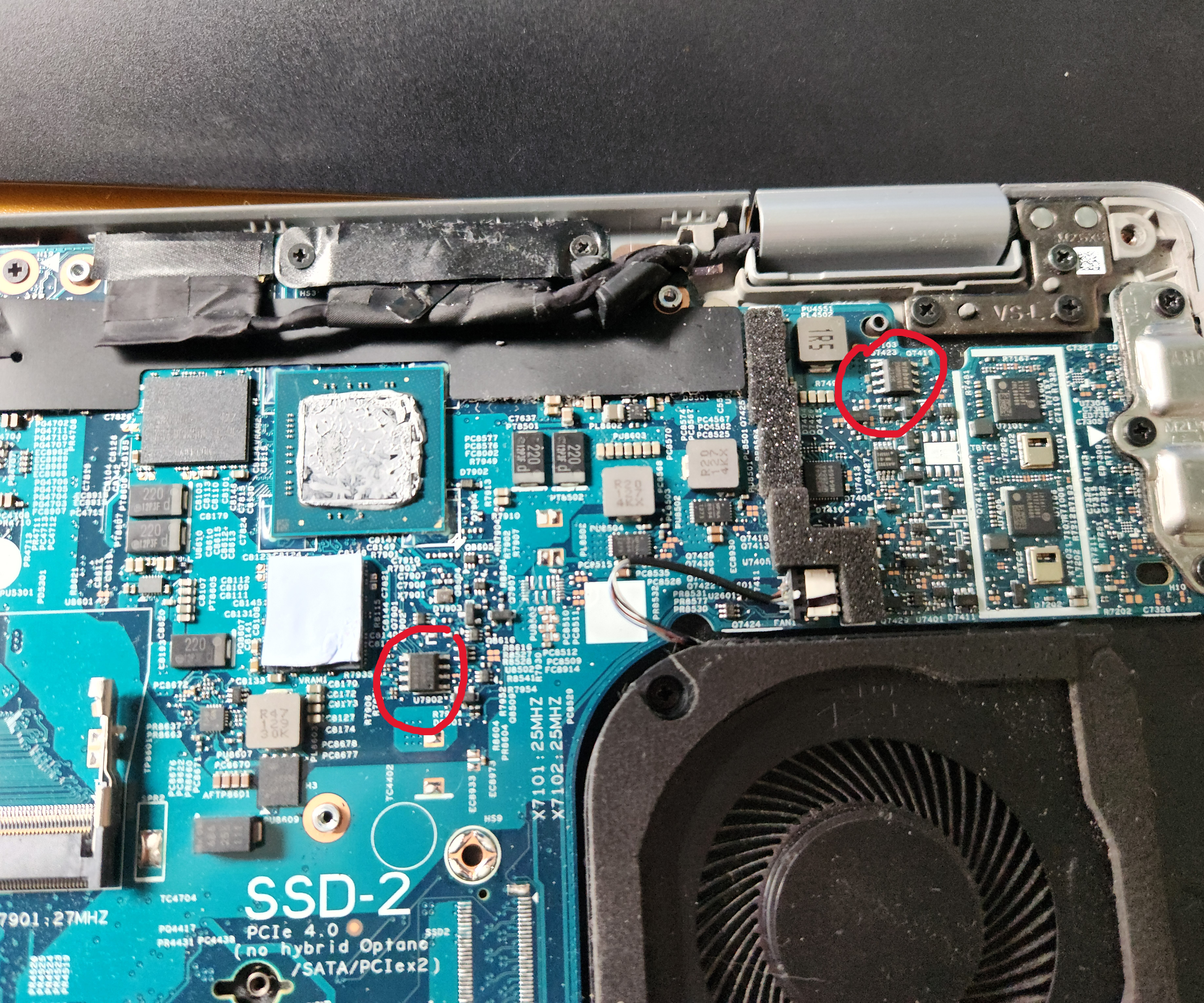

                          Hi guys, I'm new to this so bare with me please, I have my bios password locked, I have tried to grab the files with a programmer (not sure I did it right), I've attached it here, can someone please check if its right and if so unlock it?
                          service tag - 34KS9G3
                          Thank you
                          • peste
                            • Dec 2016
                            • 13421
                            • ROMANIA
                            #33
                            Thank you
                            look for another bios chip on the board, it must have 32MB.. and post the content...

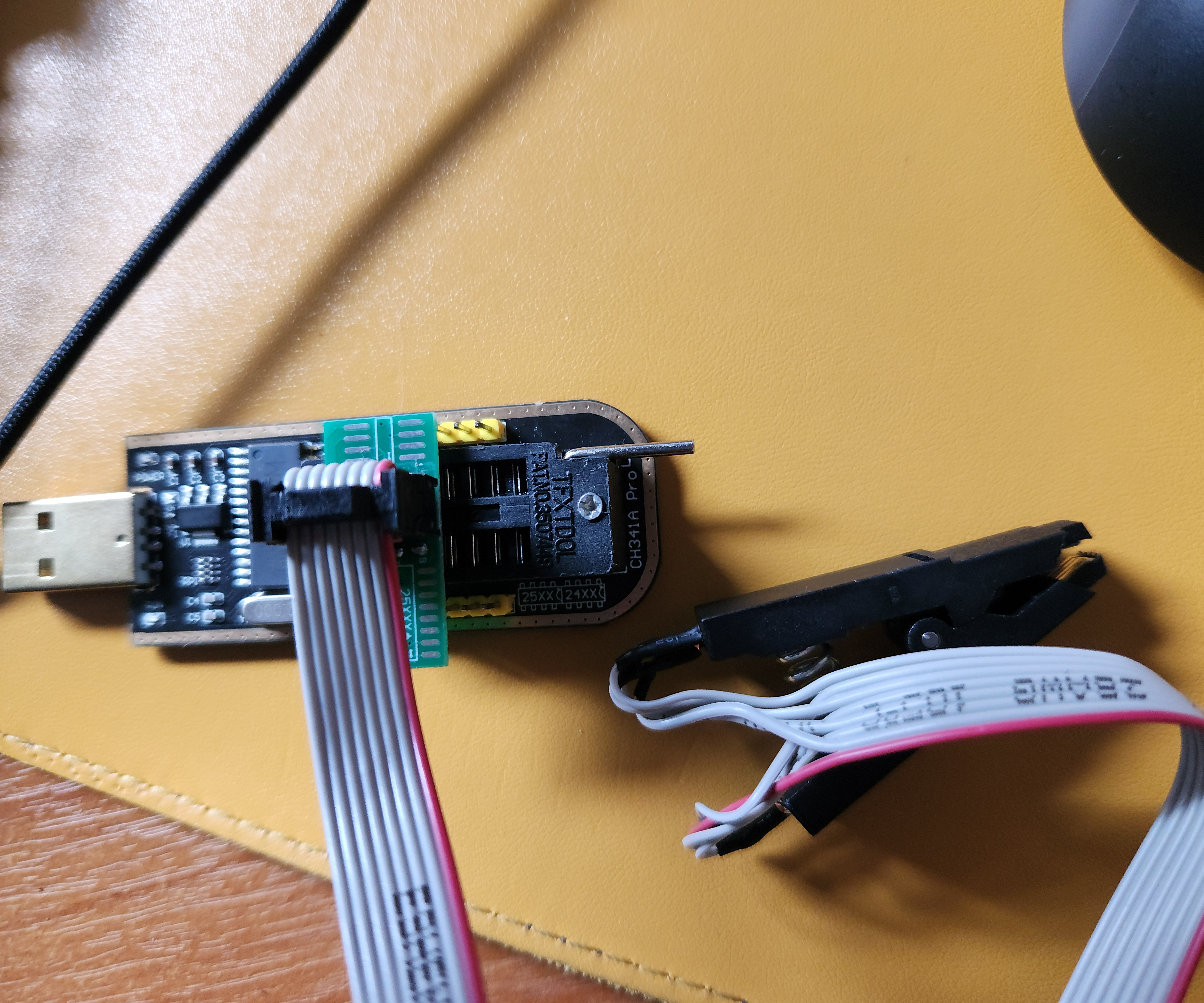

                                Hi guys, thanks for the replies, I found another chip but it also gives me 1mb file, I've tried this 2 in the picture are the only ones visible on this side, you think it can be in the other side of the board?
                                I'm using a CH341A with this clip.
                                • Markus1741
                                  • Sep 2020
                                  • 922
                                  • N/A
                                  #36
                                  no no, both of them are wrong, your bios chip has the label 256 and should be a WSON 8 chip, no spi chip, you won't be successful with your tools.​

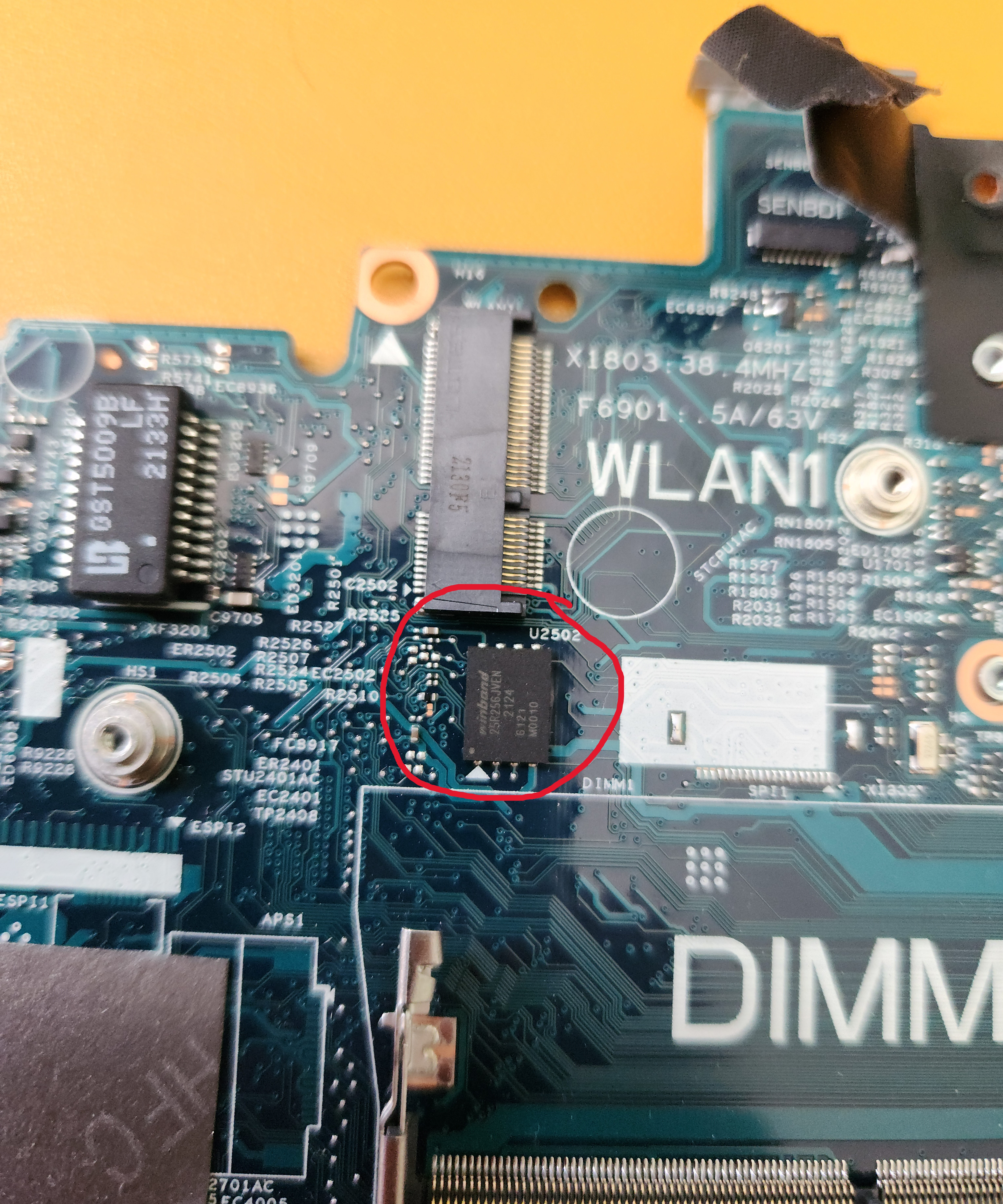

                                      oh, I think I might have found it, do you think its this one?
                                      • Markus1741
                                        • Sep 2020
                                        • 922
                                        • N/A
                                        #39
                                        Yes, that is the BIOS chip. Winbond
                                        Now the easiest and safest thing to do is to desolder the chip provided you have a hot air station.
                                        If you ask like that, I'm assuming you don't have anything like that.
                                        You can also solder very fine wires, but it usually doesn't work.
                                        Possibility of three WSON8 pogo adapters.
                                        If you damage something on the board, things usually get complicated.​
