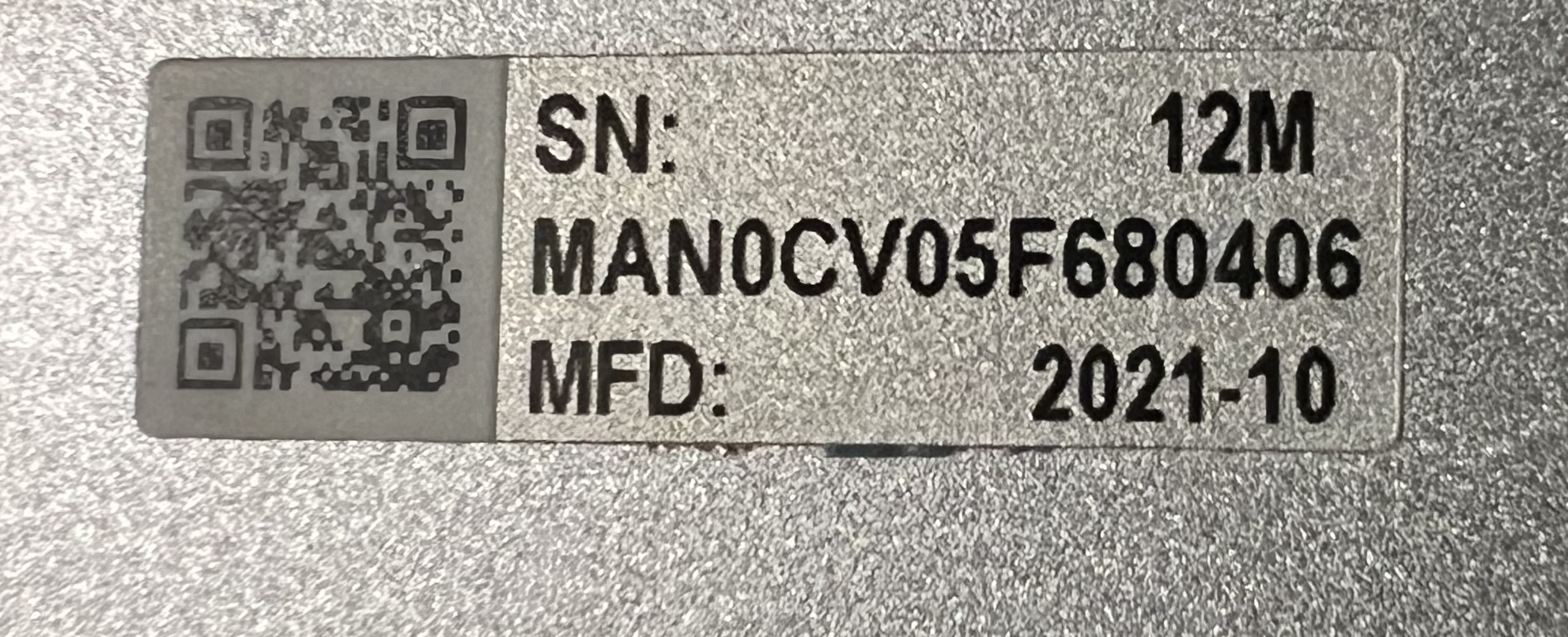

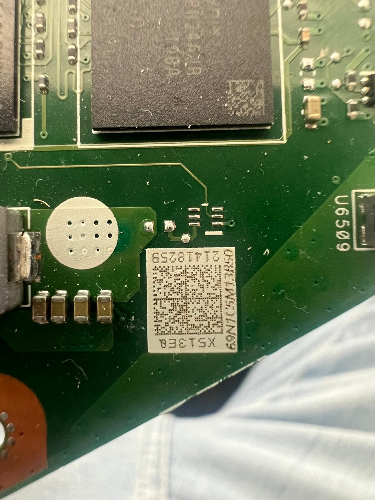

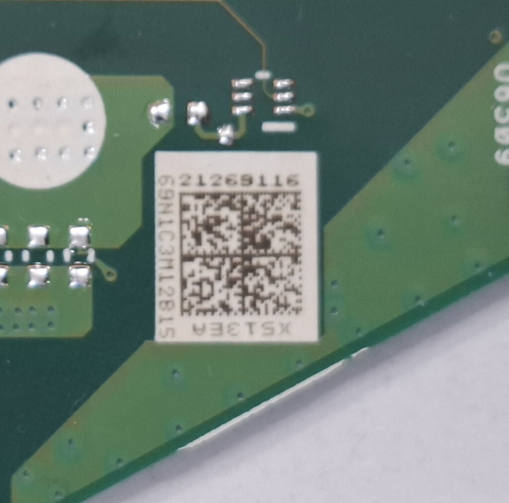

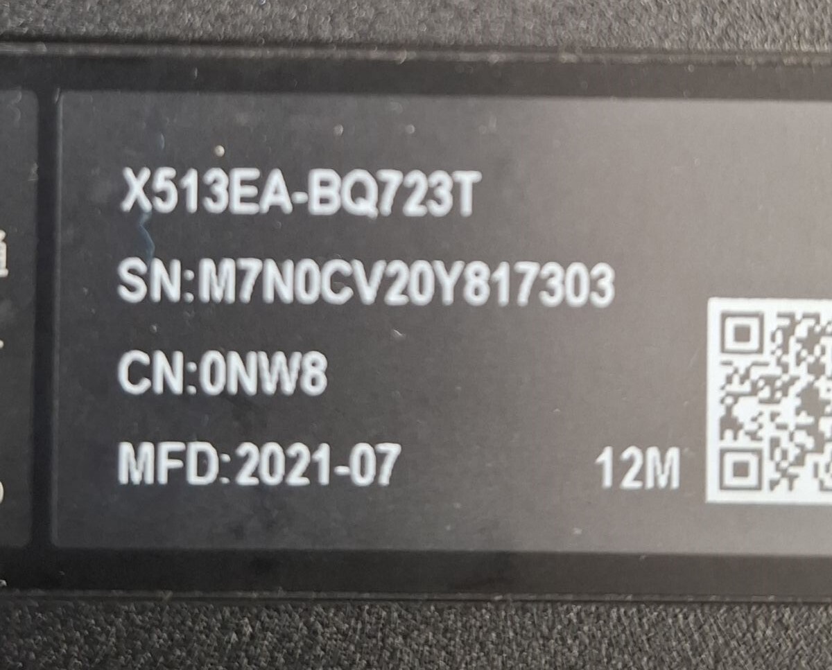

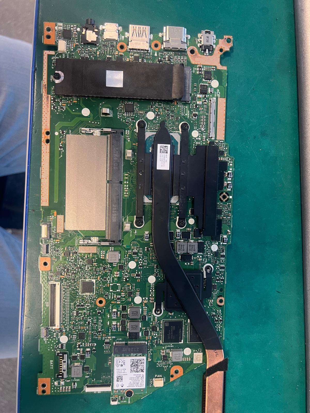

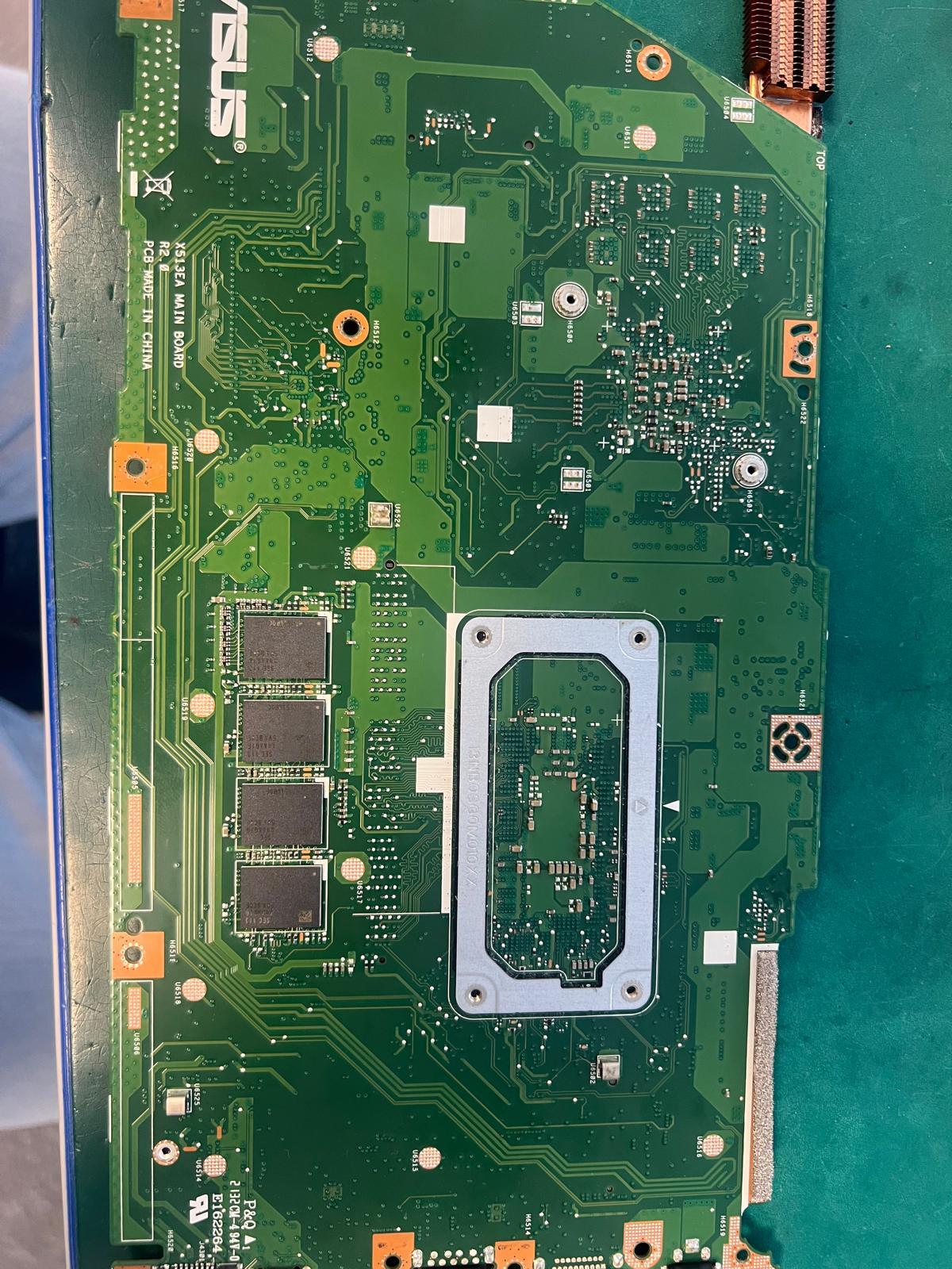

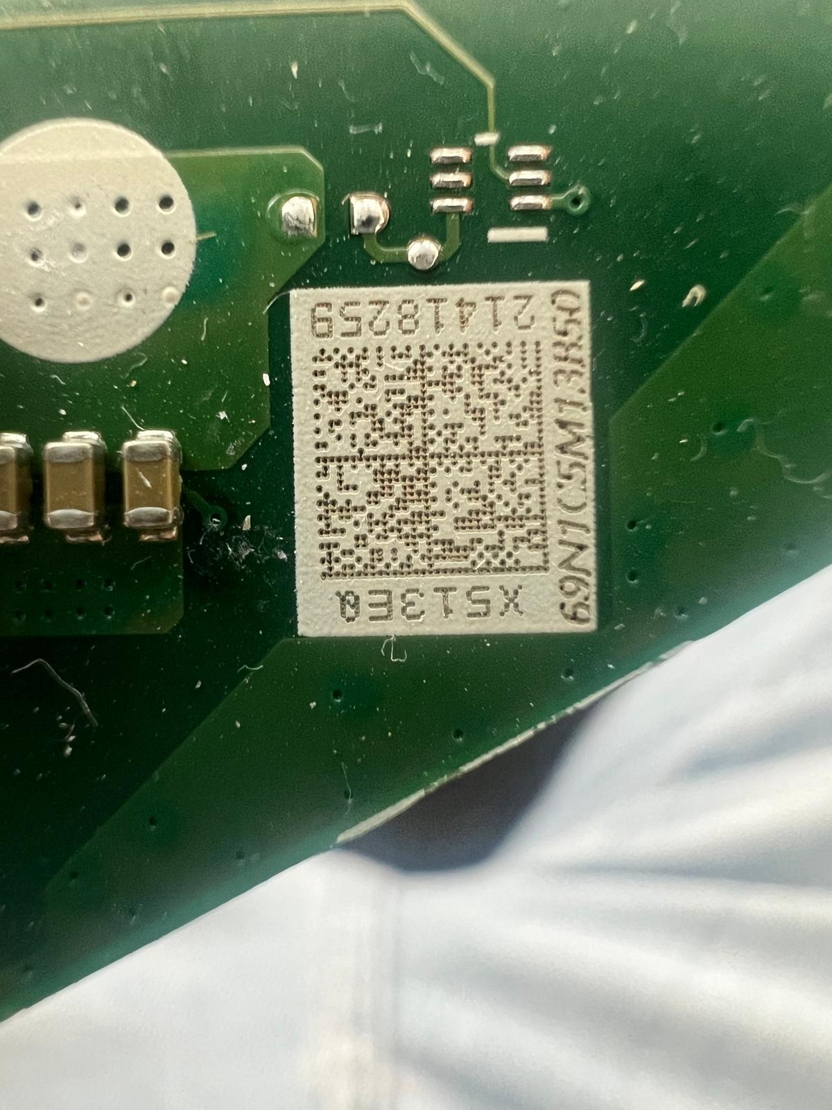

x513EA "R2.0" bios bin required
  • CarlitosMorais
    replied
    OK
    Leave a comment:
    replied
    Originally posted by CarlitosMorais
    Hi..
    Scan that QR code just below the GPU ram and post what it says, or if you can`t scan it post a good clear picture.
    Leave a comment:
  • CarlitosMorais
    replied
    Hi..
    Leave a comment:
  • peste
    replied
    Originally posted by CarlitosMorais
    Hi, plese help.
    My laptop spin fan but no image.
    I need bios dont have backup.
    MB: X513EA R2.0
    S/N: MAN0CV01R75540E
    MODEL: ASUS X513E
    Take pictures of the stickers on the motherboard in the RAM area and post them here.
    Leave a comment:
  • CarlitosMorais
    replied
    Hi, plese help.
    My laptop spin fan but no image.
    I need bios dont have backup.
    MB: X513EA R2.0
    S/N: MAN0CV01R75540E
    MODEL: ASUS X513E
    Leave a comment:
  • IshanDR
    replied
    Originally posted by shiyab
    hi try
    It's Working . Thanks Shiyab.
    Leave a comment:
  • shiyab
    replied
    Originally posted by IshanDR
    Hi, Some one can remove Bios password
    Sn; 36M
    M1N0CV03W228014
    thanks
    hi try
    Leave a comment:
  • IshanDR
    replied
    Hi, Some one can remove Bios password
    Sn; 36M
    M1N0CV03W228014
    thanks
    Leave a comment:
  • hoaca388
    replied
    Originally posted by kleve
    hi! i need ec bin, keyboard and touchpad not wotking. These had random failures, after updating bios they stopped working completely.
    MB: X513EA R2.0
    S/N: CANT READ
    MODEL: ASUS X513E
    attached origanial 16mb bios and 128k ec bin.
    Serial _ L9N0CV14N903392
    Leave a comment:
  • kleve
    replied
    hi! i need ec bin, keyboard and touchpad not wotking. These had random failures, after updating bios they stopped working completely.
    MB: X513EA R2.0
    S/N: CANT READ
    MODEL: ASUS X513E
    attached origanial 16mb bios and 128k ec bin.
    Leave a comment:
  • hoaca388
    replied
    Originally posted by sanjiv16
    good pm admins and everyone!
    can you please rebuild my bios i have asus x513ea no power i'll try some luck to flash bios maybe it will work thank you!
    model:asus x513ea
    sn: M7N0CV26D36330D
    heres my orig back up
    K513EA
    Leave a comment:
  • sanjiv16
    replied
    good pm admins and everyone!
    can you please rebuild my bios i have asus x513ea no power i'll try some luck to flash bios maybe it will work thank you!
    model:asus x513ea
    sn: M7N0CV26D36330D
    heres my orig back up
    Leave a comment:
  • zurvanielle
    replied
    Originally posted by osman68i
    this is bios for x513ean
    try
    TNX A LOT ^_~
    Leave a comment:
  • nagkhal
    replied
    MANY MANY THANKS OSMAN YOU ARE MY LIFE SAVER, YOUR BIN FILE WORKS GREAT. Asus detecting power supply and charging.
    Leave a comment:
  • osman68i
    replied
    Originally posted by nagkhal
    Hi, i need a bios for X513EA PLEASE, tried a bios that boot up the notebook but wasnt detecting the power supply connexion (System power connexion failure) in bios batterie was draining even if its hooked up.
    now doesnt boot anymore, cuase battery dained and not detecting power supply.
    i dont have any bios backup.
    SN: M8N0CV12B20333H
    TAG: 962A2RUGP
    this is bios for x513ean
    try
    Leave a comment:
  • nagkhal
    replied
    Hi, i need a bios for X513EA PLEASE, tried a bios that boot up the notebook but wasnt detecting the power supply connexion (System power connexion failure) in bios batterie was draining even if its hooked up.
    now doesnt boot anymore, cuase battery dained and not detecting power supply.
    i dont have any bios backup.
    SN: M8N0CV12B20333H
    TAG: 962A2RUGP
    Leave a comment:
  • shiyab
    replied
    Originally posted by manol278
    Hello.Help me please with bios.
    Power on, CPU hot, no display, fan not spinning, the voltage levels are all there.
    I've already tried the bios at the beginning of the thread. Unfortunately , it doesn't work...
    Backup bios, QR code, serial in attachments.
    M/B: X513EA R2.0
    S/N M7N0CV20Y817303​
    hi try
    Leave a comment:
  • manol278
    replied
    Hello.Help me please with bios.
    Power on, CPU hot, no display, fan not spinning, the voltage levels are all there.
    I've already tried the bios at the beginning of the thread. Unfortunately , it doesn't work...
    Backup bios, QR code, serial in attachments.
    M/B: X513EA R2.0
    S/N M7N0CV20Y817303​
    Leave a comment:
  • hoaca388
    replied
    Originally posted by SergeyL
    This is very strange. With this dump the power button blinks twice and turns off and nothing else happens. I tried to flash the old bios and everything is the same as before - turns on, the battery indicator blinks twice, the processor is hot, the fan starts, but the screen is black.
    Find hardhware.
    Leave a comment:
  • SergeyL
    replied
    Originally posted by hoaca388
    X513EA
    This is very strange. With this dump the power button blinks twice and turns off and nothing else happens. I tried to flash the old bios and everything is the same as before - turns on, the battery indicator blinks twice, the processor is hot, the fan starts, but the screen is black.
    Leave a comment:
    ASUS VivoBook X513EA-BQ349T Notebook 15 Specification for Upgrade or Repair
    This specification for the ASUS VivoBook X513EA-BQ349T Notebook can be useful for upgrading or repairing a laptop that is not working. As a community we are working through our specifications to add valuable data like the X513EA-BQ349T boardview and X513EA-BQ349T schematic. Our users have donated over 1 million documents which are being added to the site. This page will be updated soon with additional information. Alternatively you can request additional help from our users directly on the relevant badcaps forum. Please note that we offer no warranties that any specification, datasheet, or download...
    09-06-2024, 10:00 PM
  • Wutru
    HP Elitebook 820 G4 BIOS repair assistance required
    by Wutru
    Hi guys,
    If someone would be able to provide some expertise, I'd be very grateful.
    BIOS Corruption - Cause
    So I managed to corrupt my machine by installing linux and enrolling custom secure boot keys. I did choose to enroll the Microsoft keys as well, to prevent any potential bricking due to 3rd party drivers from HP being signed with those keys.
    After doing that, and rebooting(it did boot, powerLED, fanspin etc.), the laptop did not give any video output on the LCD or video connectors. I think I was able to get in BIOS and trigger the beeper by pressing ESC....
    09-06-2025, 10:32 AM
  • macabook
    by macabook
    🧩 Initial Issue
    07-24-2025, 02:17 PM
  • greelidd
    K6604J Vivobook RTX 4070 BIOS Dump Request
    by greelidd
    Hi all! Tldr: need a bios dump (.bin format) for K6604J (rtx 4070 and i9-13980hx)
    Longer story: my vivobook stopped booting after i switched out the thermal paste. I think the BIOS got corrupted. Everything i tried didn’t work until finally i decided to buy a CH341A BIOS programmer and just send over the BIOS directly from another PC onto the BIOS chip. I connected fine and backed up the existing BIOS, but i can’t find a clean BIOS that’s a .bin format. And I tried using UEFI software to extract all the files from the ASUS BIOS .exe file and get to the .bin but it was a .302...
    09-01-2025, 06:14 PM
    ASUS VivoBook X513EA-BQ1281T Notebook Specification for Upgrade or Repair
    This specification for the ASUS VivoBook X513EA-BQ1281T Notebook can be useful for upgrading or repairing a laptop that is not working. As a community we are working through our specifications to add valuable data like the X513EA-BQ1281T boardview and X513EA-BQ1281T schematic. Our users have donated over 1 million documents which are being added to the site. This page will be updated soon with additional information. Alternatively you can request additional help from our users directly on the relevant badcaps forum. Please note that we offer no warranties that any specification, datasheet, or...
    09-07-2024, 01:30 AM
