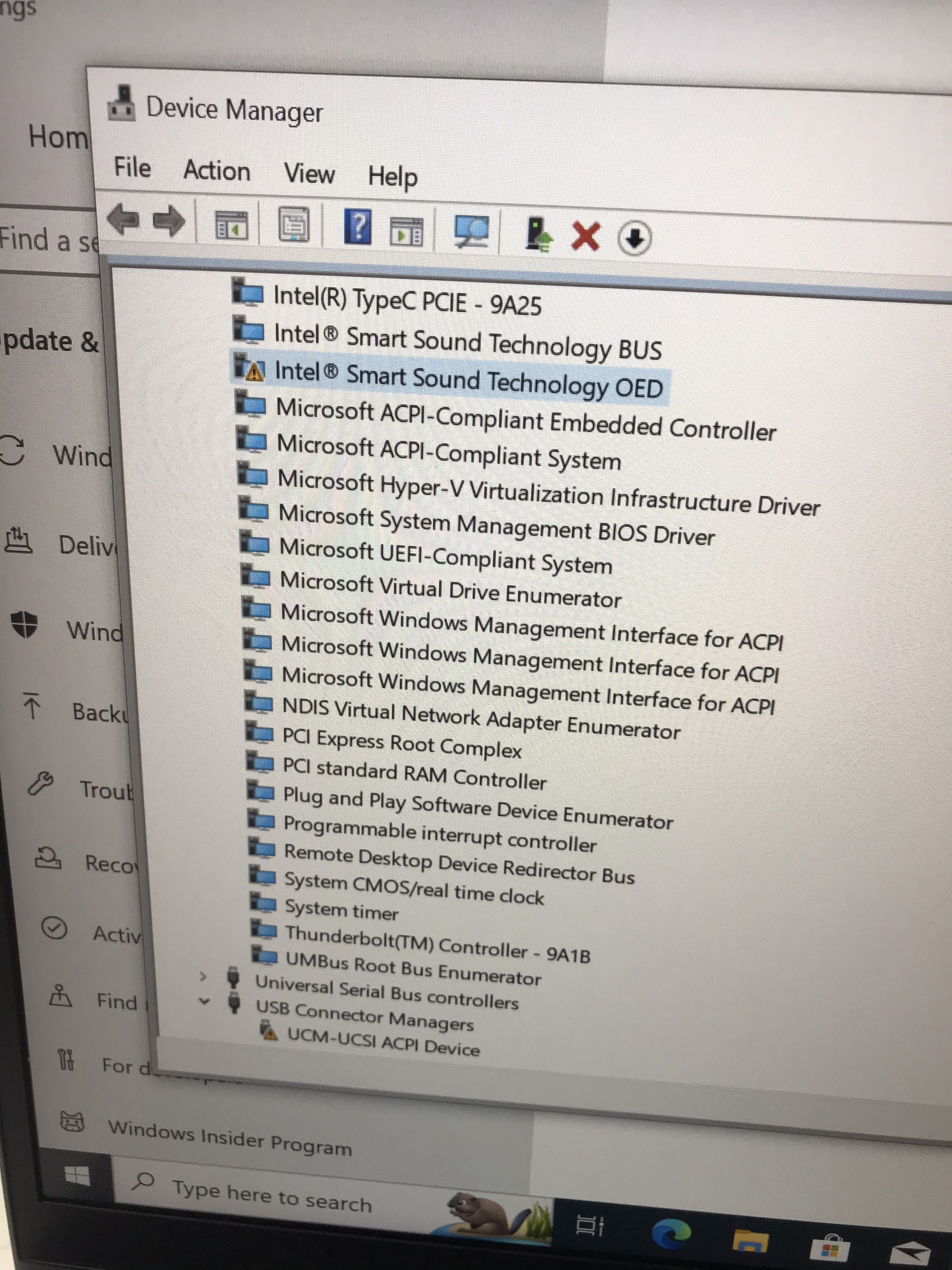

      HI. thanks for your help. this file worked. but very slow turn on hp logo and have some problem in drivers!
        • 20299
        Re: HP hp zbook firefly 14 g8 25Q256 (32mb)
        Clean the ME firmware to fix the slow boot,and install audio drivers from HP support
        How to clean ME/TXE region https://www.badcaps.net/forum/showpo...41&postcount=3

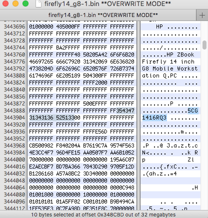

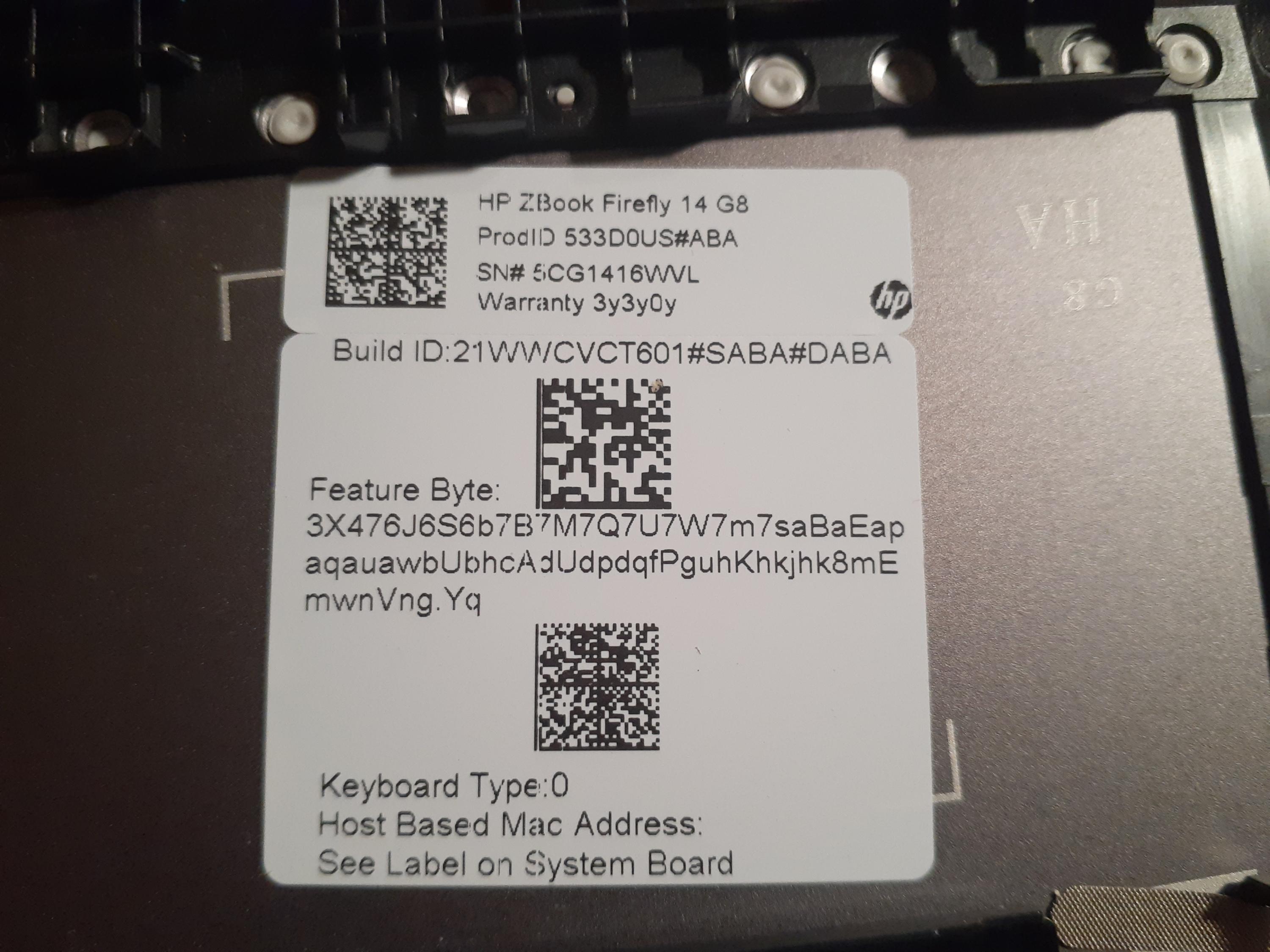

                      your bios is for "HP ZBook Firefly 14 inch G8 Mobile Workstation Q PC" also S/N embedded in bios indicates the same.
                      At 1st boot press F10 and RESET BIOS to factory defaults, save, restart and password will go on. After that enter in bios setup and in Main tab you have "set machine unique data" and write there what it's written on the label inside the cover. Or extract DMI from your bios dump:
                      Feature Byte: 3X476J6S6b7B7M7Q7U7W7m7saBaEapaqauawbUbhcAdUdpdqfPguhKhkjhk8mEmwnVng.Yq (no spaces)
                      Serial: 5CG1416RQ3
                      SKU: 533D0US#ABA
                      Build ID: 21WWCVCT601#SABA#DABA
                      Board CT: PKUHE00WBFS0RY
                      Name: HP ZBook Firefly G8 Mobile Workstation PC
                      Save and use BCU to exit MPM mode or restart laptop/desktop how many times counter shows.
                      REMOVE CMOS BATTERY BEFORE WRITING BIOS!

                        Thanks a Million for walking me through that and providing the instructions to do it! It worked! Was wondering why the RCunlocker exe tool did not produce an unlock bin for me? Do I not have the correct version?
