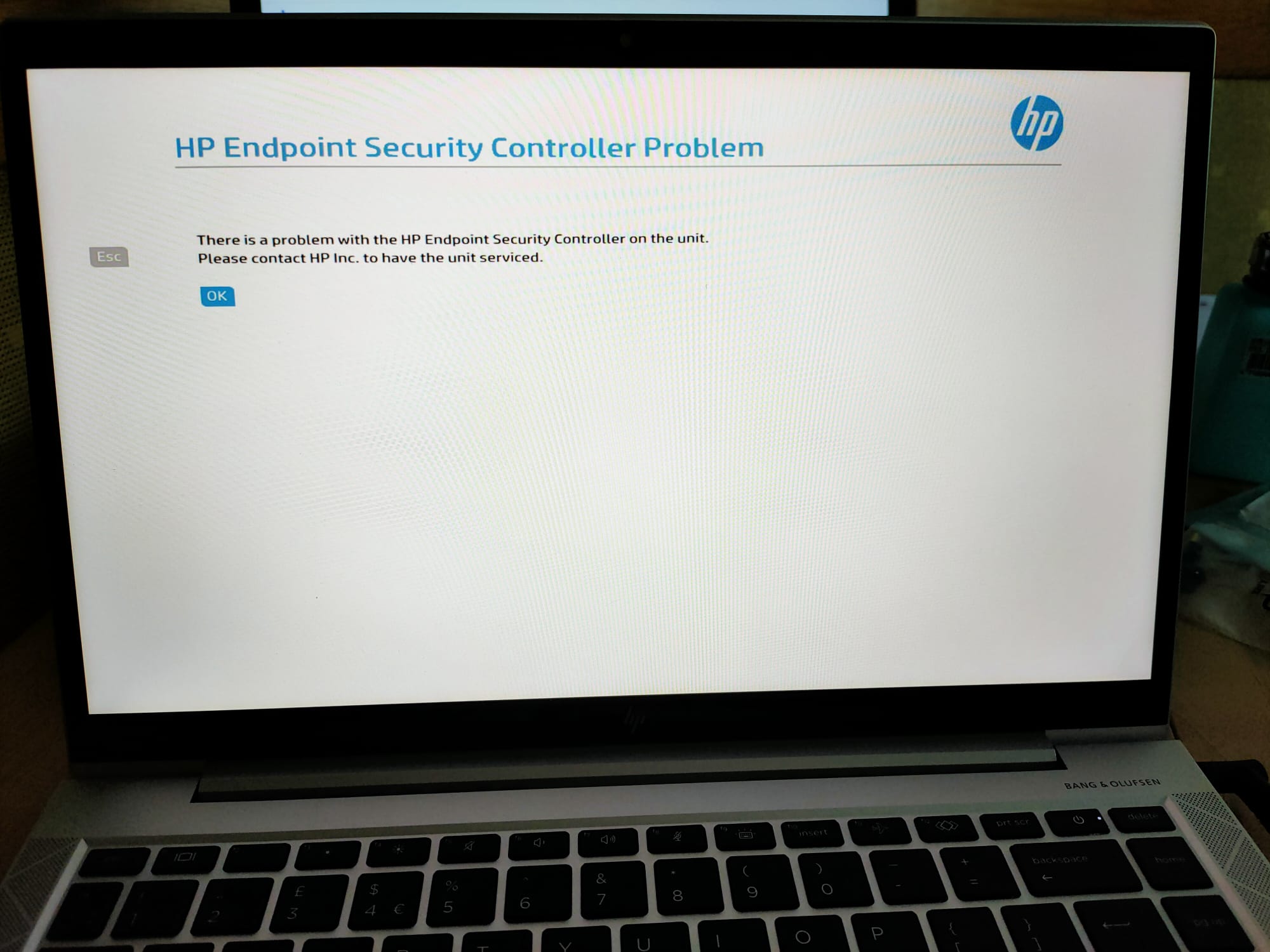

              Help me please remove the messege after unlock the bios(hp endpoint security controller). In attached files bout my bios files. Thank you in advance!
              • Vesko356
                VIP Moderator
                • Aug 2018
                • 4386
                • Bulgaria 🇧🇬
                Re: Hp ZBook studio g8 bios password unlock
                HP ZBook Studio G8 and HP Zbook Firefly G8 are different models - find a matching thread, or if there's no such one created, make a new one.
