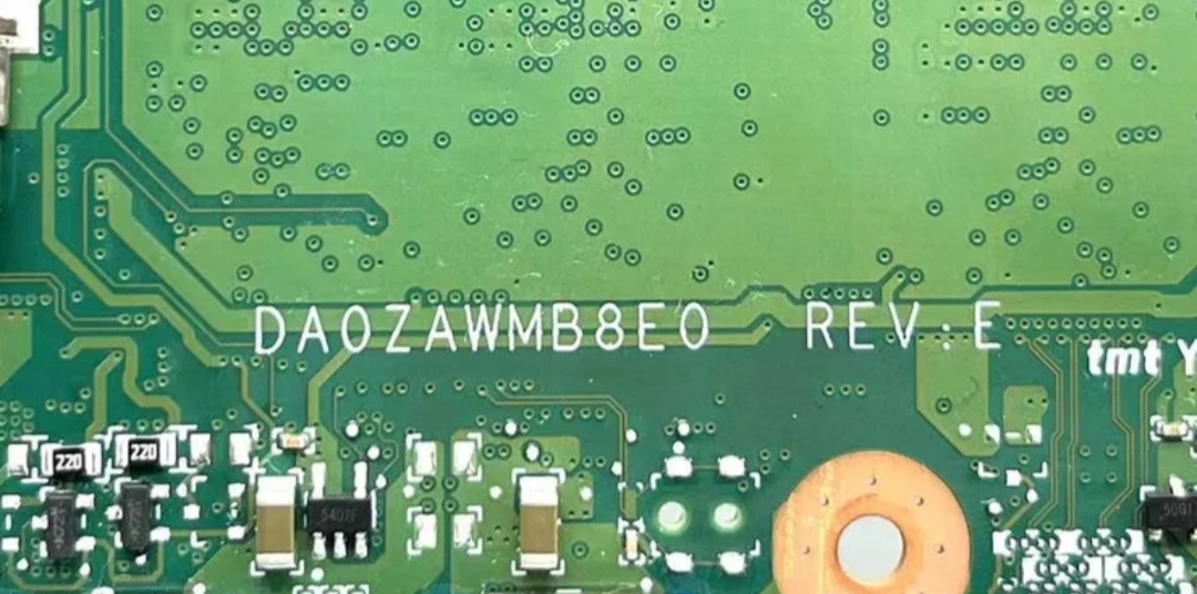

    Not even a total dead LED lights up, the customer says he sparked the power supply in the power jack which I found broken, in fact I power it with soldered cables on main, replaced the power jack input diode which was broken. Mod. mb DA0ZAWMB8E0 rev.E

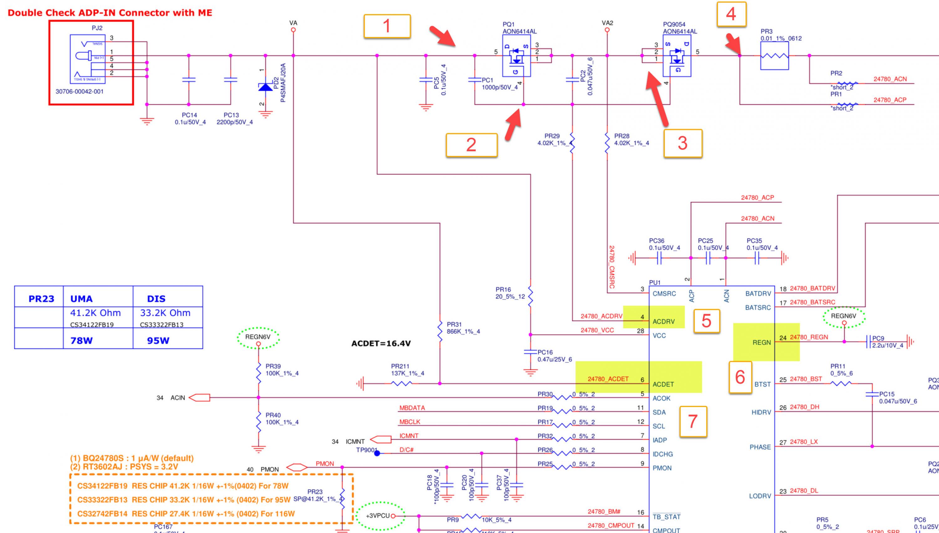

    Need voltage checks. See attached. Post the measurement of each test point.
    Meter in DC volts (20V or higher scale) -> attach your power adapter.
    Measure the voltage to ground of each test point.

      On pq1 and only on pin 1 19v on the remaining pins of pq1 0v and 0v also on all the other indicated points (2/3/4 etc) Thanks

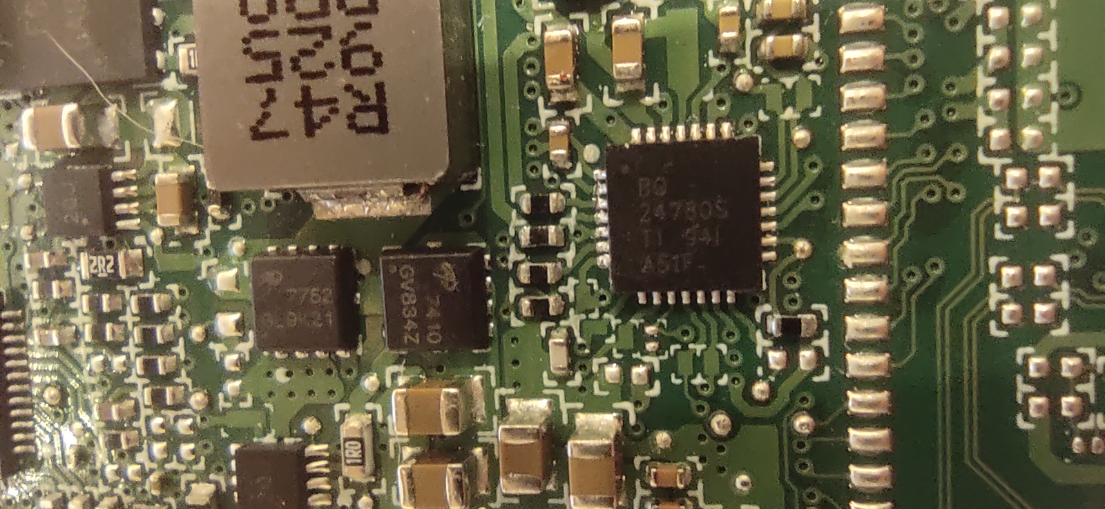

        Can you measure the voltages on pin #28 of the charger IC? This is the power pin on the charger IC.
        Confirm again that REGN pin #24 on the charger IC is 0 volts?

          I found on 28 19v, on other pins: 5 variable value from 0 to 3v on 6 2.55v on 24 6v

            Power down. Remove the 4k resistor on the ACDRV pin. Do not lose this part.
            Power up again. Then carefully measure the voltage to ground on the ACDRV pin.
            What is the voltage? It should be ~25v.

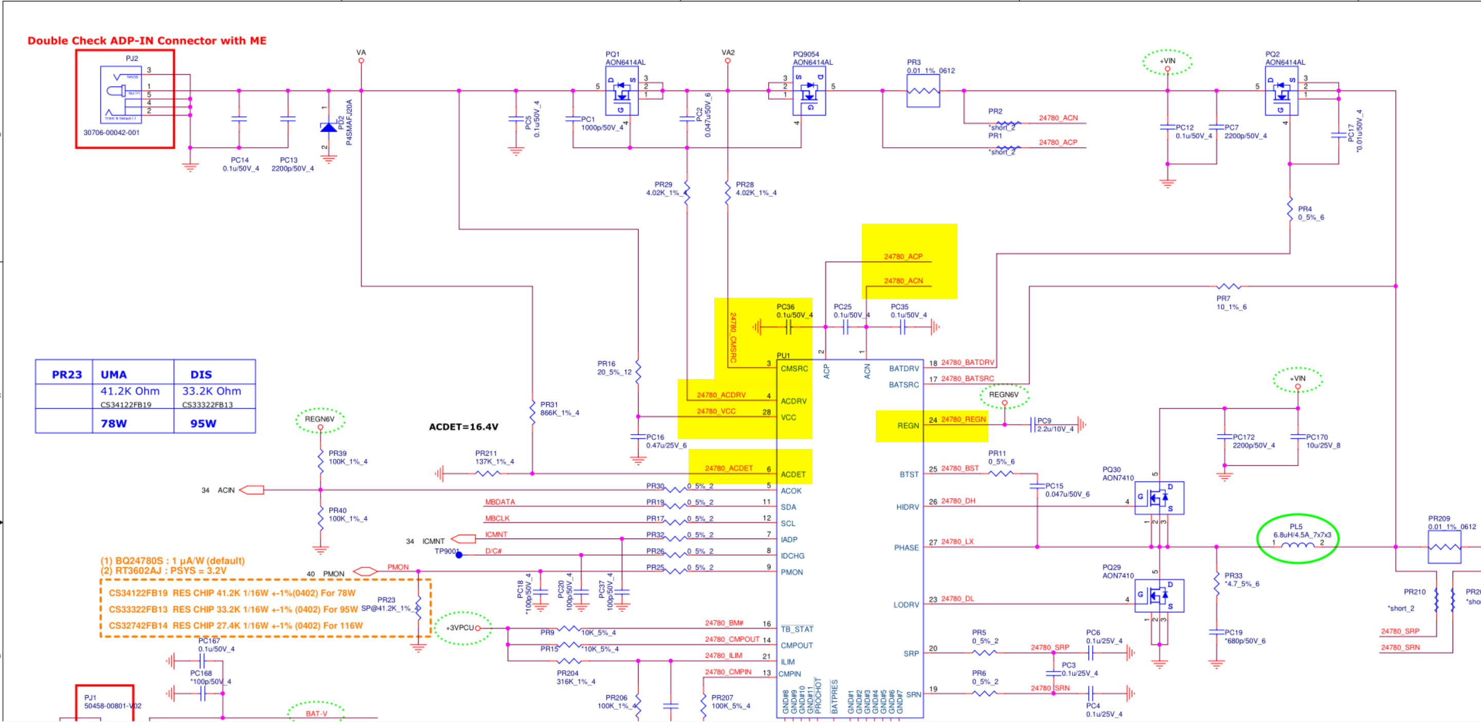

                    Review the attached. With extreme care, with the power adapter connected -> measure the voltage to ground of each highlighted pin.
                    Post each measurement.

                      Re: Acer a315-55g-73n7
                      (PU1) Measurement:
                      pin 3 CMSRC =19,1v
                      pin 4 ACDRV =24,9v
                      pin 28 VCC =18,9v
                      pin 6 ACDET =2,6v
                      pin 1 ACN =19,1v
                      pin 2 ACP =19,1v
                      pin 24 REGN =6v
                      • mon2
                        • Dec 2019
                        • 13996
                        These are all good voltage measurements in the shared list.

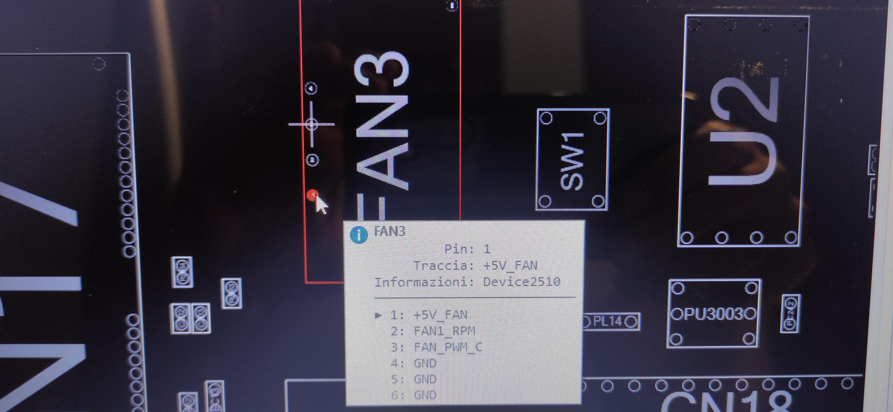

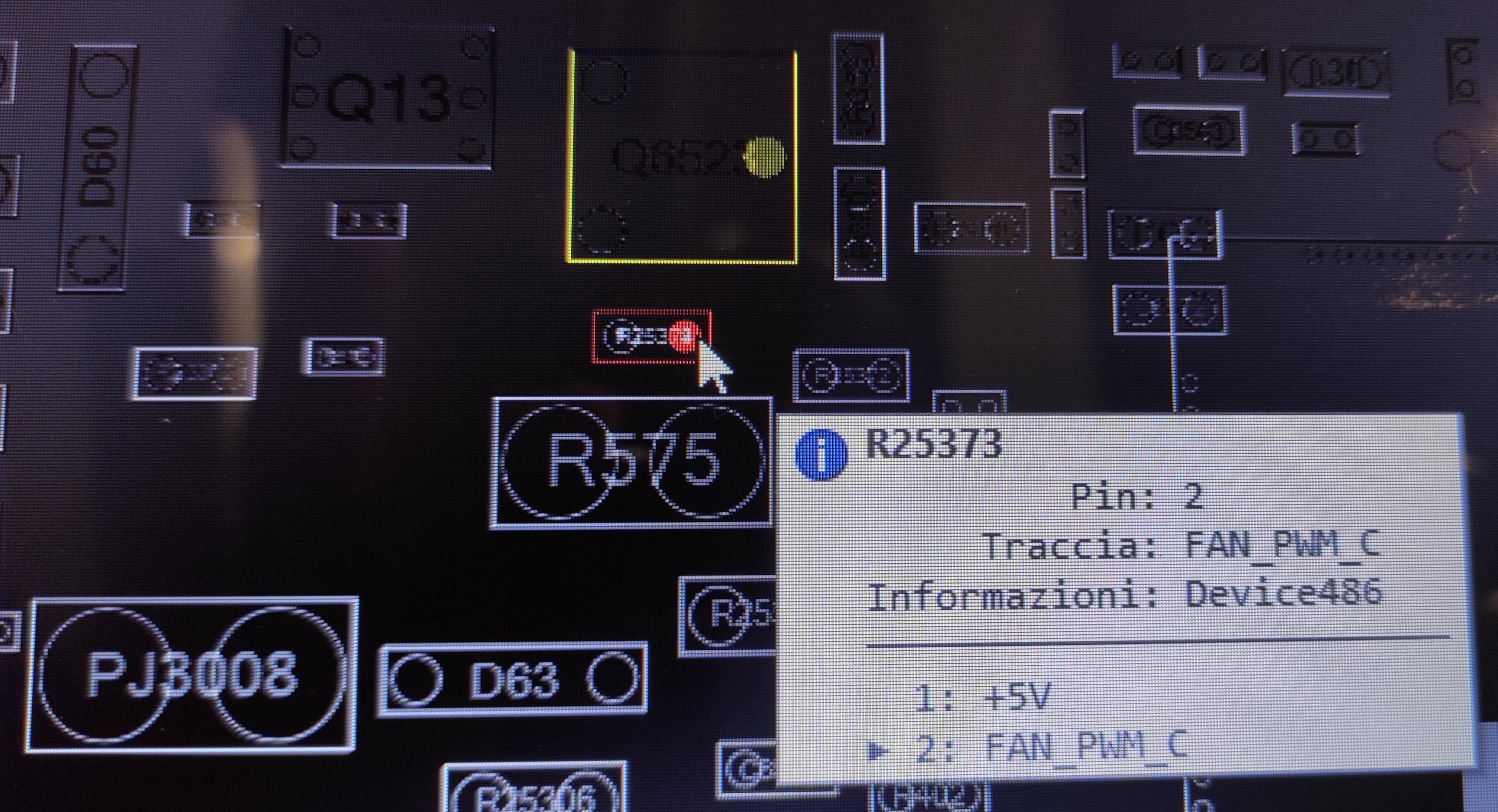

                              I connected the power to motherboard and to pin n° 1 of fan connector and there isn't 5 volts.
                              The trace is attached.
                                Why you are after the fan at this stage when motherboard is not even turning on? Report back on post#14
