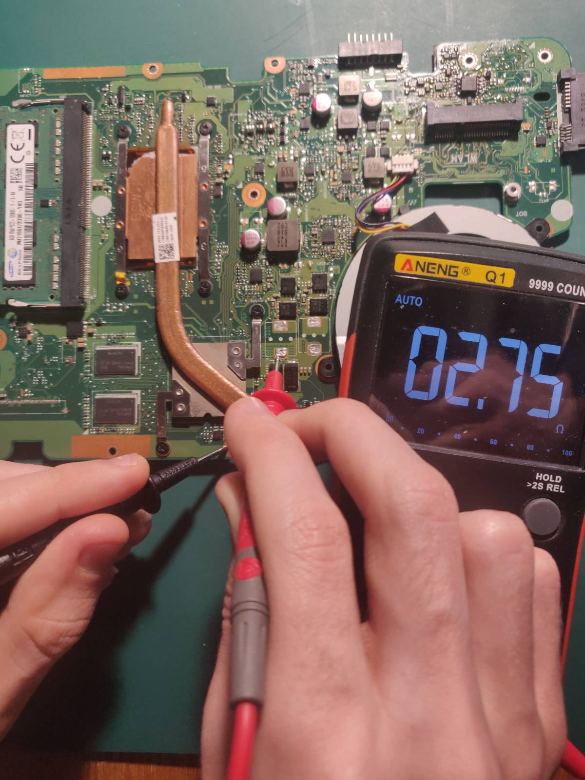

    What is the resistance on GPU coils?? They may not be shorted as they are supposed to be low resistance lines. Dont measure in diode mode, set your meter to 200 Ohms scale and check resistance on GPU coils.

      I had a hard time desoldering those coils back then and I would have to find them in my parts bin, but it's possible to solder them back if they are needed for testing, but not now as of me writing this response. If it helps, right now I get 2.75ohms and -0.10ohms, because of the lead resistance, so it would be 2.65ohms on the GPU side, where the coil is supposed to be (I attached a picture, which shows where I took the measurement).

        2.65 Ohms on GPU coil is not short.

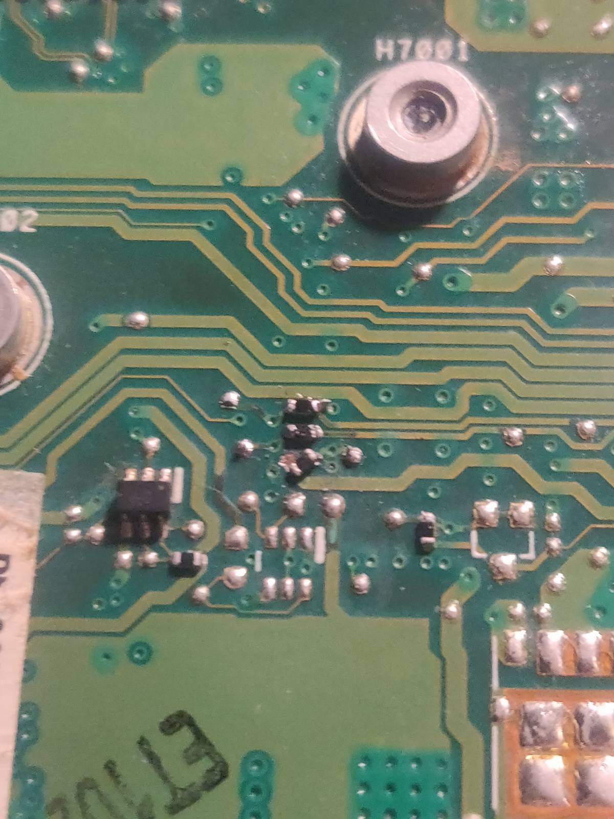

              Well I be damned, that video literally is the solution. He showed at 21:35 in video a small resistor, which has died. I found the exact spot, where is this resistor located and I noticed that the end of the resistor was gone and the pad has disintegrated with it. Maybe coke did the damage? Anyways I scrapped off just a little of the trace to reveal copper and I soldered a new resistor on. You will see how it looks in picture, one resistor is soldered at an angle. No idea if it's the correct resistor, but I'll be damned this small small component caused the whole laptop to die. I'm genuinely so amazed that I encountered my first laptop motherboard fix, which involves swapping in a new component.

                Update - laptop doesn't work again. Laptop did boot into BIOS and I plugged in my Ventoy USB and it didn't show up. I plugged in a hard drive, no success and even a windows 7 boot DVD didn't work. After putting in a battery and plugging in the power cord, I got no boot at all. After removing the battery and plugging in the power cord, the fan doesn't even attempt to spin at all. It's like dead now.
                Ideas?

                  Asus use long bare copper pads as test points around the boards. As they have no mask, they typically corrode after a liquid spill (or even from fan dust) and go open circuit. Any that don't have the bright copper colour, you scrape with an exacto knife to check that the pad is intact. Solder or bridge as needed. Asus have been putting a plastic membrane with adhesive on their boards now on the keyboard facing side to stop this. Not sure about this model.
                  If the liquid spill is big enough, and contaminated enough of the board, experience says these devices should be written off. Proper remediation is indentifying each corroded component/track/via under a microscope, repair/replace/jumper/bridge, followed by ultrasonic cleaning to remove any further contaminants. If you don't have the right tank and chemicals, I suggest writing off this board.
