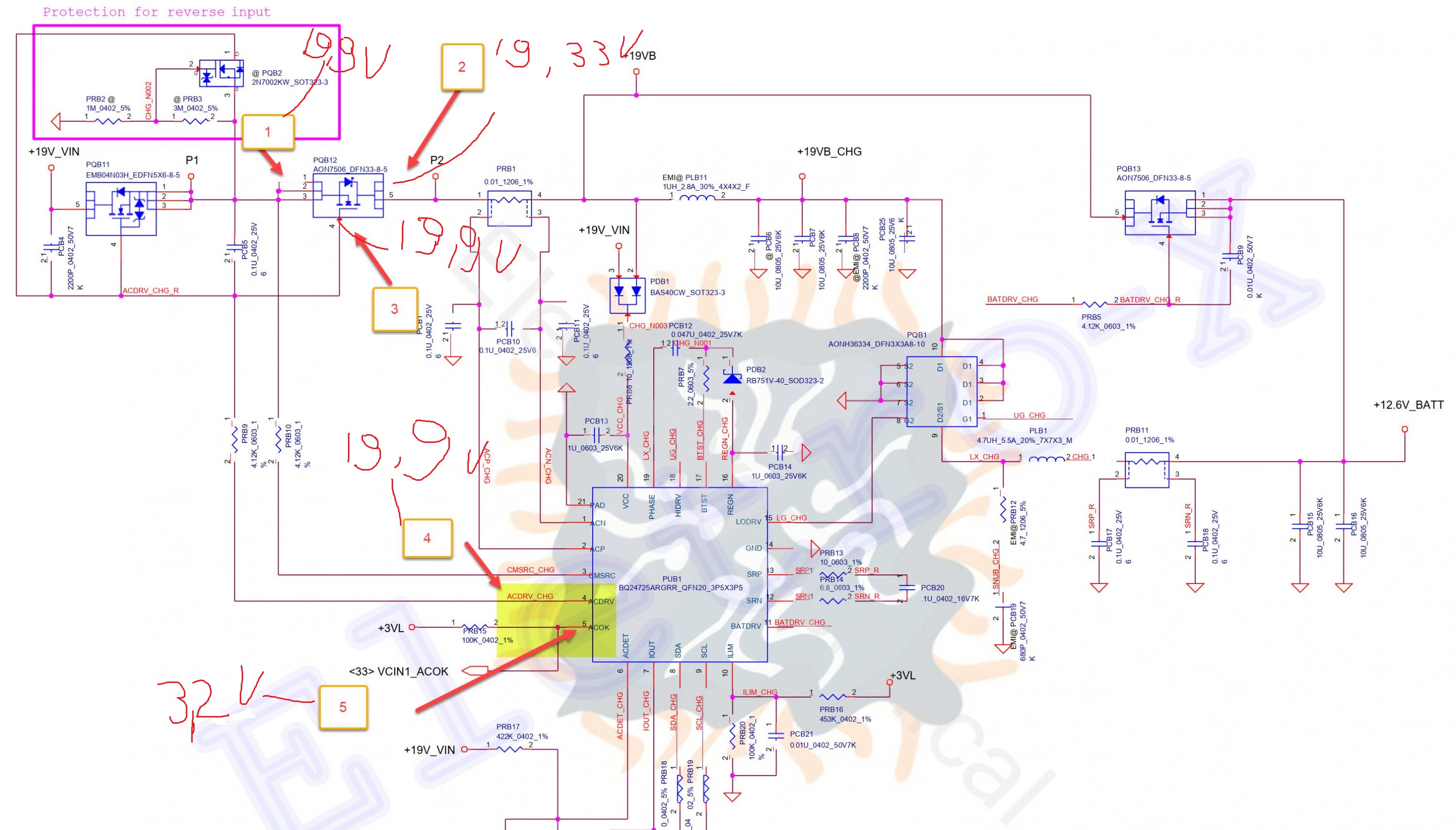

    hello how are you .... i have a laptop hp 15bs199nl which does not charge. When I put the power supply, the dc light turns orange but the laptop does not charge. I thought it was the battery, but luckily I have another laptop like that and I realized that the defect is the board. I changed the 8q25a ic charging but no change anything ..
    I see that this laptop has the same charging scheme as the hp 250 g6, the scheme I found in this forum, I made some measurements but I don't understand where the defect is.
    I am also uploading the scheme, if you help me tell me where to make the measurements. 19 Vin is ok laptop turn on with battery
    With charger and battery input voltage in PL13 PL14 is 14.4 v
    voltage in ic charger + battery
    20=vcc-19.43v
    19=Phase 14.41 v
    18=hidrv ov
    17=Btst 14.13 v
    16=Regn 6v
    11 Badrv 14,39

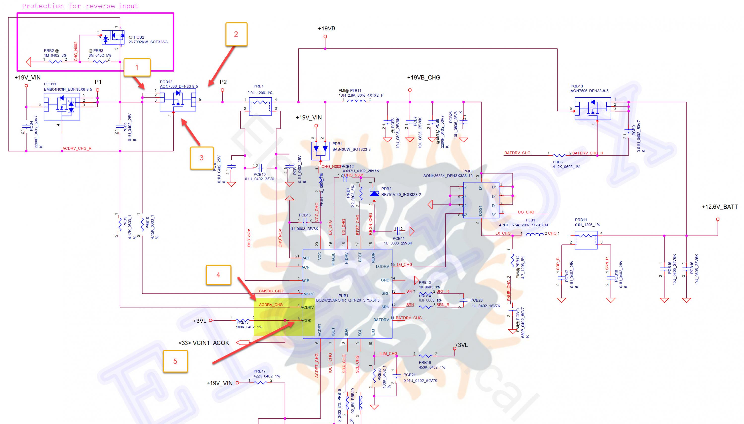

    Re: Hp -15bs199nl not charching
    See attached.
    Attach the power adapter. Meter in DC volts (20V or higher) scale.
    Red meter probe to pin to test.
    Black meter probe to ground.
    Measure the voltage to ground of each requested test point (#1..5).
    Often the 2nd DCin mosfet gets damaged and has to be replaced but perform these checks to confirm the details.
    • arber1232
      • Dec 2019
      • 379
      • Albania
      Originally posted by mon2
      See attached.
      I explain in photo voltages

            • arber1232
              • Dec 2019
              • 379
              • Albania
              i change but is same voltage 19.33v
