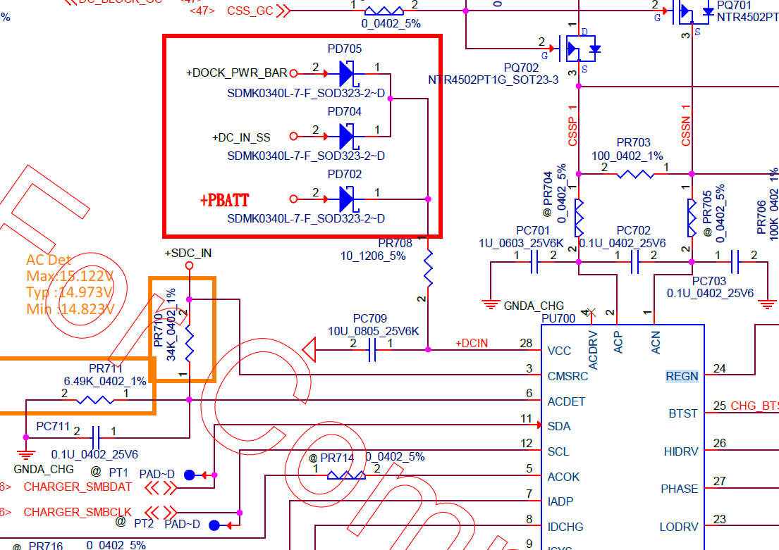

    HI, how are you. I have a dell laptop which does not turn on with charger and not charching
    the light of the power button for a while and turns off, with battery the laptop turns on and works fine. I have done some measurements and I doubt Pq705 but I want your help to be sure....
    Some measurements of pq 705 with charger without battery
    D1-19,13y
    S1/D2- voltage change 12v to 10v 13v
    G1- voltage change 13v, 14v, 16v
    G2-ov
    S2-gnd

      Be sure the adapter is original and of the correct power rating.
      Measure the voltage to ground of NB_PSID. This is from the power adapter center pin but on the logic board.
      Post the measurement.

        Next, check on the charger IC, the voltage to ground of:
        VCC
        REGN
        ACDET
        Pins. Do connect the adapter. Post each measurement.

          i try with 2 Adapter
          NB_PSID-3,2v
          VCC- Change to 10v 12v 13 v
          REGN-5.3v
          ACDET-3,1v

            Re: Dell E7450 not charching La-A961P
            Ok. Focus on VCC - it should be stable.
            Measure the voltage to ground before PR708. Is it stable ?
            Then measure BEFORE PD704. This diode should provide a low voltage drop from the power adapter and then power the VCC rail but it should be stable.
            Once this VCC is stable, then REGN should be ~6 volts. Confirm it.
              Measure the voltage to ground before PR708. Is it stable ? Yes 19,34 volt
              I find problem is PR708 CHANGE OHMS
              I CHANGE AND NOW WORK OK

                Remove all power. Meter in resistance mode.
                Check the resistance across the 2 pins of PR708.
                Next, still with no power -> measure the resistance to ground of the VCC pin on the charger IC. We are checking for a low resistance on the VCC pin which may be causing the voltage to fluctuate.
                What are the resistance readings ?
                • arber1232
                  • Dec 2019
                  • 378
                  • Albania
                  Thank you, pr708 had changed the value from 10 ohm, it was somewhere around 2.7 kohm
                  i change pr and laptop turn on and charging
