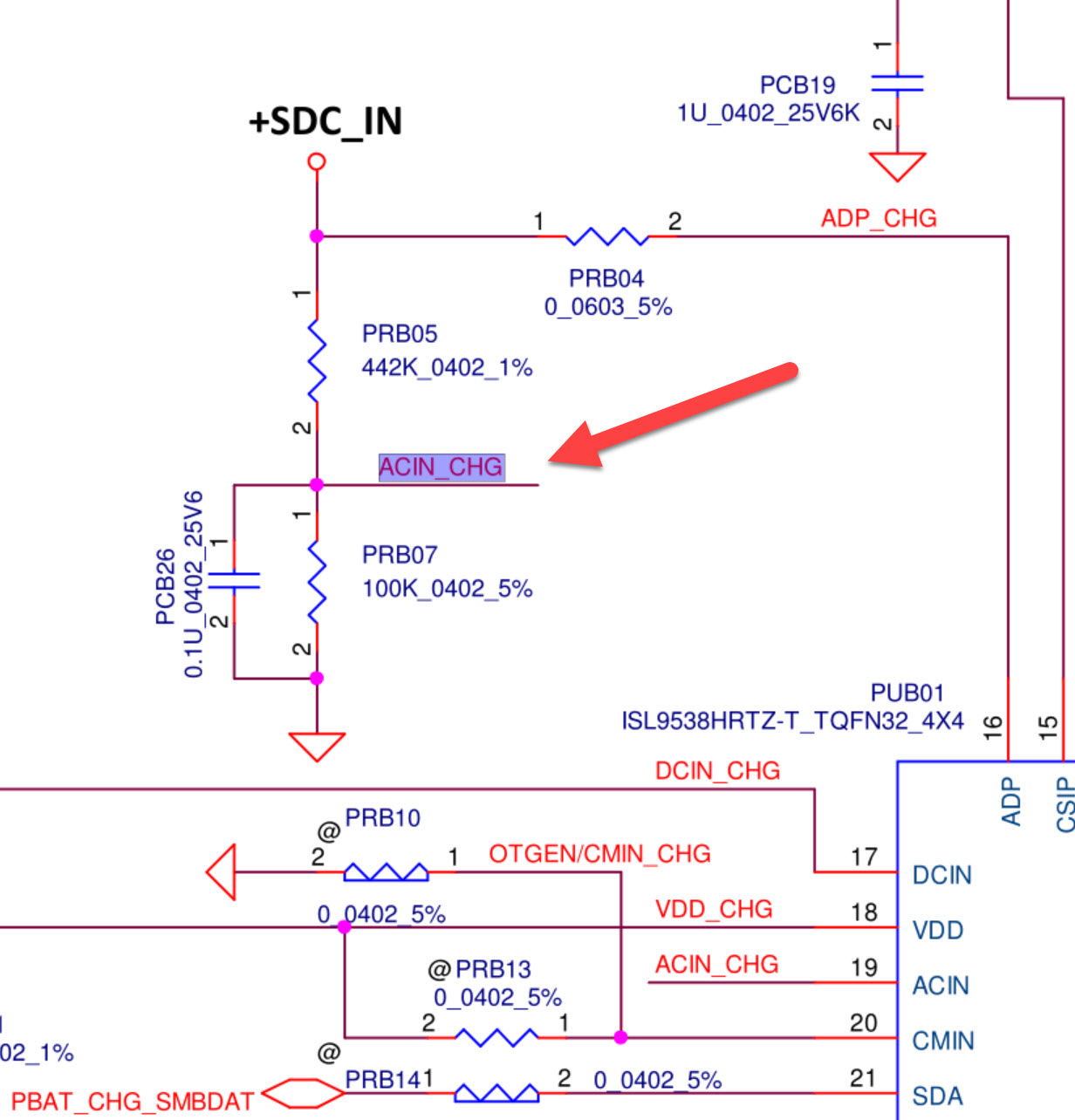

    Hi all, I am working on this Dell 15 5570 ( Motherboard LA-F115P). The problem was battery not charging but it was working on AC power with Original Power adapter. Upon diagnosing, no PSID. Found that PD1 (Double Zener Diode Package) blown. Replaced it with another one. Now whenI turn on the motherboard with the ON/OFF switch , only then I get PSID 3.3V & works fine with the AC power adapter, but in the BIOS setup it say "AC Adapter Not Installed" & battery does not charge at all. I am using the Original Power adapter. I am listing pin voltages of the ISL9538HRTZ. Hope someone can help please, Thank you
    PSID = 3.3V only with power switch is turned on. In Standby mode, no Volts
    The voltage below are all in Standby Mode.
    ADP = 19.58V (Pin 16)
    DCIN = = 19.28 (Pin 17)
    VDD = 5.1V (Pin 18)
    ACIN = = 3.7V (Pin 19)
    ACOK = 3.0V (Pin 24)
    CSIP = 19.58V (Pin 15)
    CSIN = 19.58V (Pin 14)

                        • lapfix
                          • Mar 2020
                          • 2764
                          • my workshop
                          Re: No AC Adapter installed Dell 15 5570 LA-F115P

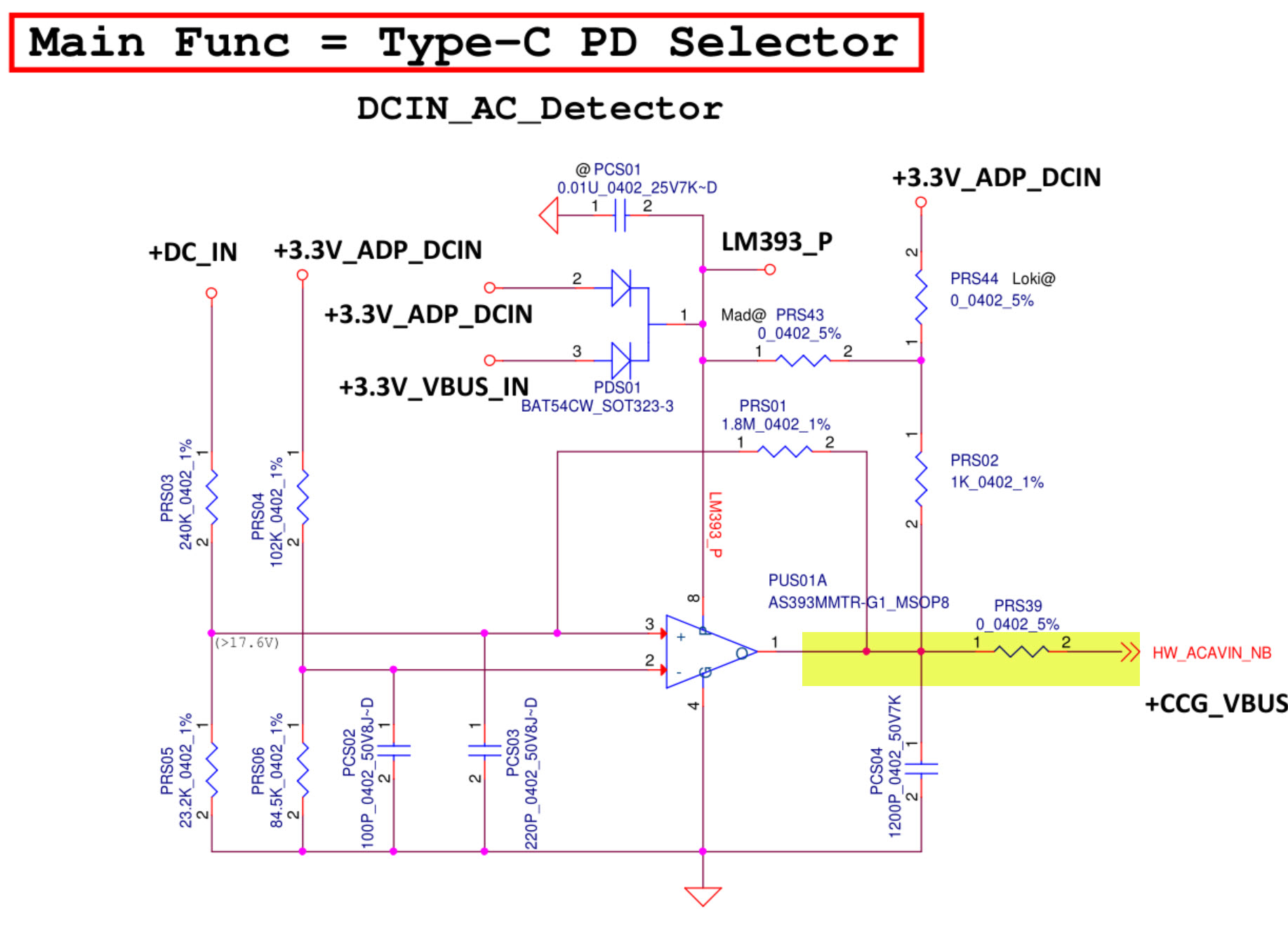

                            • mon2
                              • Dec 2019
                              • 14677
                              Check the output of this comparator. What is the voltage to ground
                              a) with adapter ?
                              b) without adapter but using battery ?
                              c) ACIN_CHG pin ? Built from the resistor based voltage divider.

                                  @mon2, from OP's post#1, its mentioned pin19 at 3.7V and thats correct.

                                      • reformatt
                                        • Feb 2020
                                        • 1510
                                        Originally posted by mferna14
                                        Will do so, thanks mon2.... really appreciate your help. I had another notebook of this kind but not the same motherboard. PSID should be present the moment we plug in the AC power adapter jack in standby state., & not in the laptop ON status. So this this case 3.3V does not appear on PSID in Standby state, it only has the PSID 3.3v when I turn on the laptop. Here is the really cause of my problem!
                                        I'd say so. Refer to pg3 of the schematic, +3VALW will be present in S4/S5 power states unless an AC Adaptor is installed. So if this is missing in standby, the indicates that there is something wrong the adaptor sensing logic. Any data from the PS_ID circuit is irrelevant in this case.
                                        Destruction of the diode for PSID indicates the charger plug probably collapsed (shorting 19V onto the PSID line). Other damage around the input may have occurred potentially, so I'd be looking closely around PQ3/PQ4, AC_OK (PR13/15 should be around 2V or so). PWR_SELECT indicates which adaptor is in use, should be high for barrel, low for USB C. Gives you an avenue to investigate.
