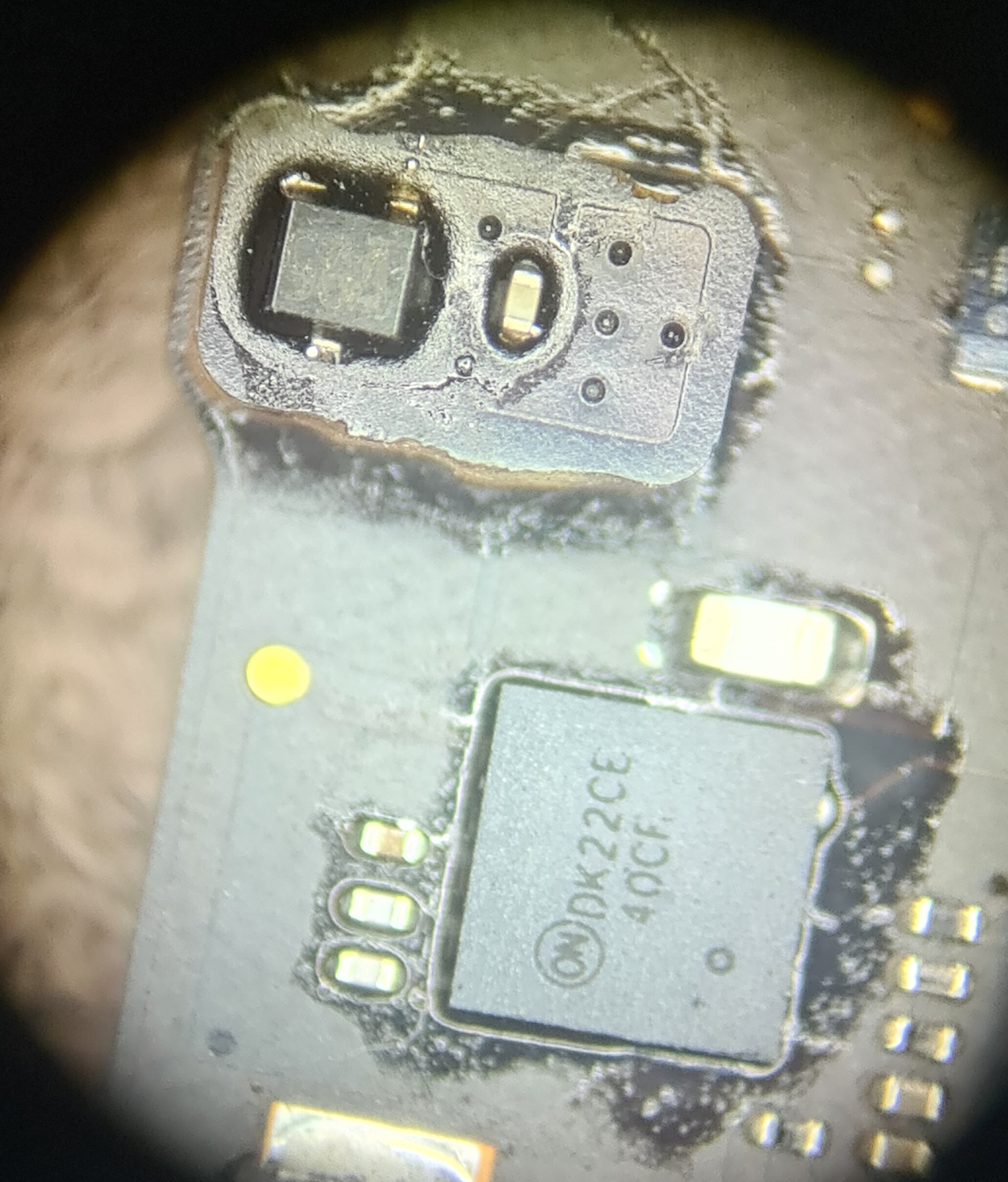

    Hello, I received an A1990, which is said to have simply switched off during operation and no longer started. Nothing is said to have been done to the logic board. But I have now seen that the Q3100 and Q3200 have been blown or swapped! The MacBook starts normally but does not load! So if the battery is empty it won't start anymore!

    Look Picture

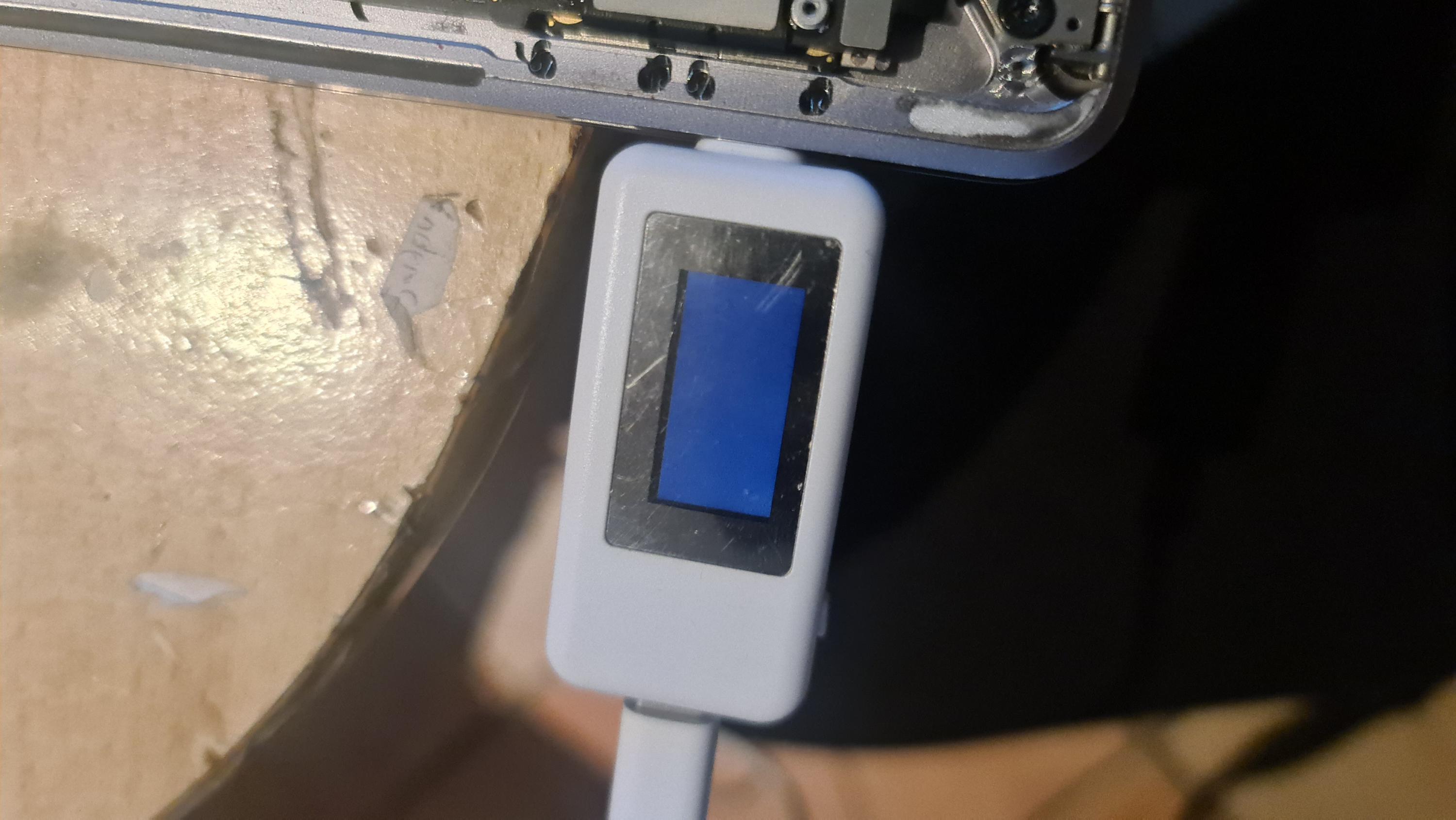

        The Mac will not load.During the first test I had 5V and 1.8 amps but now nothing is displayed on the USB-C connector.
        I think Q3200 and Q3100 are damage

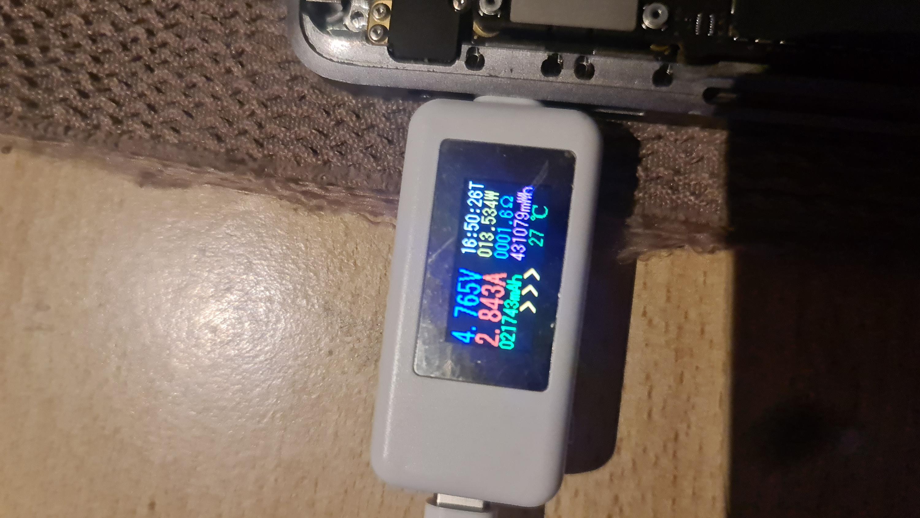

          I swapped Q3100 and Q3200. Then the 4.765V and 2.843A showed up and then it went out and nothing shows up anymore. only sometimes a slight light.

            Check the fuses that are on the same rails.
            It is possible that these dual mosfets are defective but check the fuses first @ F3000 & F3001.

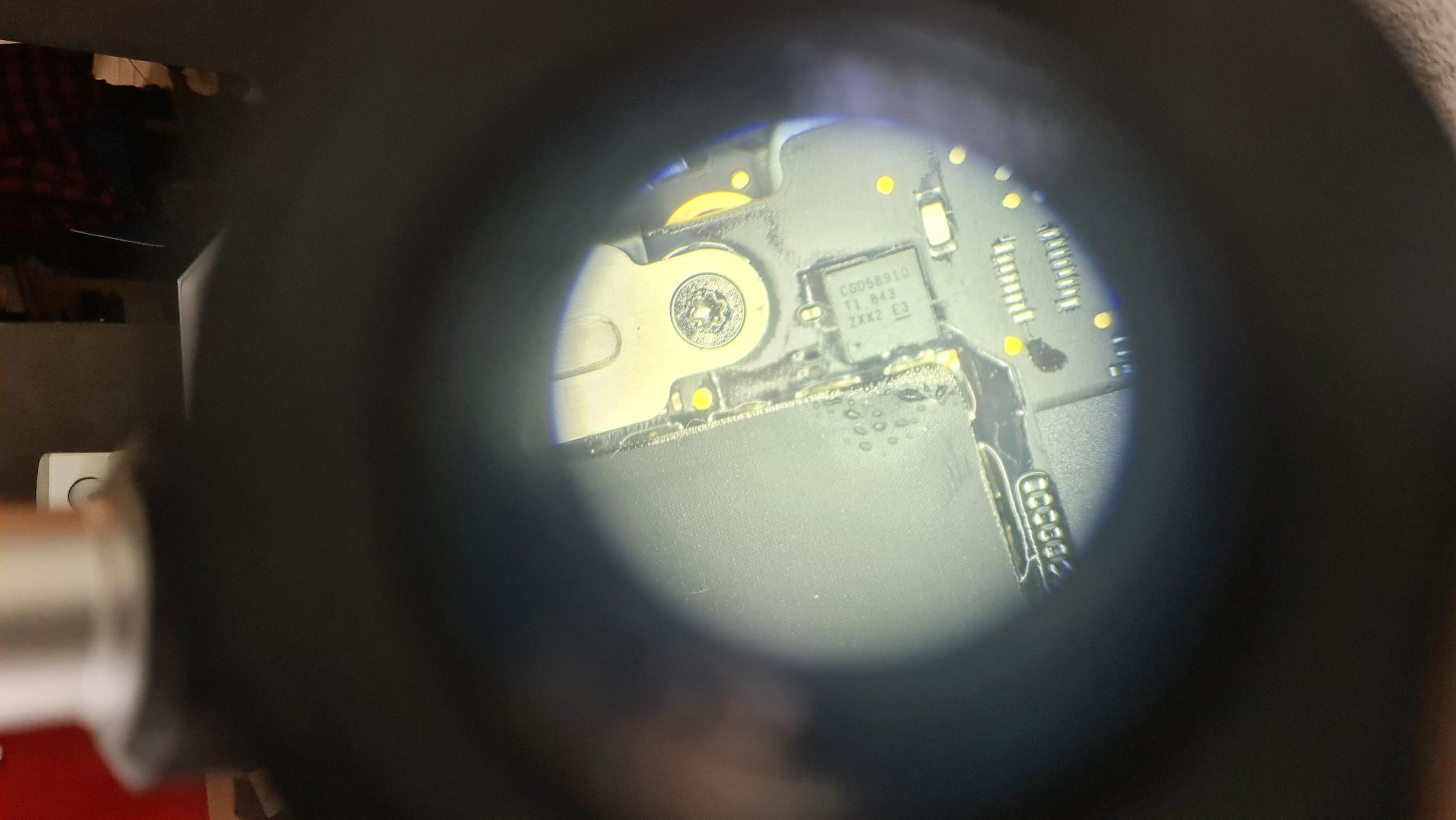

                  Whether the CD3215A has anything to do with it?

                    Check the voltage readings of the smbus lines on the battery connector. These are the SCL and SDA pins.
