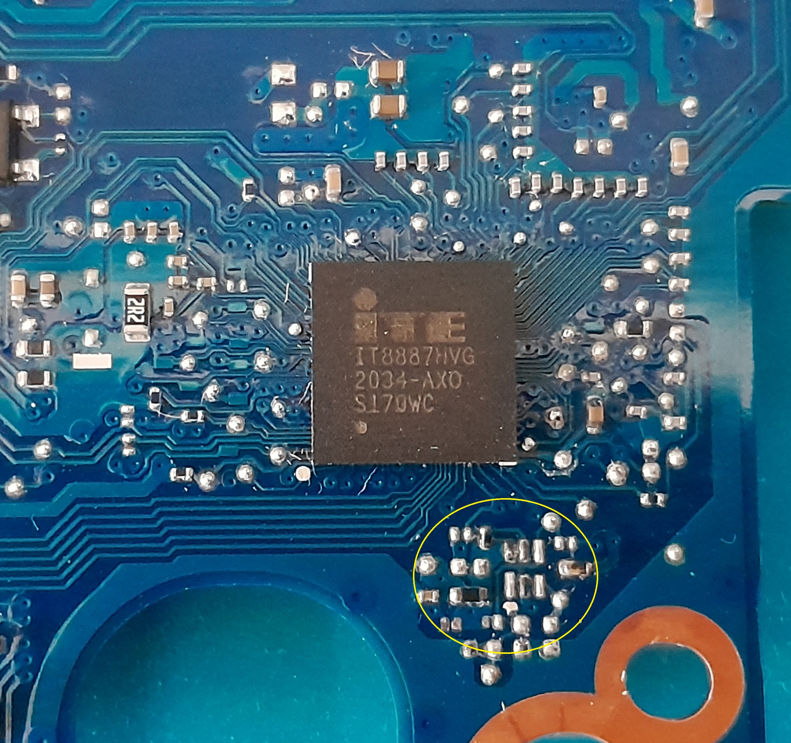

    I have this HP with liquid damage but can't find any schematics or boardview. Circled components seem suspicious.
    Any measurements of voltage and resistance would be helpful and greatly appreciated.
    Thank you in advance.

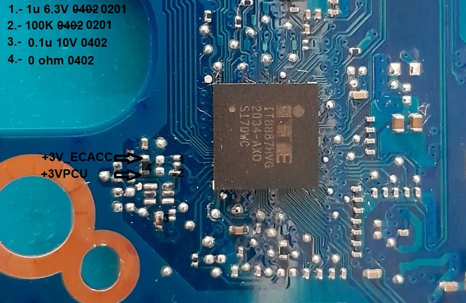

    Re: Help to identify components HP Stream 11-ak0020nr
    I'll reply myself.
    Hope this help others.
