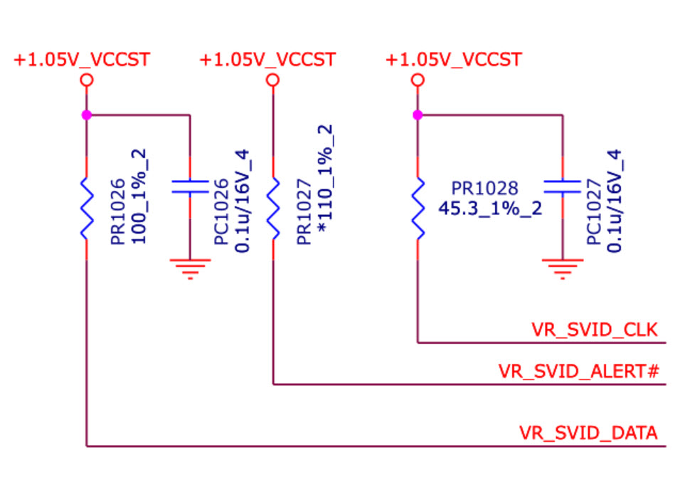

    Hi everyone! Asus FX506LH turns on with leds on and charges the battery correctly 1.05v 1.2v 1.8v 3.3v and 5v lines are correct but with a black screen.
    Voltages and resistances to ground as follows:
    VCC_Core 0.V 1.8 Ω
    VCC_GFX 0.v 5.5 Ω
    VCCSA 1.05v 17.5 Ω
    NVVDD 0.8v 0.7 Ω
    VCCIO 0.025v 2.7 Ω
    VCCIO should be 0.95v according to the schematic on the board. VCC_GFX 0v could be due to the GTX1650 being integrated into the motherboard. I don't understand that VCC_CORE is 0v. Any ideas. Thank you

    I have found that VR_SVID_DATA (SDA)=1.03v, VR_SVID_ALERT# (ALERT#)= 0.1v and VR_SVID_CLK (SCLK)=1.03v

      Re: Asus FX506LH Power on with black screen
      Appears to be normal for the SMBUS voltages.
        Oversimplified and normally ALERT# means no communication between the CPU and the VRM Controller (CPU not requesting voltage). Usually it's a bad CPU.

          Is it compatible with ALL_SYS_PWRGD=3.3v and if VCCIO=0.025v (nominal 0.95v)?
          also PCH-PWROK=3.3v and SYSPWROK=3.3v
            You should have vccio before vcore...
              Indeed. I'd double-check the value first. Maybe just a wrong measurements and if confirmed then maybe worth to troubleshoot from there.
