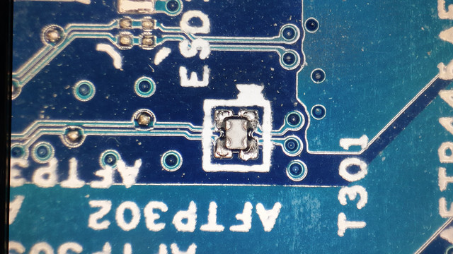

    Hello there i am beginner in repairing motherboards, i have a HP spectre x2 which had short circuit from bad USB port
    I noticed there is a blown up component with the motherboard marking t301:
    The image u see here(if it's visible) is from the same component from the other side of logic board (which is good)
    I do not have schematics nor are they available from internet after searching
    The resistance from pins on opposite sides are around 2 ohms
    I would like to know replacement for this part or if it's possible to use something else instead
    Thank u in advance

    Usually you´ll find a choke (CMM21T-900M-N for example) or a 0-Ohms resistor network on the data-lines of a USB-Ports.
    However, to troubleshoot the whole motherboard issue we need way more informations, voltages, resistances, and so on.

      That part number doesn't look anything like the one on picture tho. I am trying to figure out what part this is?

        It is as already suggested, an usb 2.0 emi choke.
        Can you carefully remove this part and share a pic of the pcb without the smd part? The part filters noise on the impedance controlled usb d+ and D- lines. Many parts can replace this one and is not technically required but cleans up the noise during transmission.
