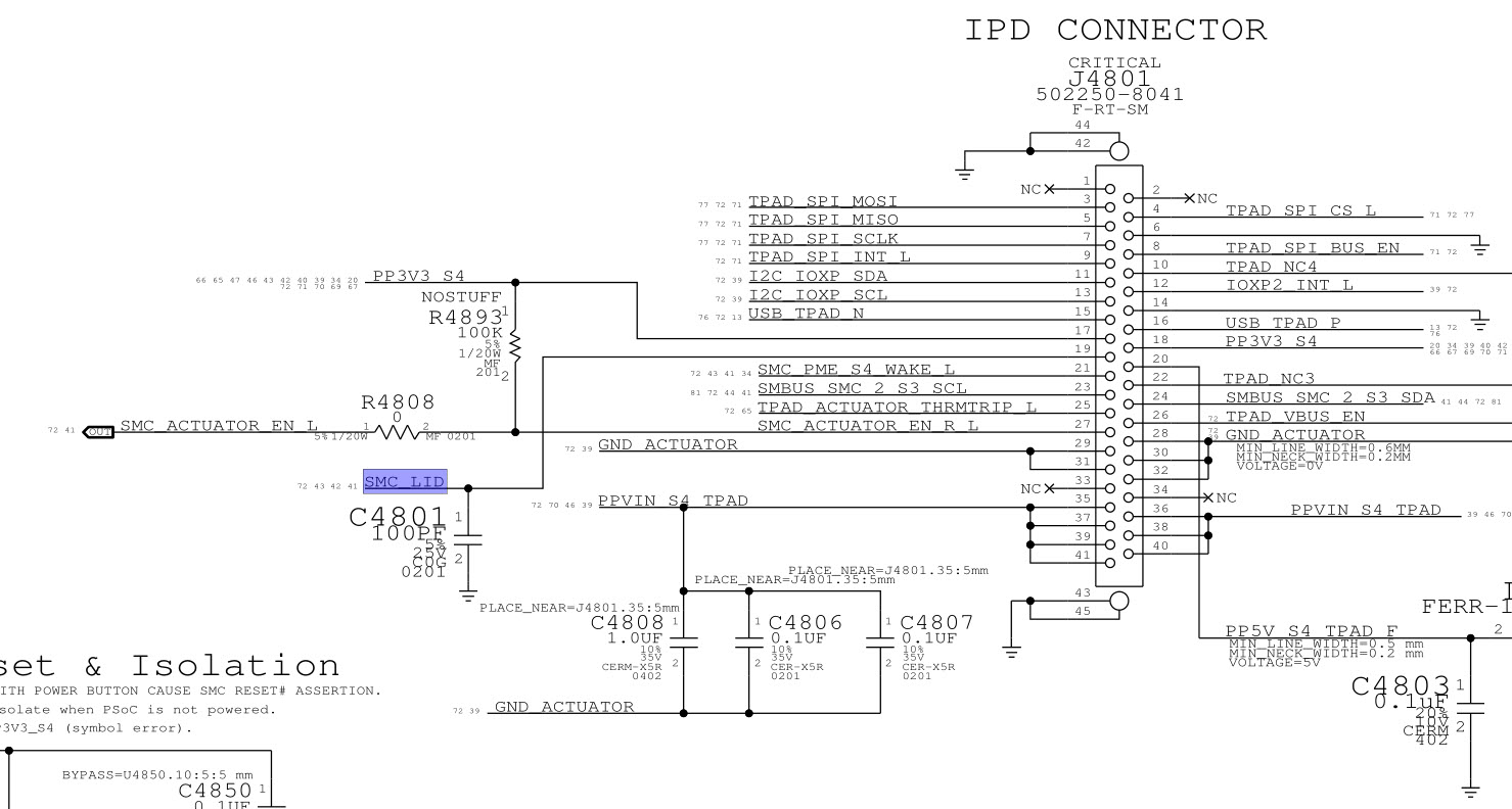

    Check the trackpad / SMC_LID voltage to ground when the lid is open. Remove the trackpad cable and test again.
      *Sorry for the lack of basic knowledge, I am still learning*
      When you say "voltage to ground", you mean red probe on the SMC_LID / trackpad test pad and black probe on ground while in voltage mode (and the macbook has power)?

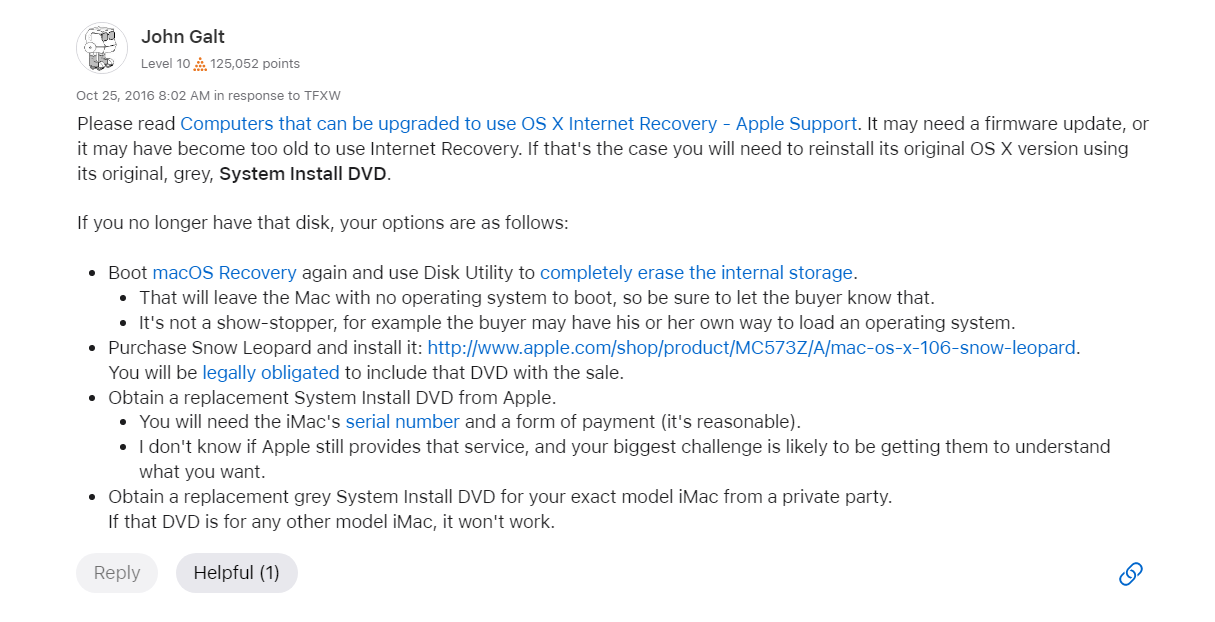

          Your internet connection may be faulty. Would you have a wired internet adapter that is compatible with the MAC world? Often the ones with the ASIX Ethernet controller are Plug & Play. That is recommended.
          If this approach is not working, review:
          https://discussions.apple.com/thread/7720550
          A good option is to try a bootable DVD from Apple.
