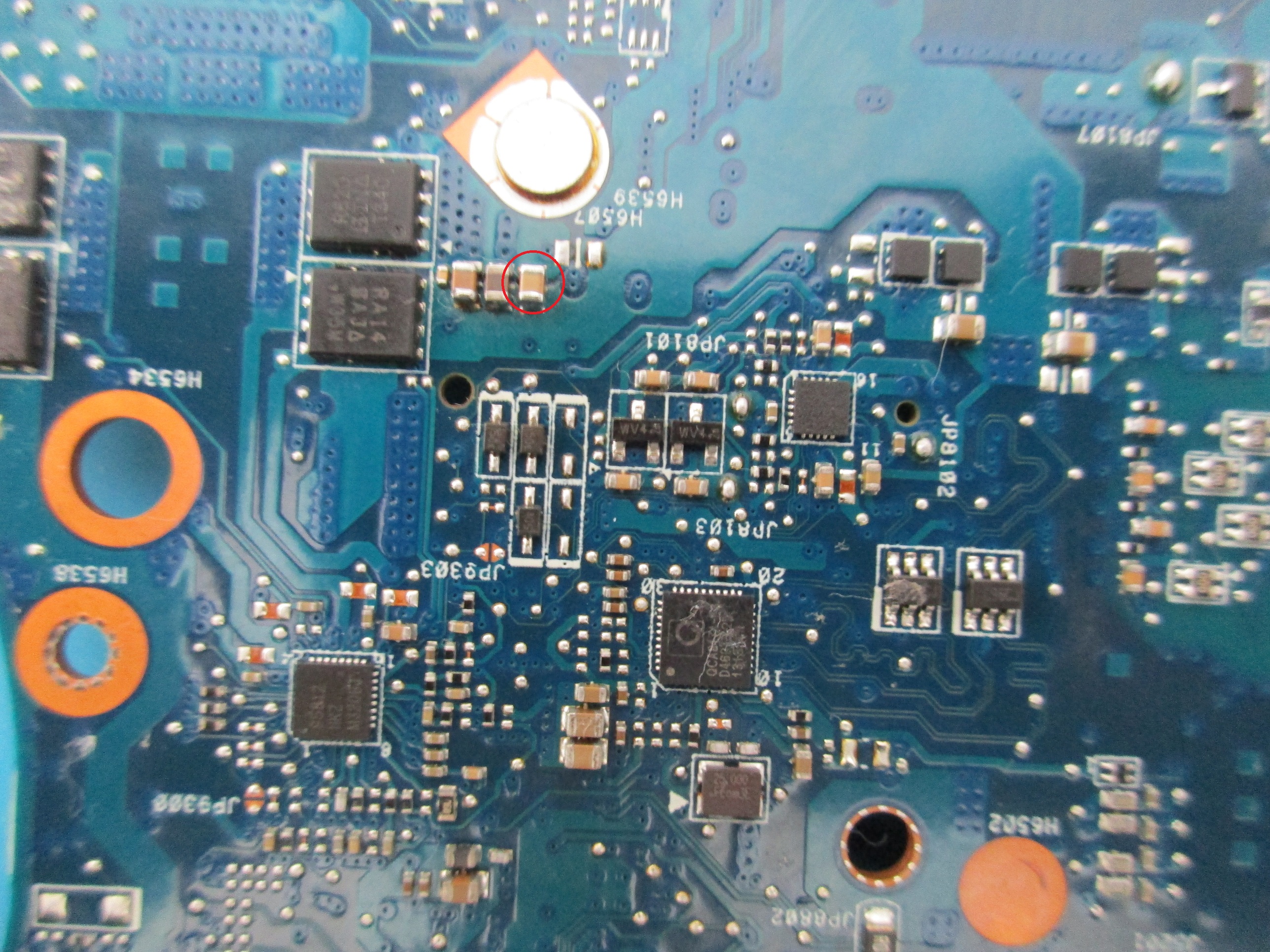

        I do feel the first power mosfet very hot, i've put some IPA on top of it and while is evaporating it's like pulsing the same way the charger light, I've replaced with a new one but the problem remains the same

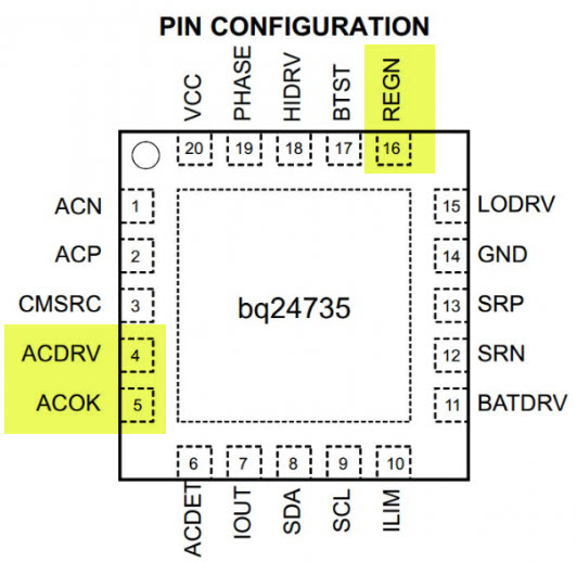

                      What IC is driving these 2 x DCin mosfets ? That will be the charger IC. Is it the BQ type? Post the topside markings from the charger IC.

                        Here's a pic, those to caps are shorted...

                          See attached. PS: TOPSIDE view.
                          With caution, measure the voltage of the highlighted pins of the charger IC.
                          Red meter probe to pin to test; black to ground.
                          REGN should be 6 volts.
                          ACDRV should be ~25 volts to enable the DCin mosfets. If not this value, power down and locate the ~4k resistor that is often mated to this pin and remove it. Do not lose the resistor but just remove it.
                          Then power up again and check if ACDRV is now ~25 volts.
                          • Kambi13
                            • Aug 2022
                            • 133
                            • Portugal
                            Re: Toshiba Satellite L50-A-122 Charger Light Pusling
                            ACDRV - 19,38v
                            ACOK - 1,019v
                            REGN - 6.03V
                            Without the 4k resistor ACDRV, as soon as I touch it with red probe reads 24v and immediately drops down to 19,38v

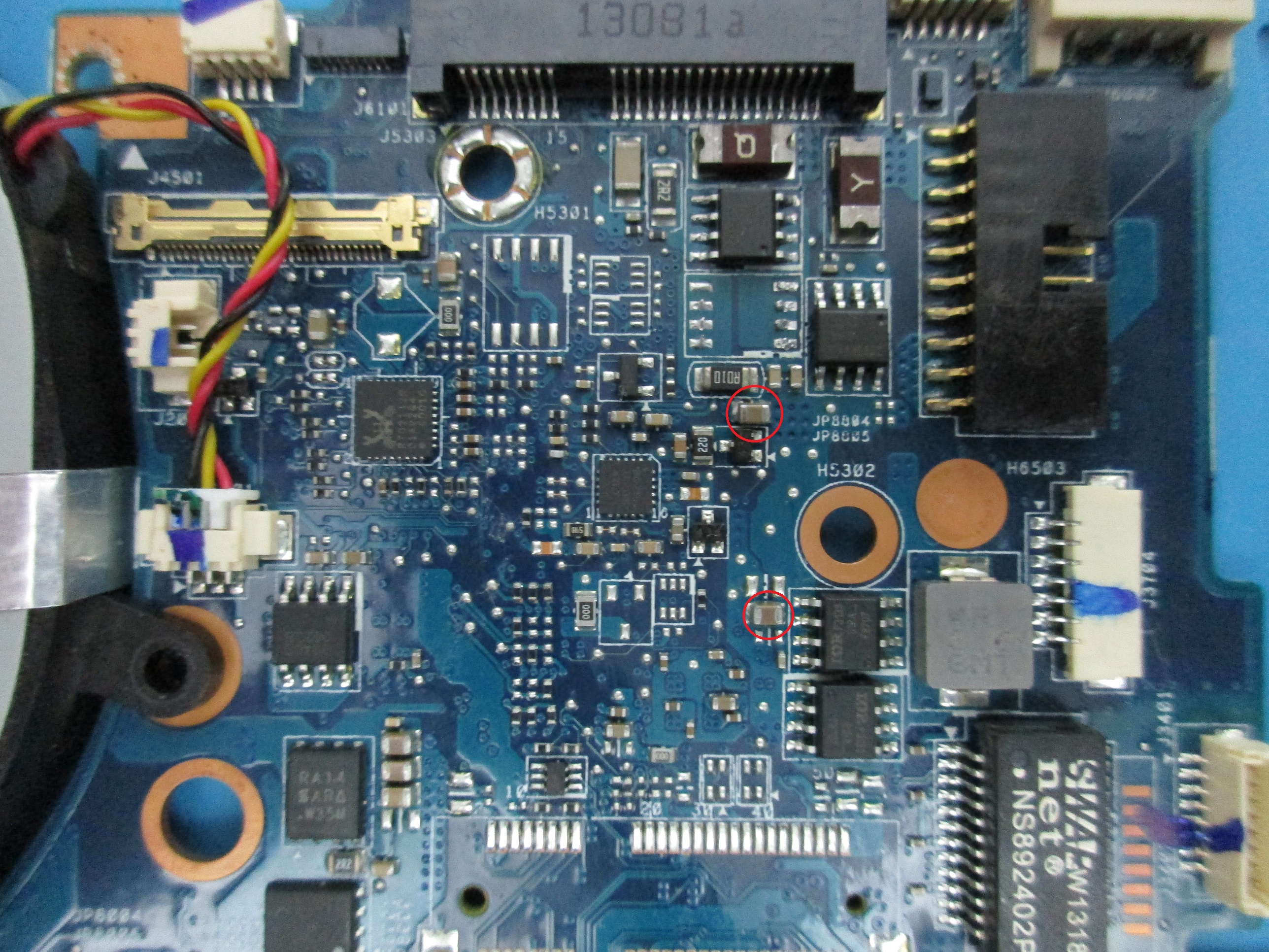

                                    Same readings. I took out the IC Charger, and i can still see those caps shorting to ground.
                                    After putting back the ic again same values
                                    • Kambi13
                                      • Aug 2022
                                      • 133
                                      • Portugal
                                      Hi mon2, good news I was able to find the problem, it was a SOB of a 10uf cap that was bad in back of motherboard.
