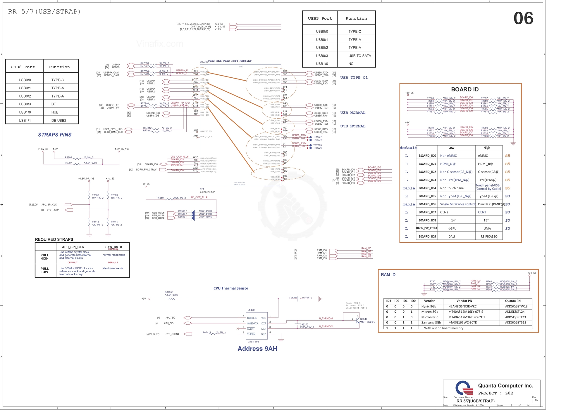

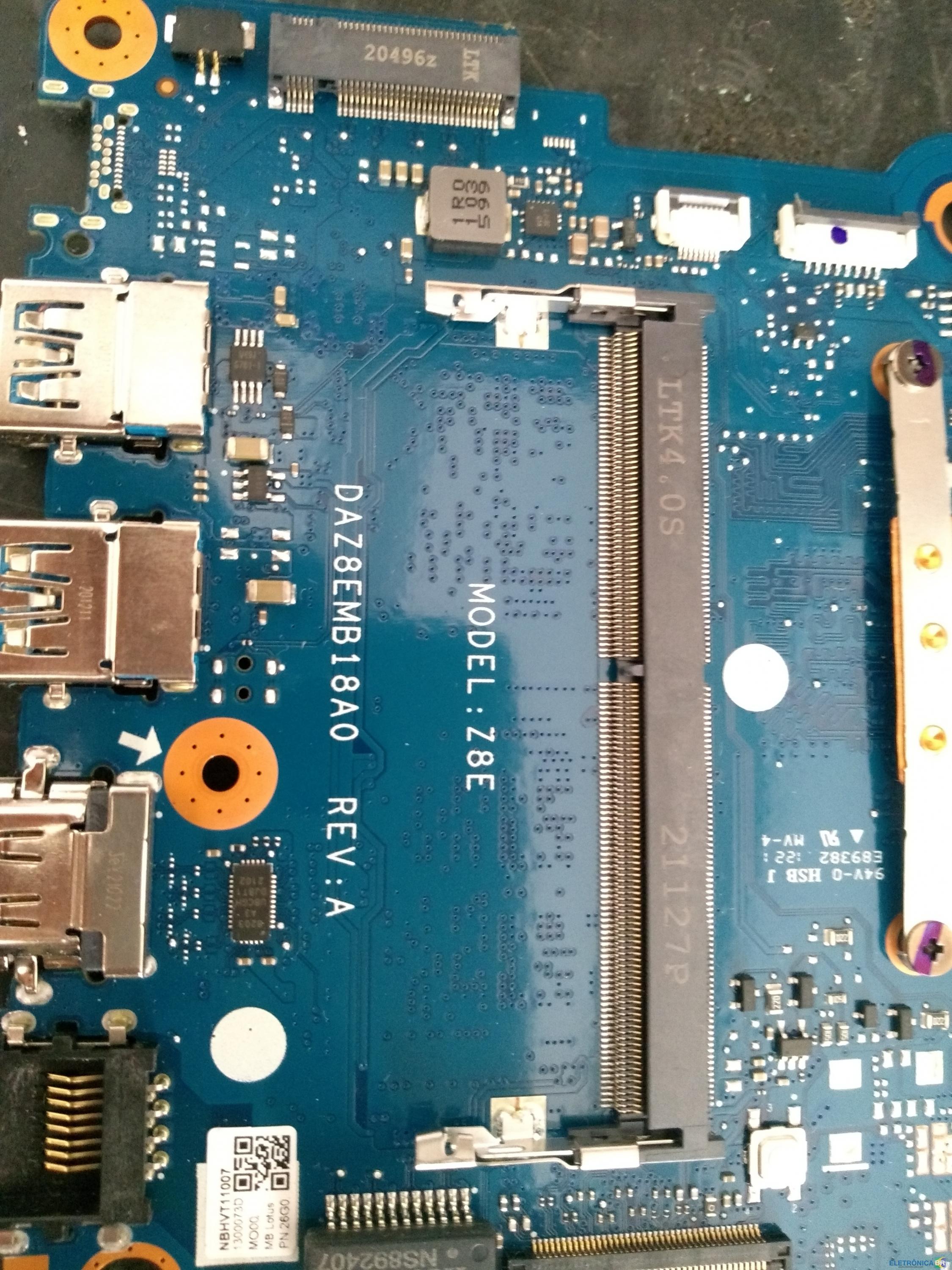

    Hello friends, how are you? I need your help again, I have an acer notebook (board - DAZ8EMB18A0) that does not post, after analyzing and finding the problem in the onboard memories, is there any way to disable this memory to start? I searched all over the web but I didn't find a way to do this, does anyone know how to help me with this procedure?

    Do you have schematic+boardview for this motherboard?? Without them its next to impossible to get the job done.

        ID0/ID1/ID2/ID3-all needs to be pulled to "1". Mention which ram you have onboard. The pic is not very clear. Post only the RAM ID box which can be viewed properly.

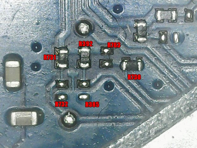

          You must remove R730 R385 R732 R376 if you have any of these resistors. You must have these resistors on your board R763 R392 R731 R389.

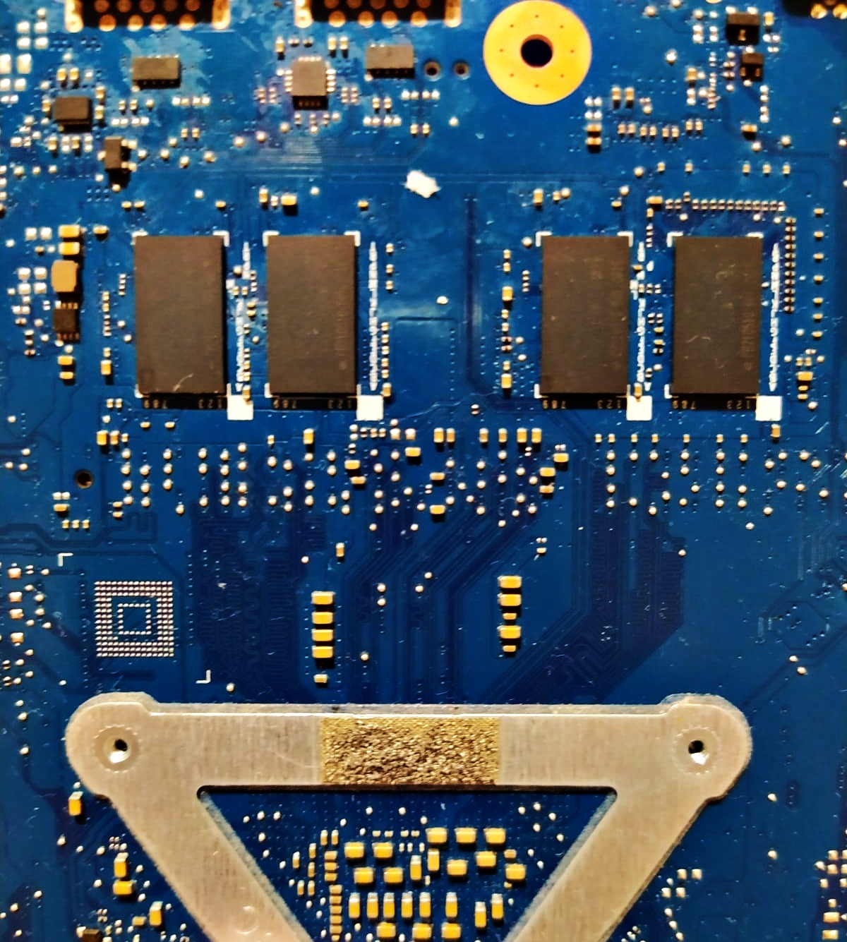

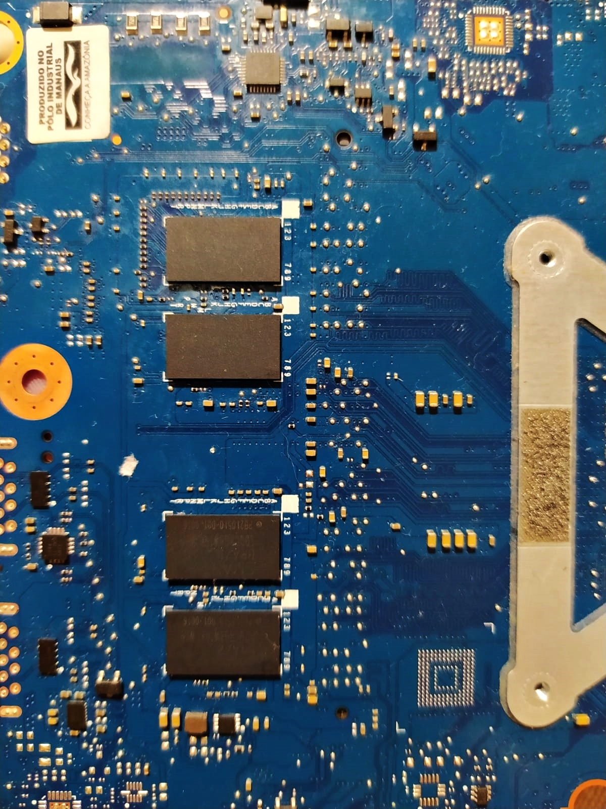

            hello friends, follow pictures of the memories on the board, which would be the resistors to remove?

              the memories have the serigraphy erased but they are SMART BRAZIL modules
              but i would like to disable them.

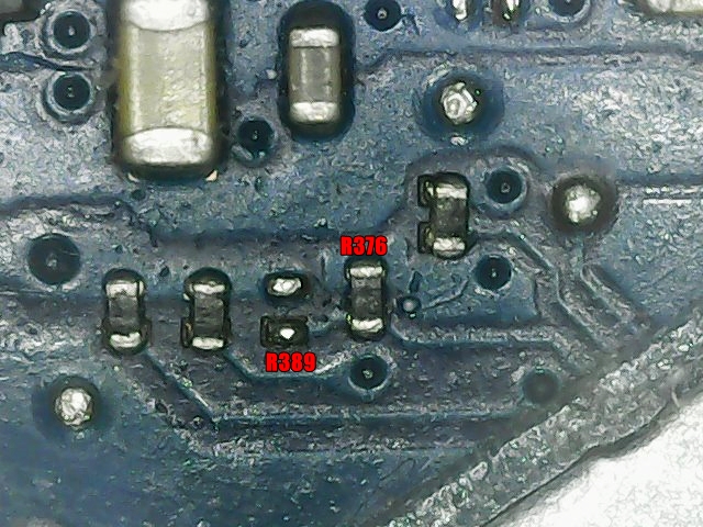

                      Hello friend! I got the boardview and also made some approximate images of the board, but I still don't know what the next step is, if it is to remove, change or add components?

                        Try shifting R376 to R389 & R730 to R763

                          Not very sure as "Smart Brazil" chip is not even listed in bios. Before shifting take close up photos so that you can revert back to original layout if doesnt works.

                            The original RAM has probably been replaced with the "smart" ones from an SO-DIMM and the SPD info hasn`t been edited into the bios.There`s no datasheet available for the ram , https://smartmodular.com.br/en/modulos-de-memoria-dram/
