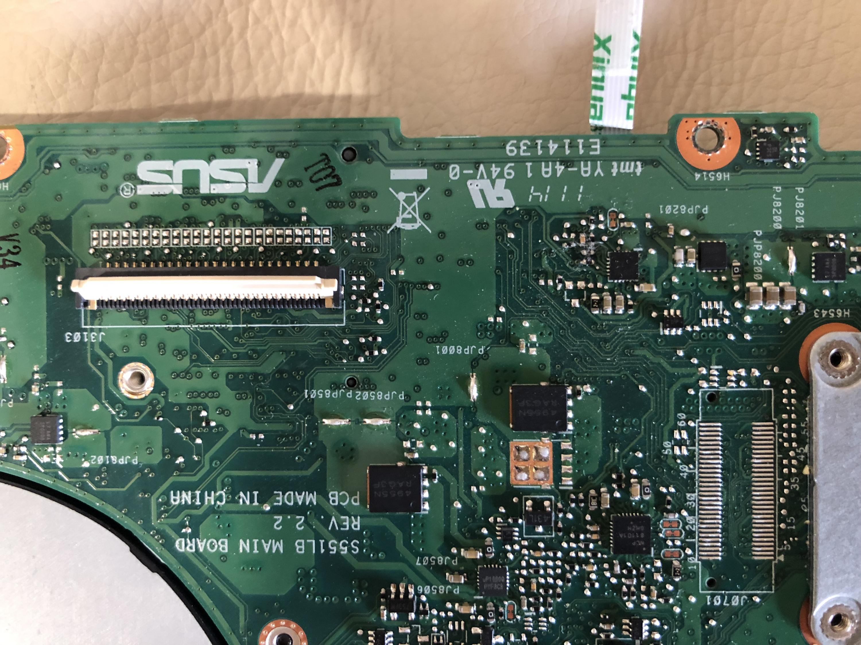

    I have a issue with asus A551L laptop.
    Lcd came black some time when I streaming a movie and the audio and backlight work. When lcd is black if I connect the laptop to external monitor I can see a correct image, it's work.
    Sometime after that screen became black, I can see a flickering white image.
    I captured a video showing the problem video
    Any idea?
    Thanks in advance.

    It flickers only on battery power or flickers on both adapter/battery?? Measure LVDS/EDP connector pin voltages.

      the problem is present with only the battery connected and when I connect the laptop with power supply. Today I connect it with power supply I get a only one black screen without flickering.
      Sorry I am a beginner, can you explain how check LVDS/EDP connector?

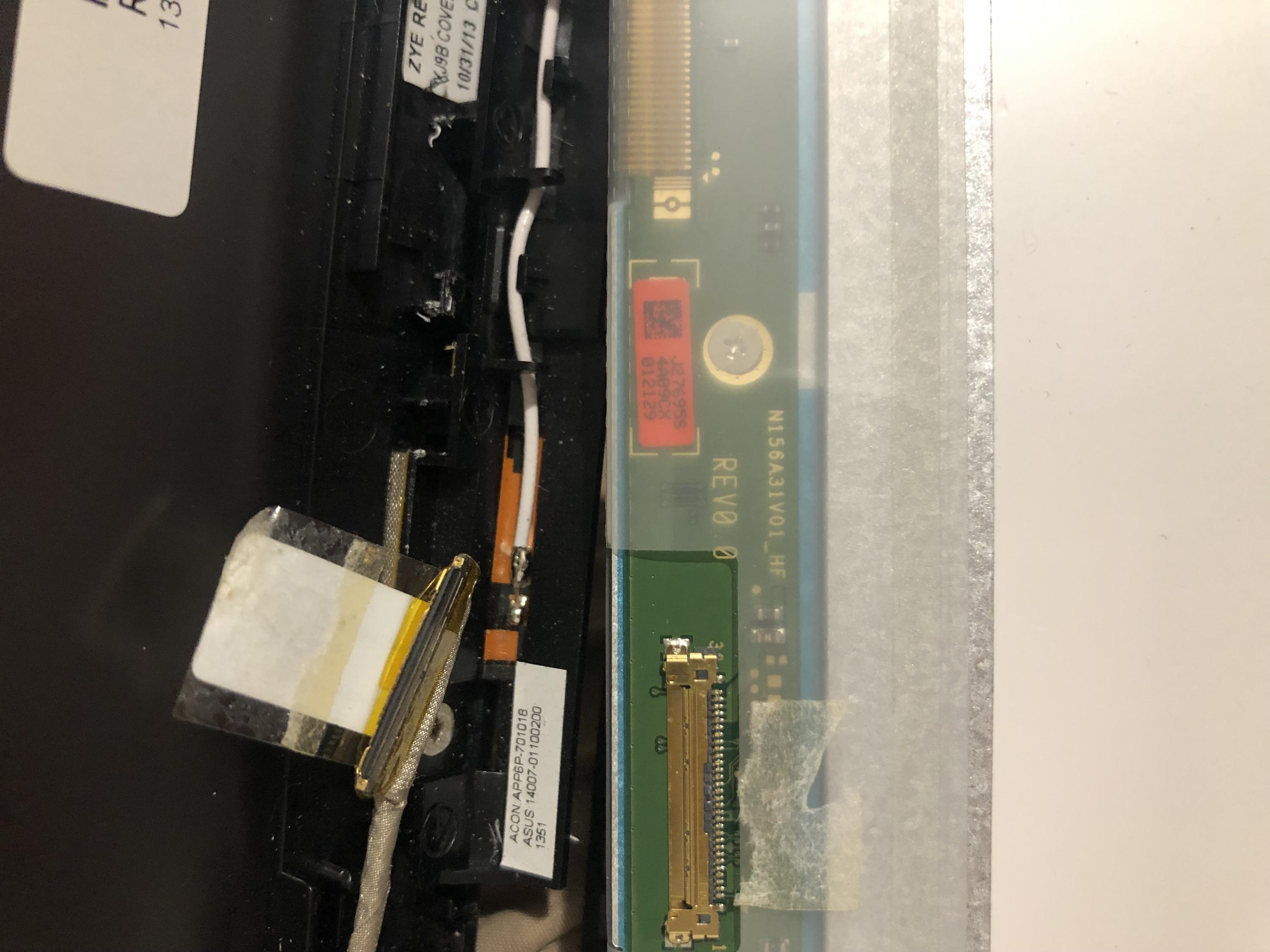

      Can you explain me how check the voltage on the connector. I just open the lcd. Should I check the voltage on pcb components connect to pins of lcd connector (red arrows in image attachment)? I don't know the pinout.

        There is a coil marked 100 on led logic card. Replace it with same coil from any other bad screen . This is a common fault with asus. This should fix screen flickering on battery only.
        Lets fix this part first. Then we can proceed further.
        Btw, have you tried another known good screen?? Attach boardview file ,if available.

          It has been several days since the last time the screen went black and flashed after I disassembled and removed the LCD cover and disconnected and reconnected the cable from the side of the screen several times. Could it be some contact on the cable?
          • mcplslg123
            • Jun 2015
            • 7262
            • india
            Re: A551L no signal and fickering
            Yes it can be.
