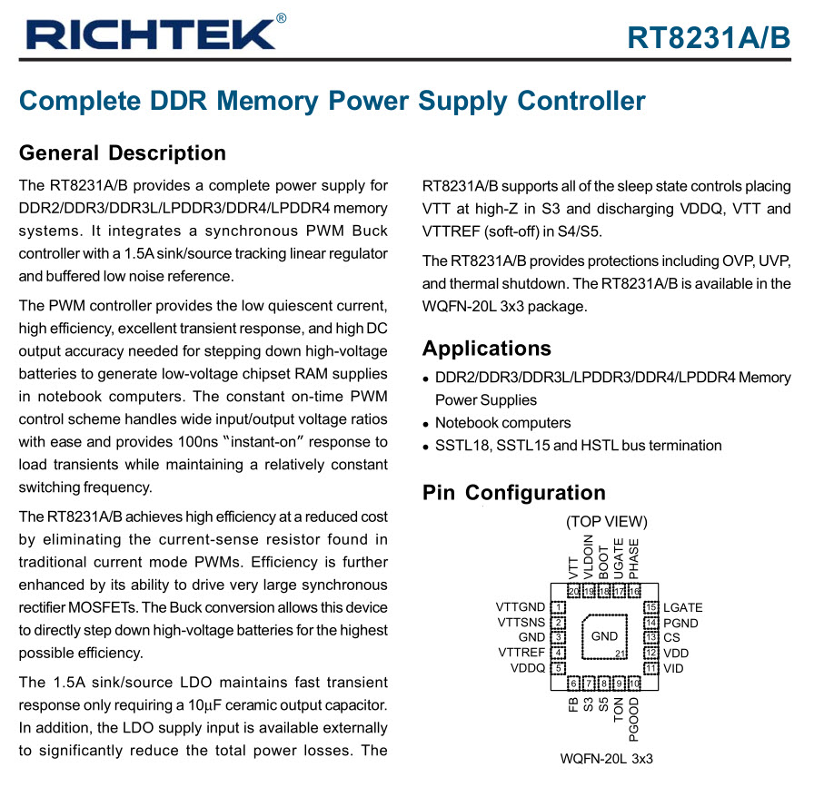

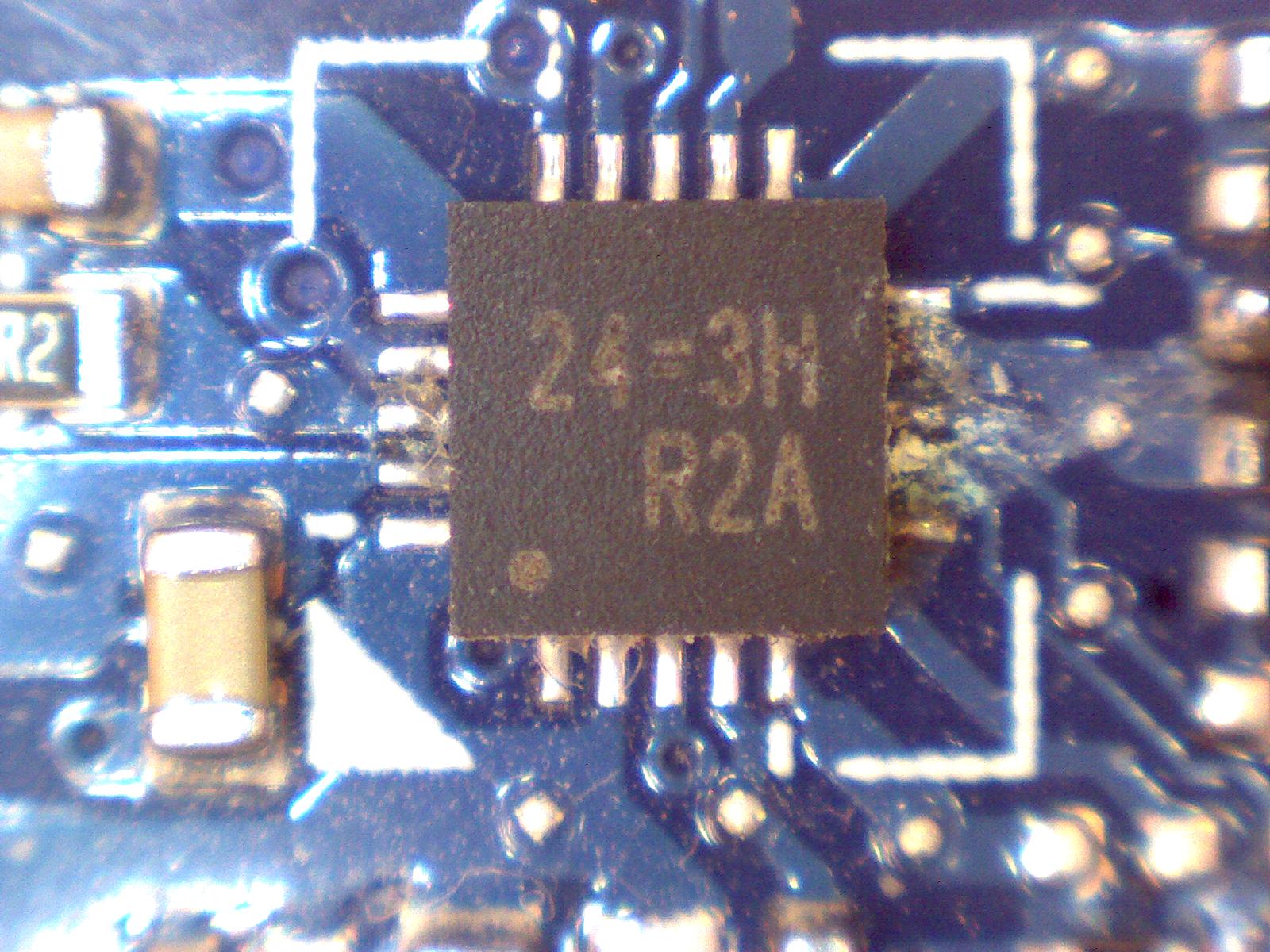

    notebook was water damaged, powercycled all two seconds.
    Found oxidation around RT8231AGQW IC, desoldered, cleaned, all pads are fine (on board and IC). found resistor on Pin 9 (TON) open, replaced it with 500k, now notebook stays on but delivers only 0.7V on RAM.
    How to properly check if the chip itself is fine or cause of the issue? Couldn't find any schematic either.
    Thanks a lot!
    BR, Ray

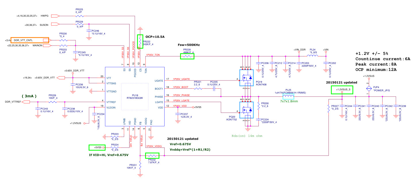

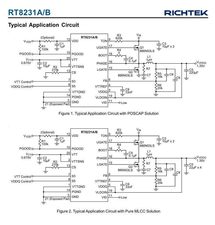

    Re: HP Pavilion x360 Brittle MB 15256-1 0.7V on RAM
    Study the other HP logic boards that use the 'B' (without tracking support) version of the same component.

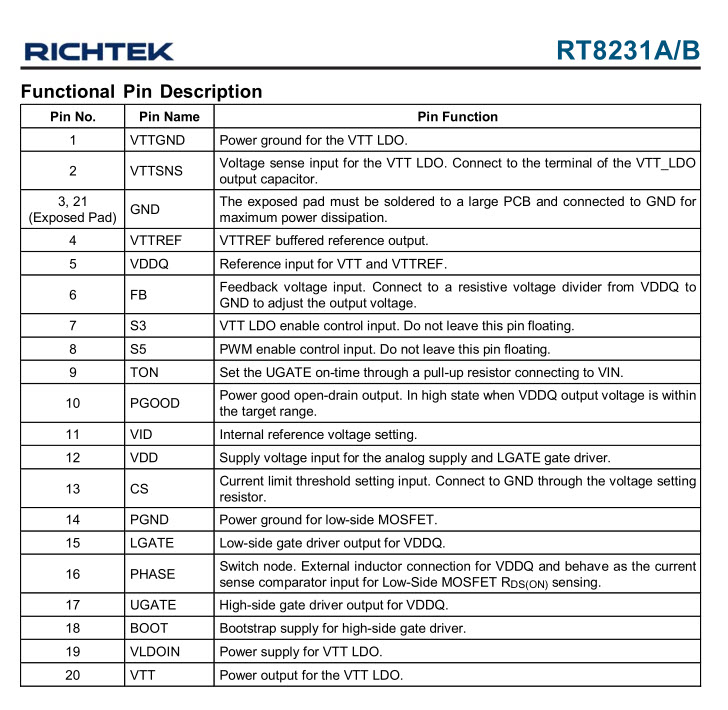

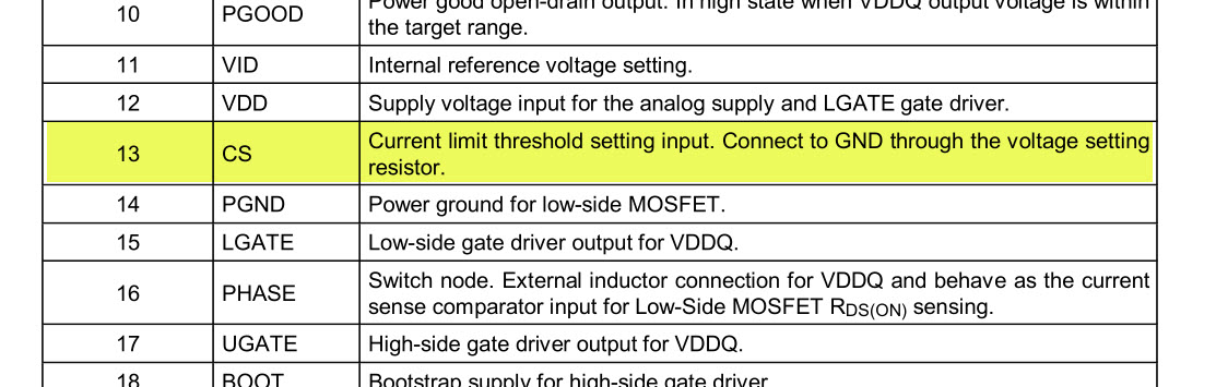

      "PR222" 243k on Pin 13 (CS) measures 434k on my board, rest seems normal.
      • mon2
        • Dec 2019
        • 14659
        Pin 13 defines the current limit which may be fine and is by design of this logic board.
