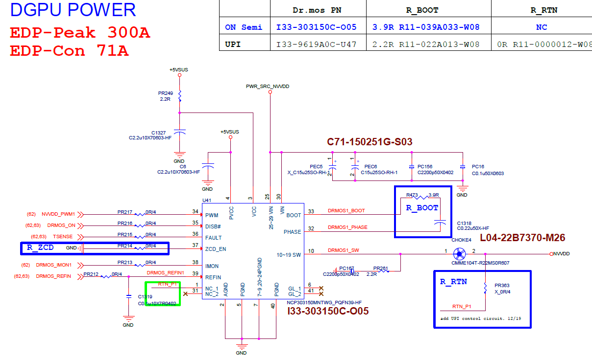

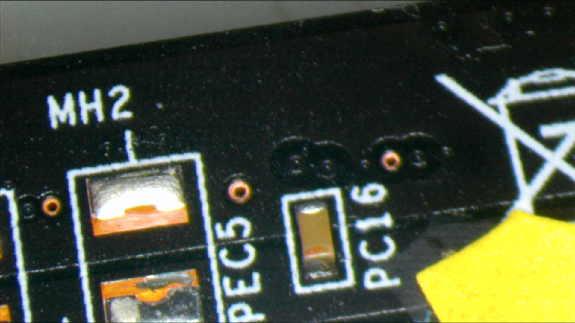

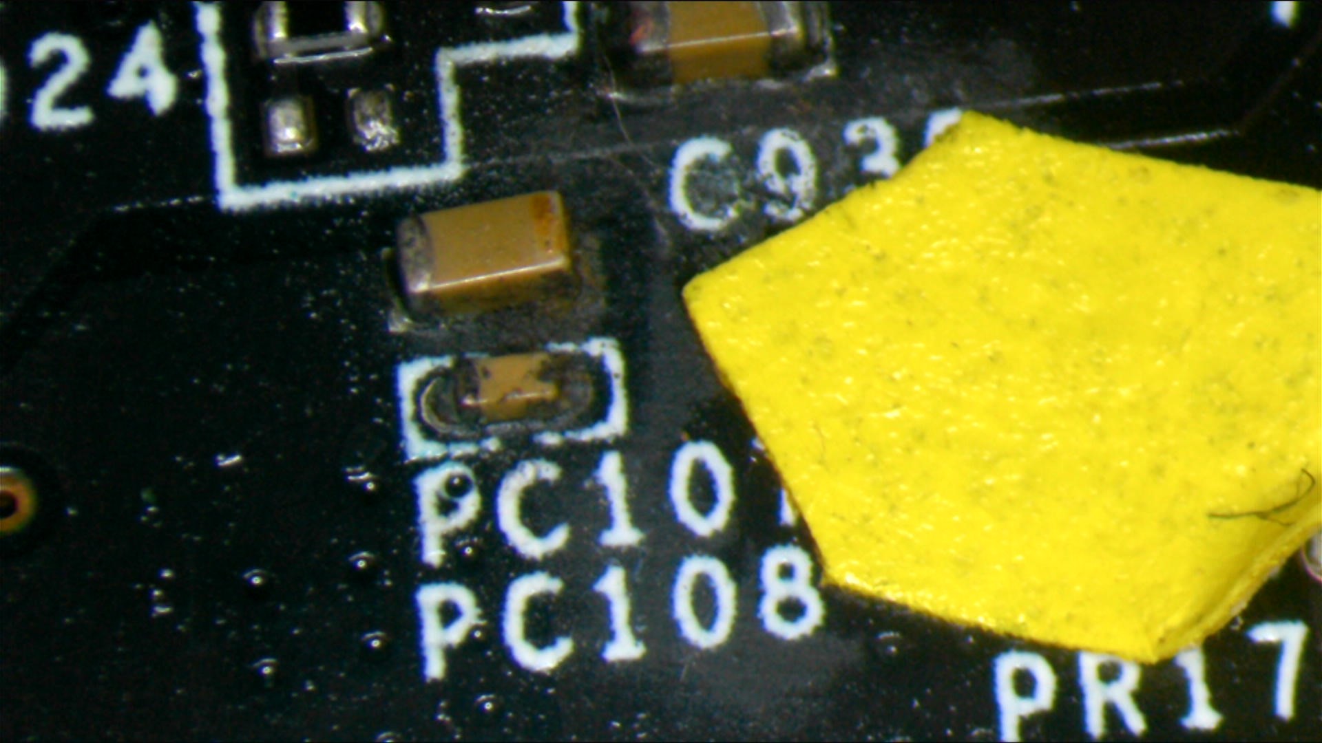

    I'm trying to identify these bad caps
    PC16
    PC107
    PC108

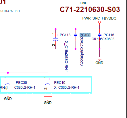

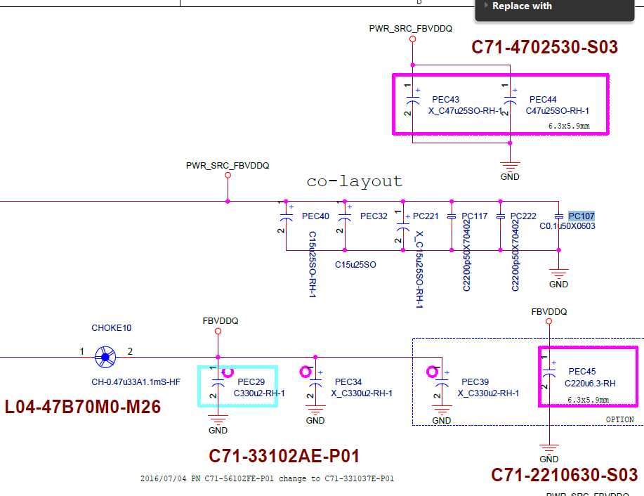

    Pc16 1uF 50v size 0603
    Pc108 2200 pF 50V size 0402
    Pc107 0,1uF 50v size 0603
    Regards
    Steve

      Re: MSI GL75 Leopard / MSI MS-17E5 Part identification
      Thanks for the reply I figured that much but I'm a noob figured I'd ask
      How do I know the tolerance?

        Where possible, purchase X7R or X5R dielectric version of the caps. This means the cap will not fluctuate much on the capacitance as the temp changes. They are just more stable over temp changes.
        For the 2200pf, purchase NP0 type. Each are very common.
        Best to select a voltage HIGHER than what you will use but best if you can use the same as the original part in the schematic. If in doubt, post the links of what you plan to buy.
        Tolerance is not critical for these components that are being referenced.
        You can buy the above parts from Digikey / Mouser / Arrow electronics for the best results. They will be original parts.

          It turns out PC116 & PC117 were also damaged luckily I ordered extra of both parts and it booted on my bench test with video
          Thank you I really appreciate it
