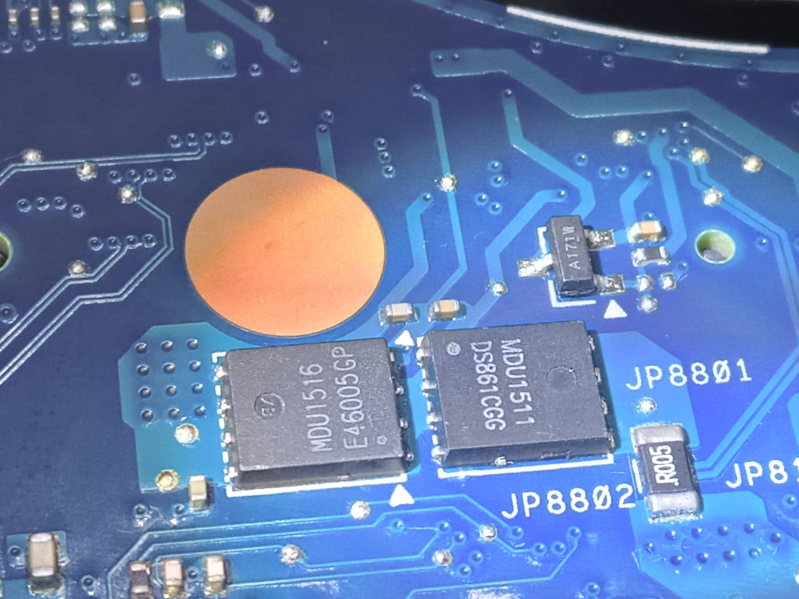

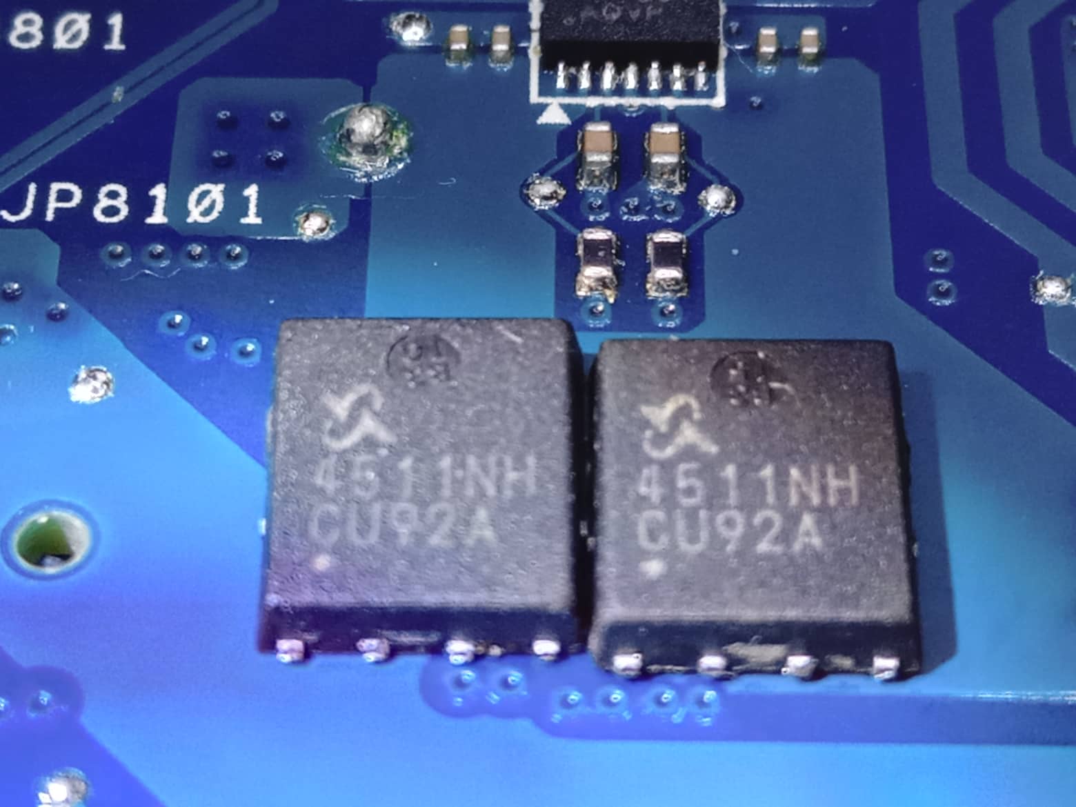

      i already replaced those two mosfets before posting here.
      original mosfets - 4511NH
      replaced with - MDU1516 and MDU1511
      got same unit but it uses AO6414A mosfet.

        The MDU and AO parts are N-channel (single) and appear to be fine for replacements.
        So far, unable to locate the datasheet for the 4511NH mosfet. Your logic board is 100% identical that uses the AO ?
        Check the voltage on each pin of each mosfet:
        source (1-2-3)
        gate (4)
        drain (5-6-7-8)
        with the adapter connected. Being N-channel, the gate voltage is expected to be ~25v to enable the respective mosfet.
        Update - forgot to ask - what is the charger IC on this logic board? It should be nearby. Perhaps the TI ('BQ') series ??

            @mdu1516:
            source - 19.85v
            gate - 24.92v
            drain - 19.85v
            @mdu1511:
            source - 19.84v
            gate - 24.93v
            drain - 19.84v
            it uses BQ24780s as charging IC.
