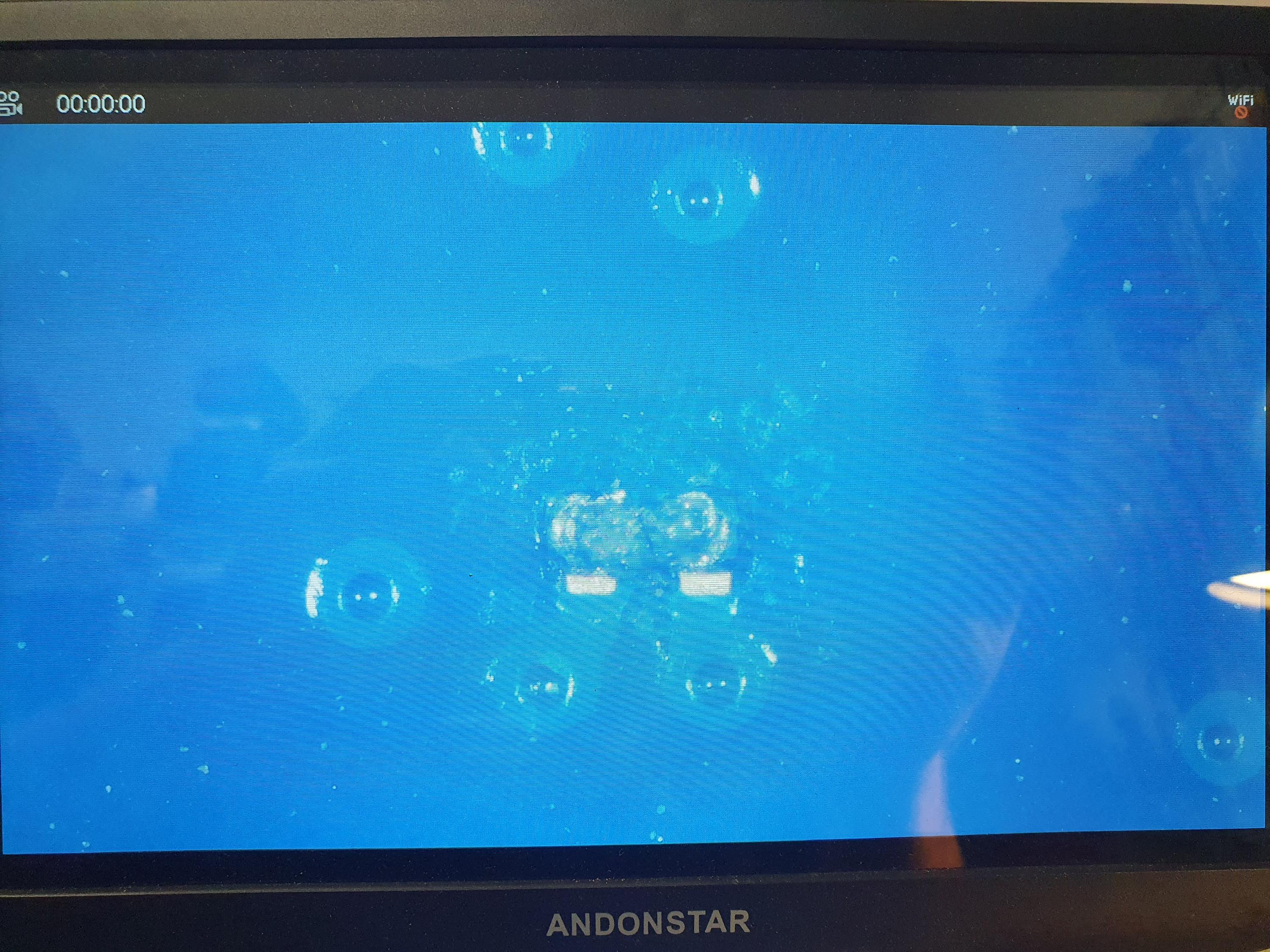

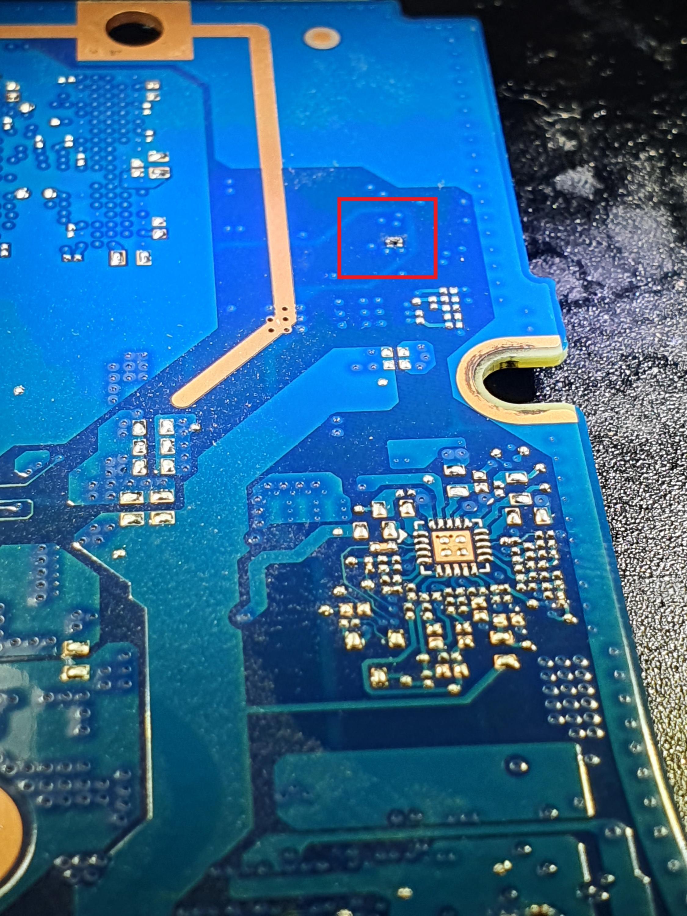

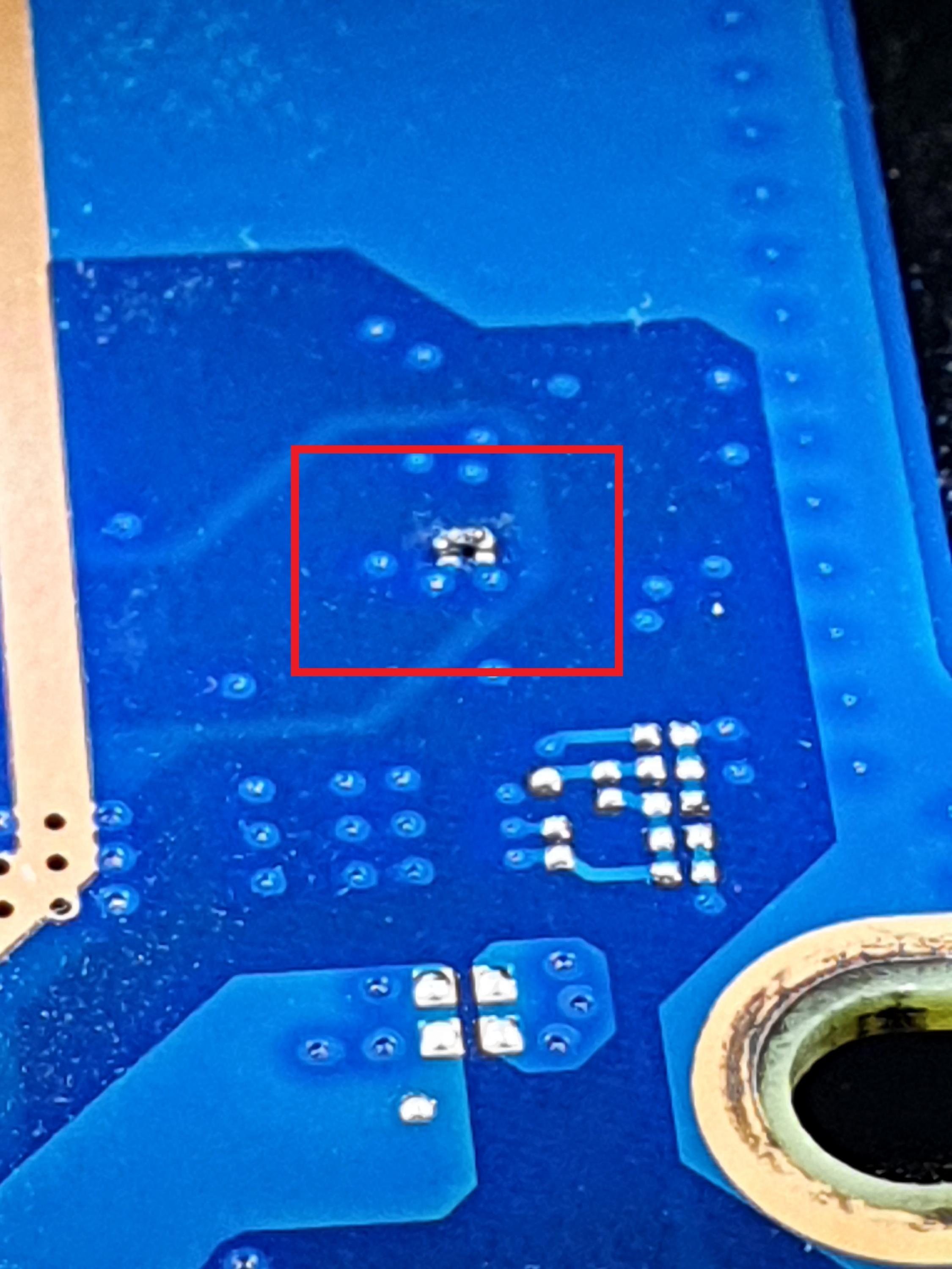

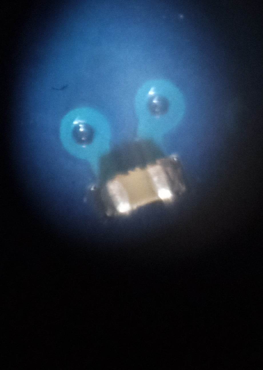

    I have a Samsung Galaxy Book for repair. The board number is Titan BA83-02466A, there is also another marking, NB3586/NB3587_PCB_MB_V5 REV:1.0. No boardview, no schematics.
    There is a completely obliterated 0201 component on the back of the board, please see images. I cannot even make out what it was. If somebody has the same board, please help me identify the component.
    One pin is ground, the other pin shows 6,8k ohms resistance to ground, the component is clearly broken in half.

      It's almost certain a shorted cap.
