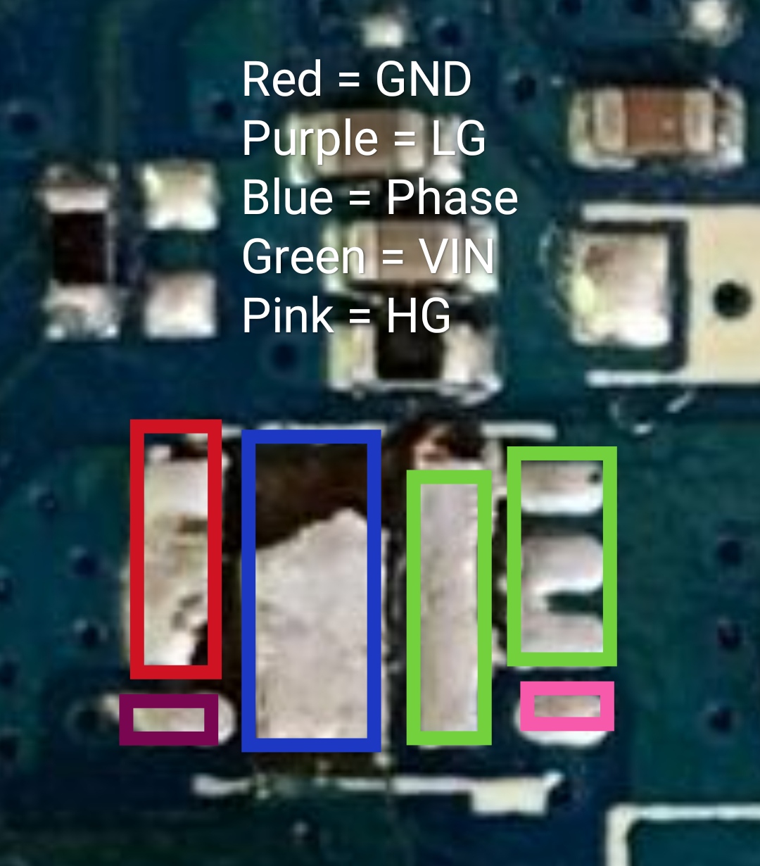

    Good afternoon. Help to identify the element on the platform LA-J662P (N18E), Stands under the designation PQ805, to the left of the throttle PL802. The pad is not at all like the pad for the transistor. In the position of PQ804 there is an ordinary N-channel 50A transistor, but the place of PQ805 is completely different. Couldn't find a diagram.

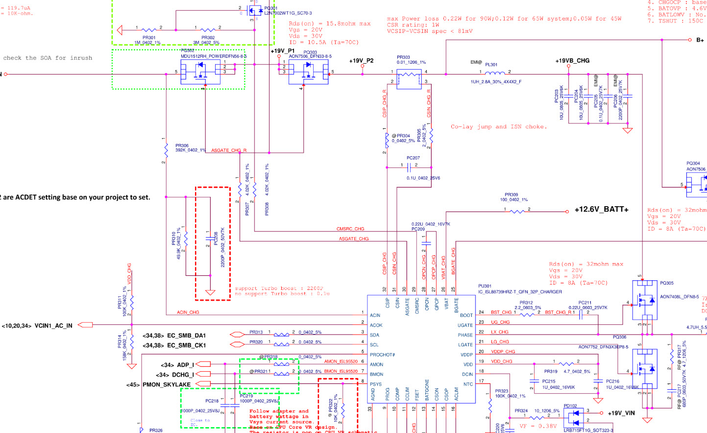

        The device will be a n-channel mosfet that is linked to the ISL88739 device to the left of this missing part.
        See attached ref ISL88739 schematic and review which mosfet is onboard your logic board. That is, this controller drives 2 x DCin mosfets.
        Found a ref schematic with AON7506 (Alpha Omega) and also MDU1512.
        If your missing part is the first mosfet, use the MDU1512. If it is the 2nd mosfet, use AON7506.
        Update - review the pin # 4 of the missing part = GATE. Then locate where this GATE pin ends up on the ISL88739. Then we will know exactly how this missing mosfet is being used on your logic board.

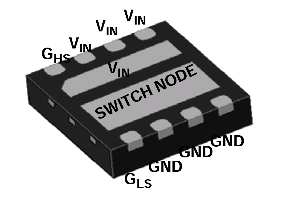

            Hi. From the grouped pcb pads, it is not possible to house dual mosfets inside this 8 pin package.
            • Sephir0th
              • Oct 2020
              • 1289
              Re: Recognize element LA-J662P (N18E)
              Indeed?
              Well, to me it looks like a pretty standard Dual-Mosfet layout. But who knows, maybe I'm just sharing bullsh*t...

                To me it looked like pins 5-6-7-8 are shorted but could be my fading 4 eyes. OP can confirm the details. I may have to forfeit the LG washer and dryer on this one.

                  Originally posted by Sephir0th
                  Indeed?
                  ou correctly noted everything. This is exactly how the contacts are located. I also think that Dual-Mosfet should be here. The center pin (Phase) goes to the charge choke PQ802.
                  But I don't see ISL88739 Dual-Mosfet on the diagram, maybe I'm not looking right?

                    The screenshot of the schematics shared here before was from a similar circuit, not exactly yours. So we have either to either find another DC-IN circuit with use of this Dual-Mosfet or maybe someone has experience from other boards using Dual-Mosfets for charging and can give a hint for a suitable replacement.

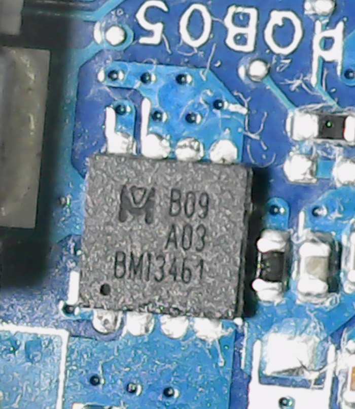

                      Hello , looks like got the same boad for repair ,PQB05 marking is B09A03 seems to be this one
                      EMB09N03G
                        • 21880
                        EMB09N03G
                        This one EMB09A03HP
