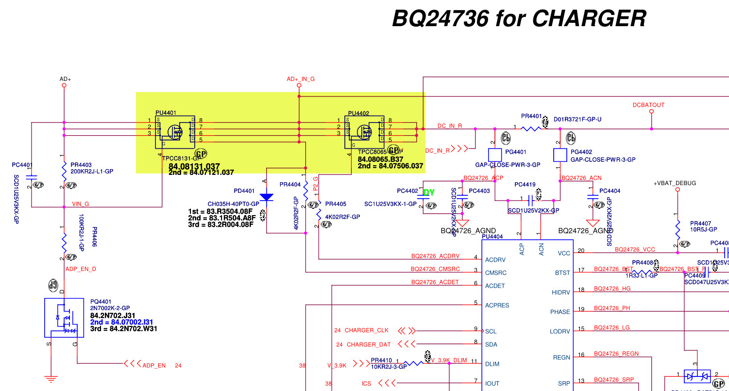

turn off mediately after power on model hp probook 450 G1
  • ALLEN martin
    • Aug 2022
    • tanzania
    i have thi issue is turn off mediately after power on model hp probook 450 G1
    rampage mb 12241 1
  • mon2
    • Dec 2019
    • 13955
    Re: turn off mediately after power on model hp probook 450 G1
    See attached.
    Review the first 2 x DCIN mosfets.
    First, remove all power. Then configure the meter in resistance mode.
    Confirm which pin is # 1 on the mosfet. It should be in the TOP LEFT corner.
    Pin # 2 will be immediately south of this pin -> 3 -> 4.
    Pins 1-2-3 will be shorted on the circuit board. Confirm it so you have a proper orientation of the component.
    Check:
    source (1-2-3) & drain (5-6-7-8)
    source (1-2-3) & gate (4)
    gate (4) & drain (5-6-7-8)
    Post the resistance values of the first mosfet. Repeat the test for the 2nd mosfet.
