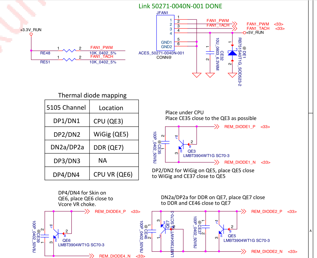

                Re: DELL Latitude 7280 does not start
                Review the voltage of FAN1_TACH when the fan is OFF. Then measure the voltage while the fan is ON - the voltage on FAN1_TACH should change.
                Pin # 3 of the FAN connector = FAN1_TACH feedback.
                Confirm it. Possible that the fan is defective - happens over time.
                  Can a defective tach circuit really stop the pc from boot ?
                  If I disconnect the fan it should not boot then. A test I can do.

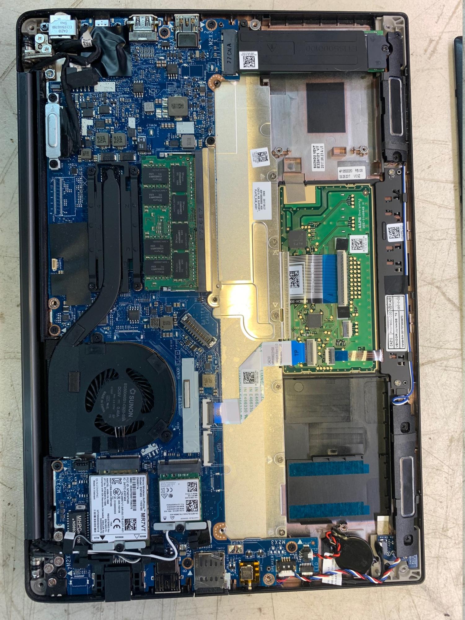

                                Good morning/afternoon Mon2
                                I am writing to get an expert opinion
                                Here is the problem:
                                - I have a dell latitude 7280
                                - by mistake yesterday I connect it to the wrong charger (both chargers with same pin plugs on the same power strip)
                                - the wrong charger is for my bike battery : output voltage 42VDC
                                - after that: computer runs slowly
                                - today : doesn’t start
                                - I had an old battery, I reinstall it
                                - computer restarts but runs slowly
                                - conclusion: PC runs only on batteries, but as batteries were very low charged, it runs low, and when fully discharged, stop.
                                The power with external AC charger should be burned somewhere.
                                the question which component ? How to diagnose ? How to repair ?
                                thanks for your highlighting
                                Geo
                                • mon2
                                  • Dec 2019
                                  • 14671

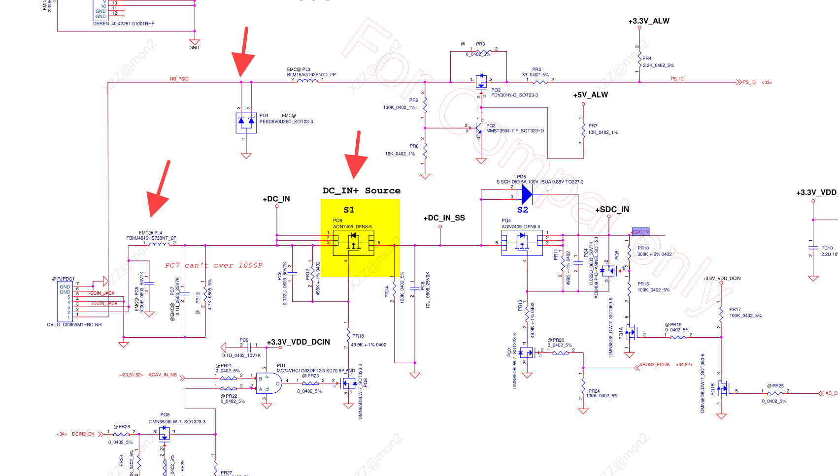

                                  Hi. Welcome. Ouch. < In this order >
                                  The 42vdc hit to the board is exceeding the rating of the DCin mosfets (act like solid state relays) so this is of concern.
                                  The fact that the logic board powers on using the pre-charged battery is a positive direction.
                                  The issue will be for sure with the PSID line which is a 1-wire communication line and it features a TVS diode that has a trigger voltage of 5 volts. Anything higher and the part will trigger.
                                  There may be an issue with the DCin mosfet @ PQ9 - AON7409. Aside from the debugging process, the parts are very inexpensive.
                                  Remove all power. Meter in resistance mode. Measure the resistance to ground of inductor @ PL3. Post pics of the DCin adapter area if not sure of the location of PL3.
                                  Also interested in some measurements of PQ9 mosfet. Post pics if not sure of PQ9.
                                  Requesting:
                                  source (1-2-3) & drain (5-6-7-8)
                                  source (1-2-3) & gate (4)
                                  gate (4) & drain (5-6-7-8)
                                  Post each measurement in ohms. From this review, we can confirm if PQ9 is defective or not. Each measurement should be hundreds of k ohms or higher if ok.

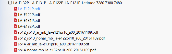

                                  Can you confirm which board you have in your box?
                                  See the list below.

                                    For the board type, need to check the exact model (where it is written ?)
                                    I believe I need to dismantle the board to check the components you are mentioning? They are on the « back » side because was not able to locate them on the visible side.
