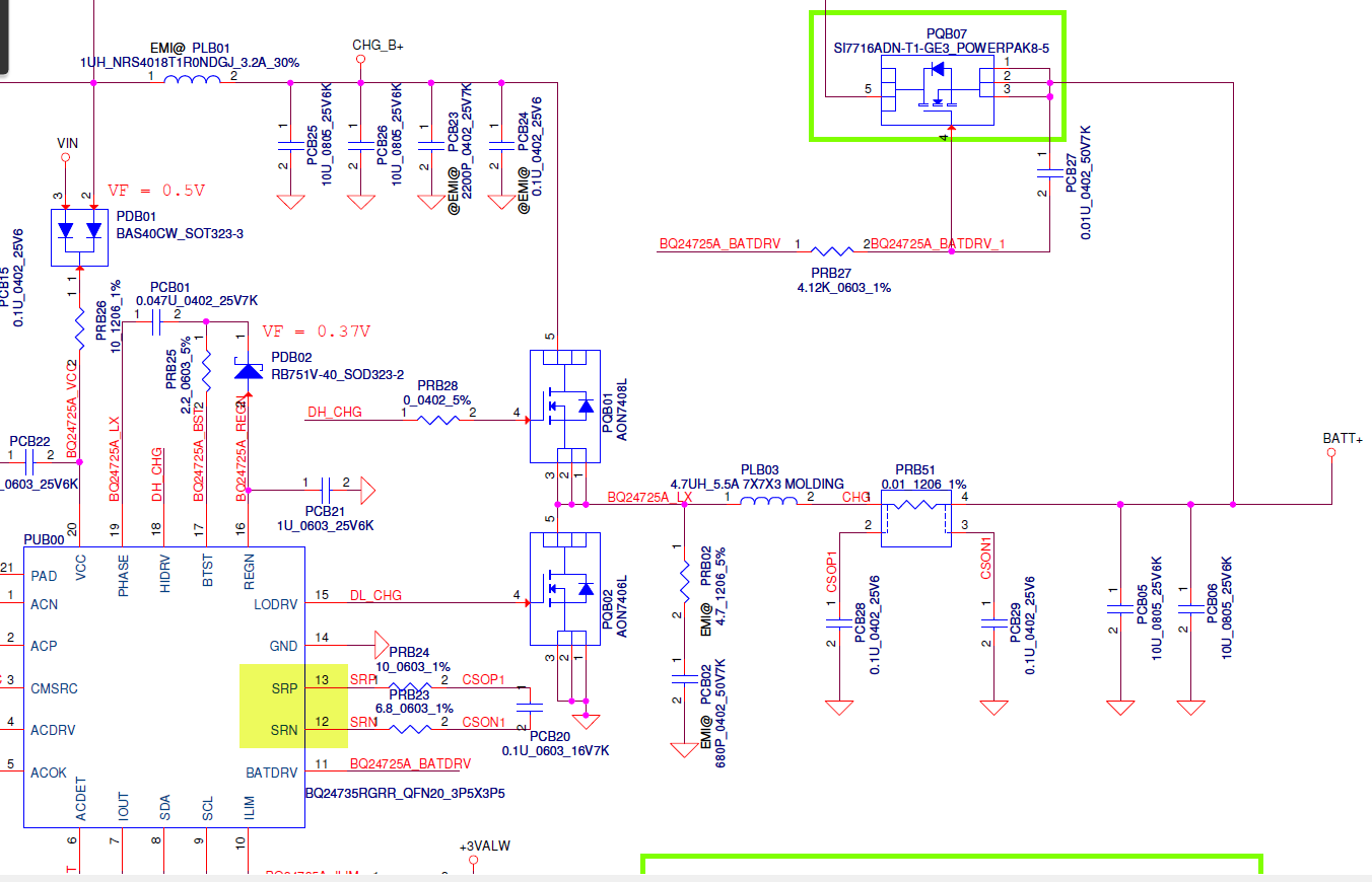

        1) Remove mosfet @ PQB07 (battery mosfet) and power up again with the battery and adapter. Any difference?
        2) Measure the voltage to ground of
        SRP (pin #13)
        SRN (pin #12)
        of the charger IC - measure at the charger IC pins.
        Red meter probe @ pin to test; black meter probe to ground. Meter in DC 20v or higher scale. These pins are the current feedback pins for the battery voltage. The voltage on each pin should be close to each other in value and to the battery charge voltage.
        The charger IC measures the difference in voltage (ie. voltage drop) from the start to exit of the current sense resistor (SRP to SRN) to determine how much current is being consumed by the load = battery being charged.
        3) Be sure that the replacement charger IC is working - check
        REGN ; should be ~6 volts
        ACOK ; should be the pull-up voltage of ~3 volts
        ACDRV ; should be ~25v to enable the DCin mosfets
        EC_SMB_DA1
        EC_SMB_CK1
        Post each measurement.

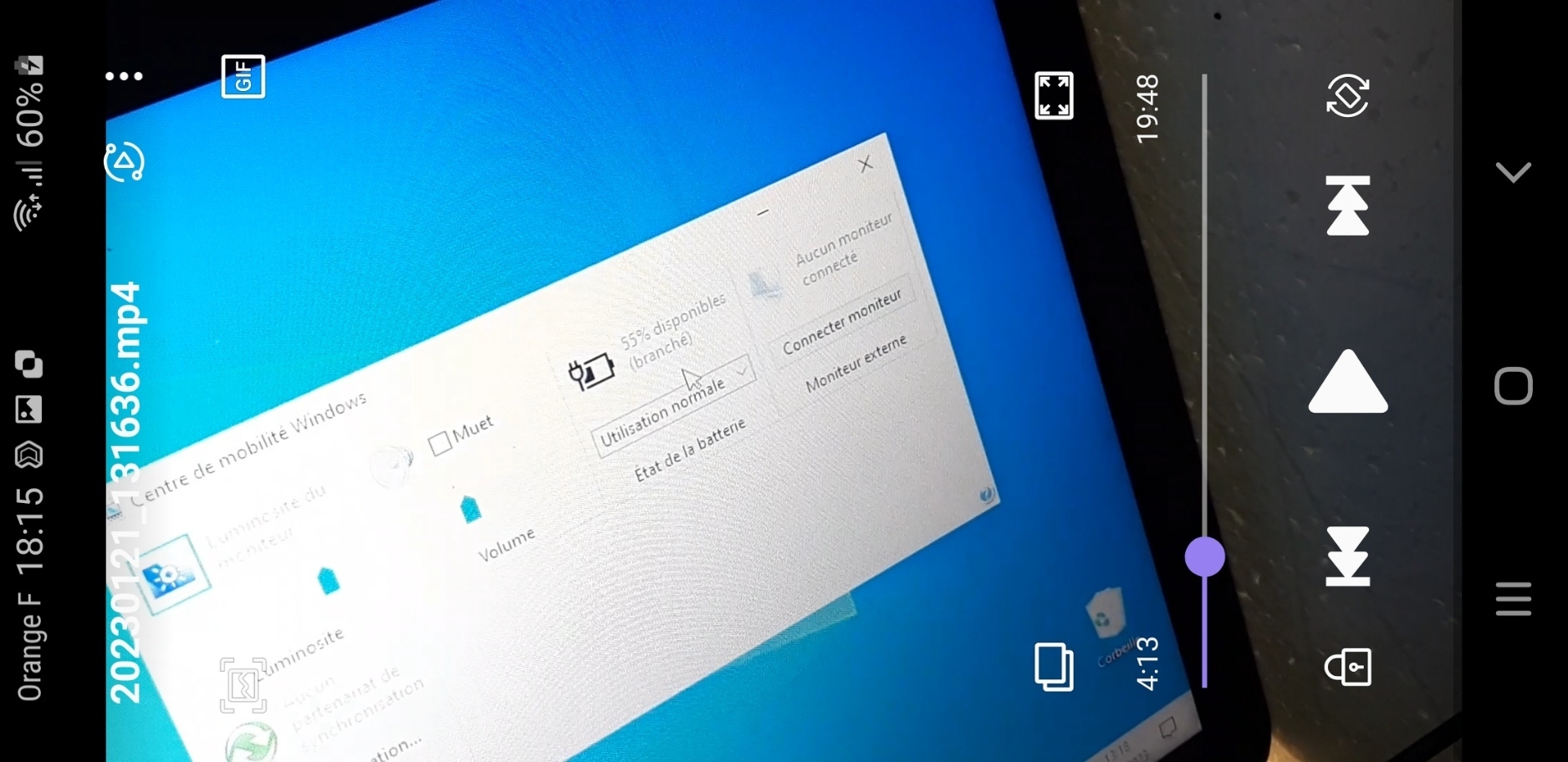

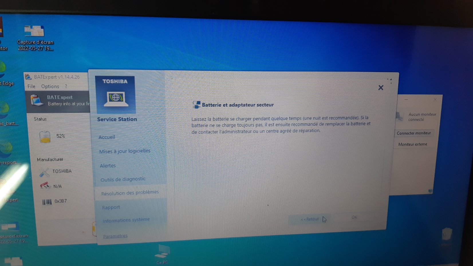

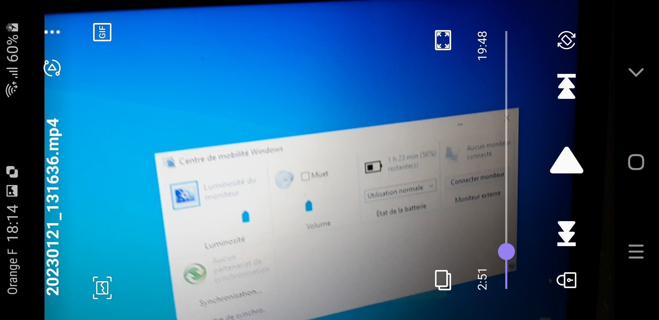

            Re: TOSHIBA C50-B-14F works but no charging
            here's what Windows shows on battery.
            The 1st time I plugged in the battery:
            • mon2
              • Dec 2019
              • 13995
              #46
              For pic # 1, only the battery was used to power up? (no adapter?)
              For the pic # 2, did you plug in the power adapter ?

                #47
                yes

                  here are the voltages on each pin of BQ24735, PC off, with the battery plugged in and the AC plugged in.
                  1: 19.2v
                  2: 19.2v
                  3: 19.2v
                  4: 25v
                  5: 3.3v
                  6: 2.5v
                  7: 0.5v
                  8: 1.4v
                  9: 3.3v
                  10: 0.8v
                  11: 15.5v
                  12: 15.5v
                  13: 15.5v
                  14: 0v
                  15: 0v
                  16: 6v
                  17: 19.8v
                  18: 19.7v
                  19: 15.4v
                  20: 18.8v
                  After taking these measurements, I removed the PBQ07 mofset and the charge is still not done.

                    Measure the voltage to ground again for pins 8 and 9 on the charger IC.
                    Pin #8 = SDA communication pin appears to be too low of a voltage and may be stuck.
                    Locate also the battery connector. The same SDA and SCL lines will be present there for communication with the BMS (battery management system) inside each battery pack.
                    Measure the voltage to ground of these pins at the battery connector.
                    Post all measurements.

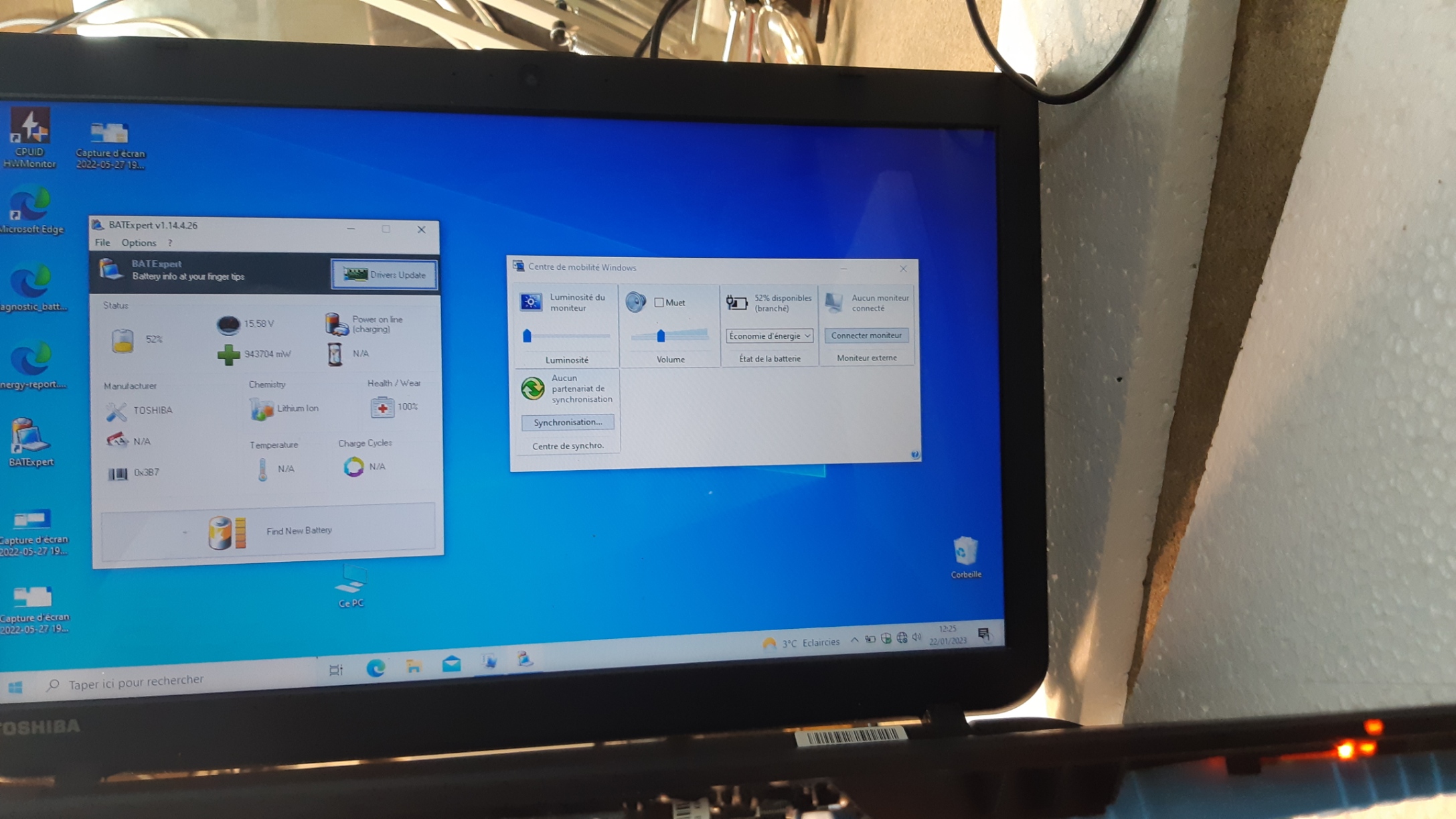

                      #50
                      Voltages are ok with 3.2v
                      You had offered me to reflash the bios, but I can not find it on the net, but I found a Toshiba "Gas Station" app that should have offered me to download the latest bios, but the app does not offer me anything.
                      In addition this app has a battery test that I did and everything seems normal, except this message see photo.
                      It may be necessary to wait some time for the load to be visible in Windows.

                        Measure the voltage to ground of pin 15 and also pin 18 on the charger IC.
                        Each is driving the gate pin of the local mosfet.
                        Pin 15 is 0 volts?
                        What are the voltage markings of your battery pack?

                            What is the voltage to ground of pin # 11 (BATDRV) on the charger IC
                            a) with NO adapter but battery is attached ?
                            b) with adapter and battery attached ?
                            Update - see attached.

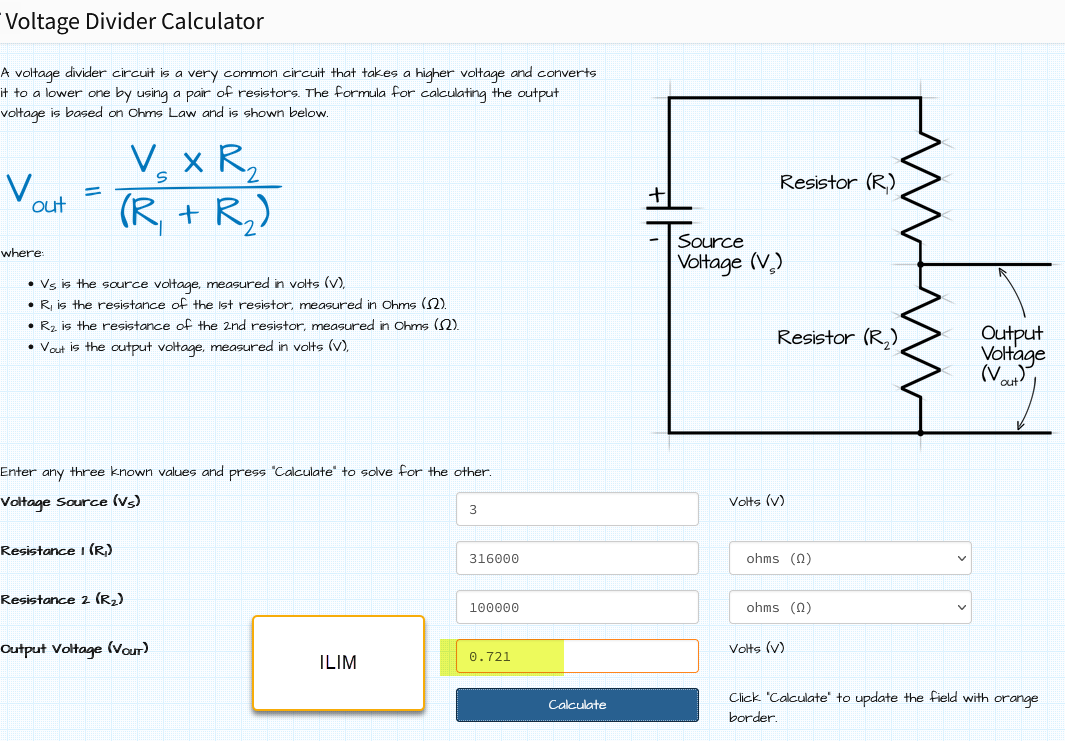

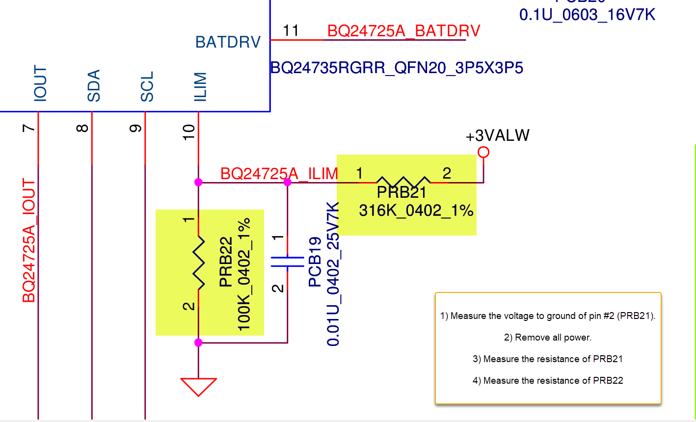

                            Interested in the review of ILIM pin.
                            After these measurements - power down - remove resistor PRB22 off the logic board and test again.
                            ILIM is a definition of the MAX current the charger will apply for the charge current. It will select the lower of 2 values - internal or defined by the external voltage on this pin.
                            From my calculations, if +3VALW is ~3v, the voltage @ ILIM should be ~0v72.
                            If PRB22 is removed, the external voltage on ILIM will not be used for the MAX charge current.

                              #54
                              Hello
                              I raised the voltage on pin 10 to 1v2 by putting another resistor of 300K in parallel on PRB21 it was simpler than desoldering it.
                              Pc off the consumption has not changed so I guess the charge is not done.
