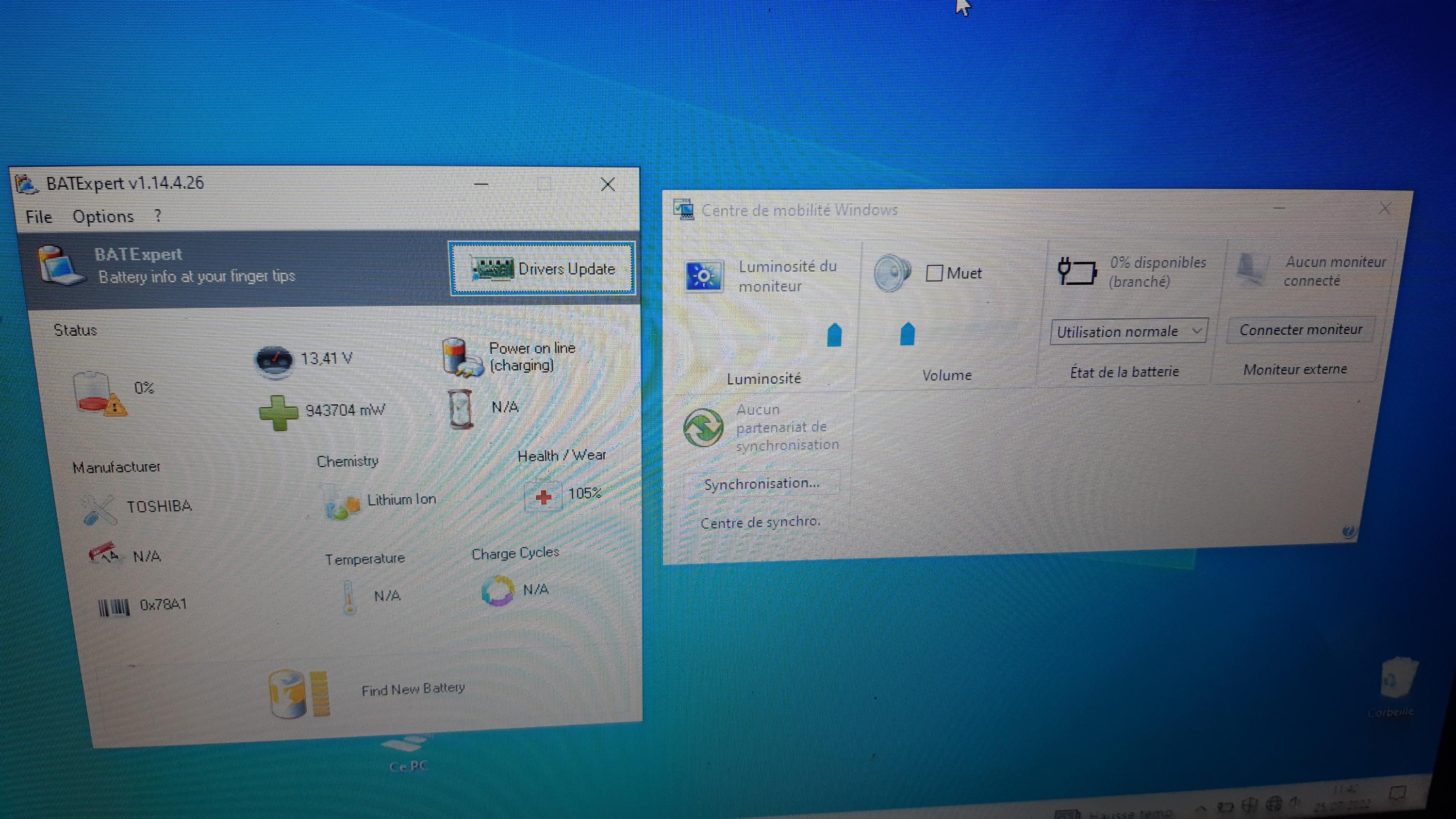

    Hello
    Excuse my English but I am French and I use a translator to communicate with you.
    I have a problem with a TOSHIBA C50-B-14F PC.
    This is a pc that was unused for several months because it was no longer starting at all, in fact the problem came from the capacitor PCB26 which was in CC, so I changed it and the pc worked again.
    The battery being HS, I ordered a new one but impossible to charge it, in Windows the presence AC / battery works but the percentage remains fixed and if I remove the AC power, I have a message "low battery".
    So I changed the BQ24735 charging chip as well as PQB01 and PQB02. I tested PQB07, PQB03, PQB04 to the ohmmeter, they look ok. I did a voltage reading attached and everything looks ok too. I don't know what to do anymore, if you could help me it would be great.

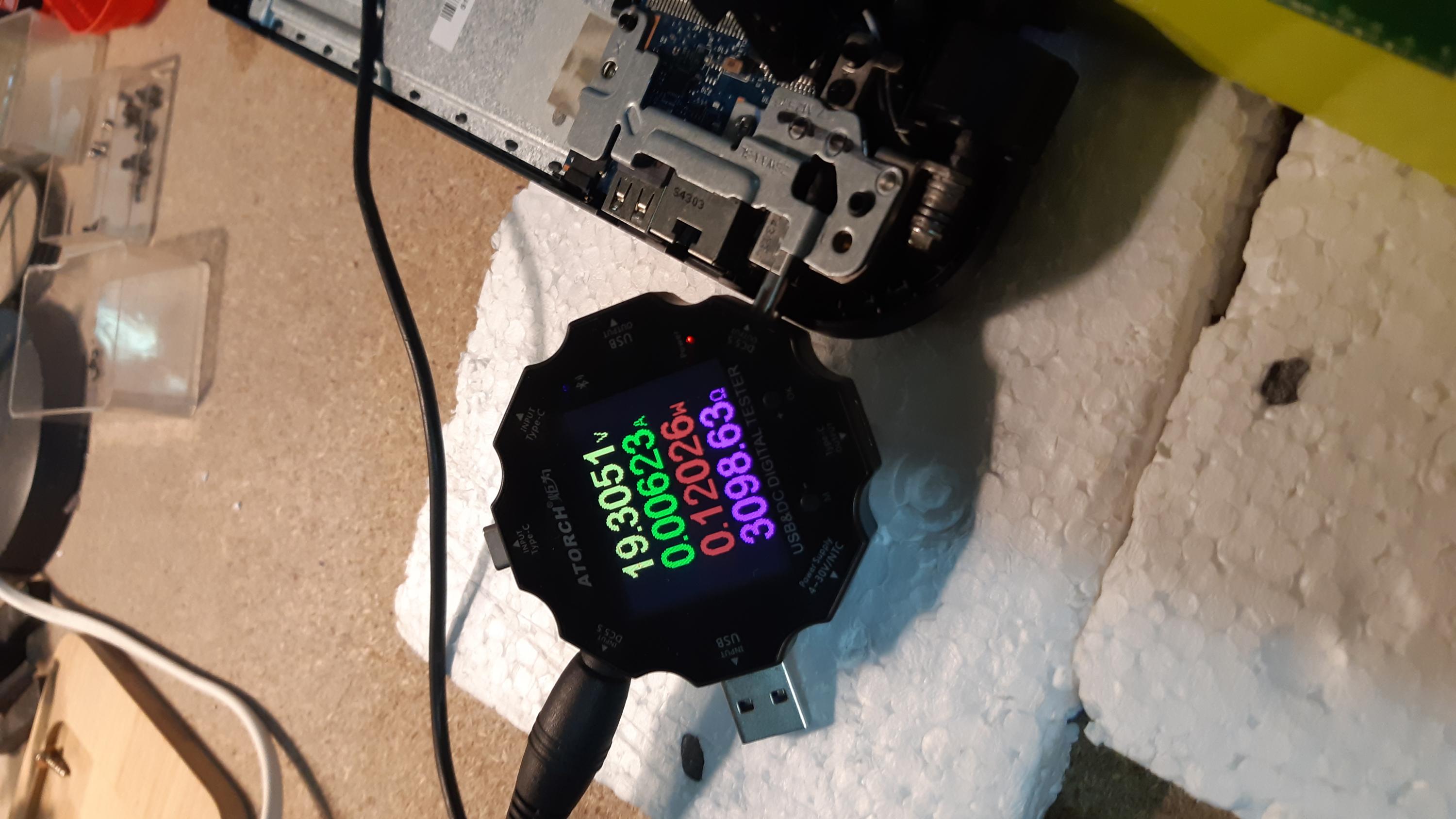

    I have a consumption of the alim 19v, pc off of:
    0.00498A without battery
    0.00615A with battery

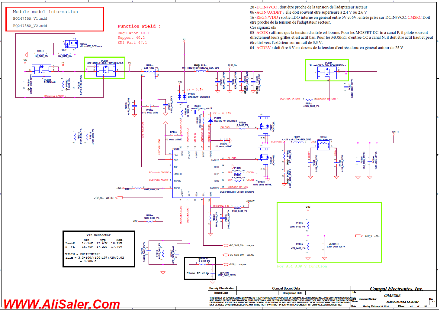

          Can you link the full schematic if available on this forum?
          • telenaze
            • Dec 2021
            • 45
            • france
            Re: TOSHIBA C50-B-14F works but no charging
            I put two photos in my first post, but here is the complete diagram.

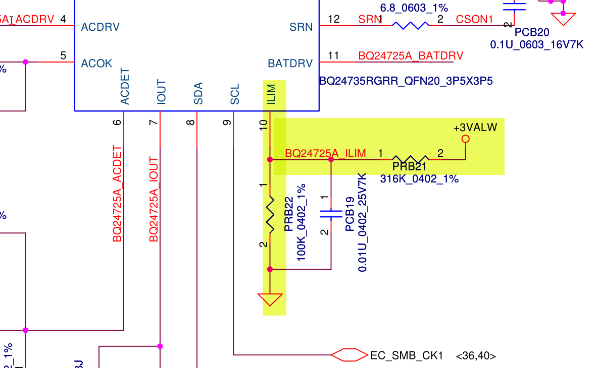

              What is the voltage on pin # 10 (ILIM) of the charger IC (PUB00) ?
              • telenaze
                • Dec 2021
                • 45
                • france
                I just looked and I have 0.8v on pin 10 (ILIM)

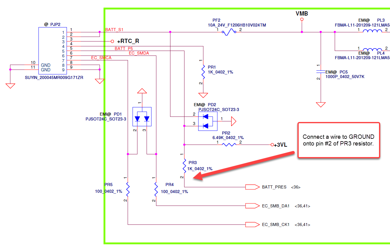

                • mon2
                  • Dec 2019
                  • 14415

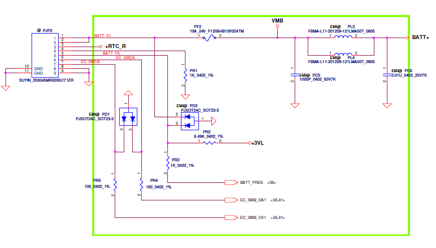

                  Battery connector with or without power connected:
                  1:13.42v
                  2:13.42v
                  3: 3.15v
                  4:0v
                  5:2v
                  6:3.3v
                  7:3.3v
                  8:0v
                  9:0v
                  See attached. Connect a wire to ground from resistor PR3 (pin # 2).
                  Test again on the charging with this hard strap.
                  • telenaze
                    • Dec 2021
                    • 45
                    • france
                    Hello
                    So, PC off with PR3 pin 2 connected to the ground laid I have:
                    0.4v(2v) on pin 5 of the battery connector
                    13.4v(13.4v) on 1-2 pins of the battery connector
                    17.7(17.7v) on pin 18 of the 24735 "DH CHG"
                    No increase in consumption, so I guess it doesn't load.

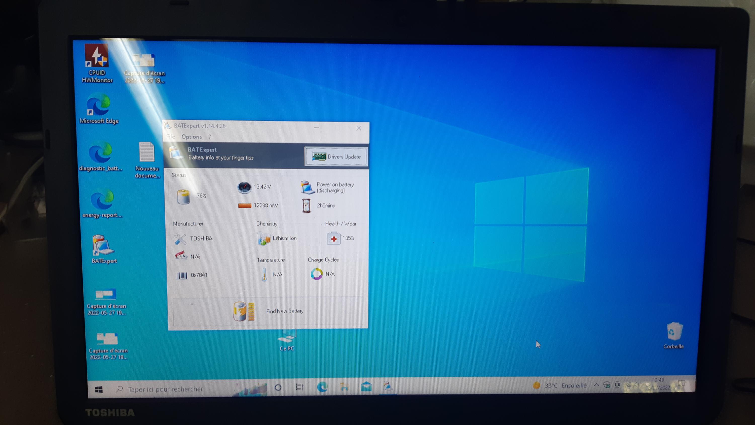

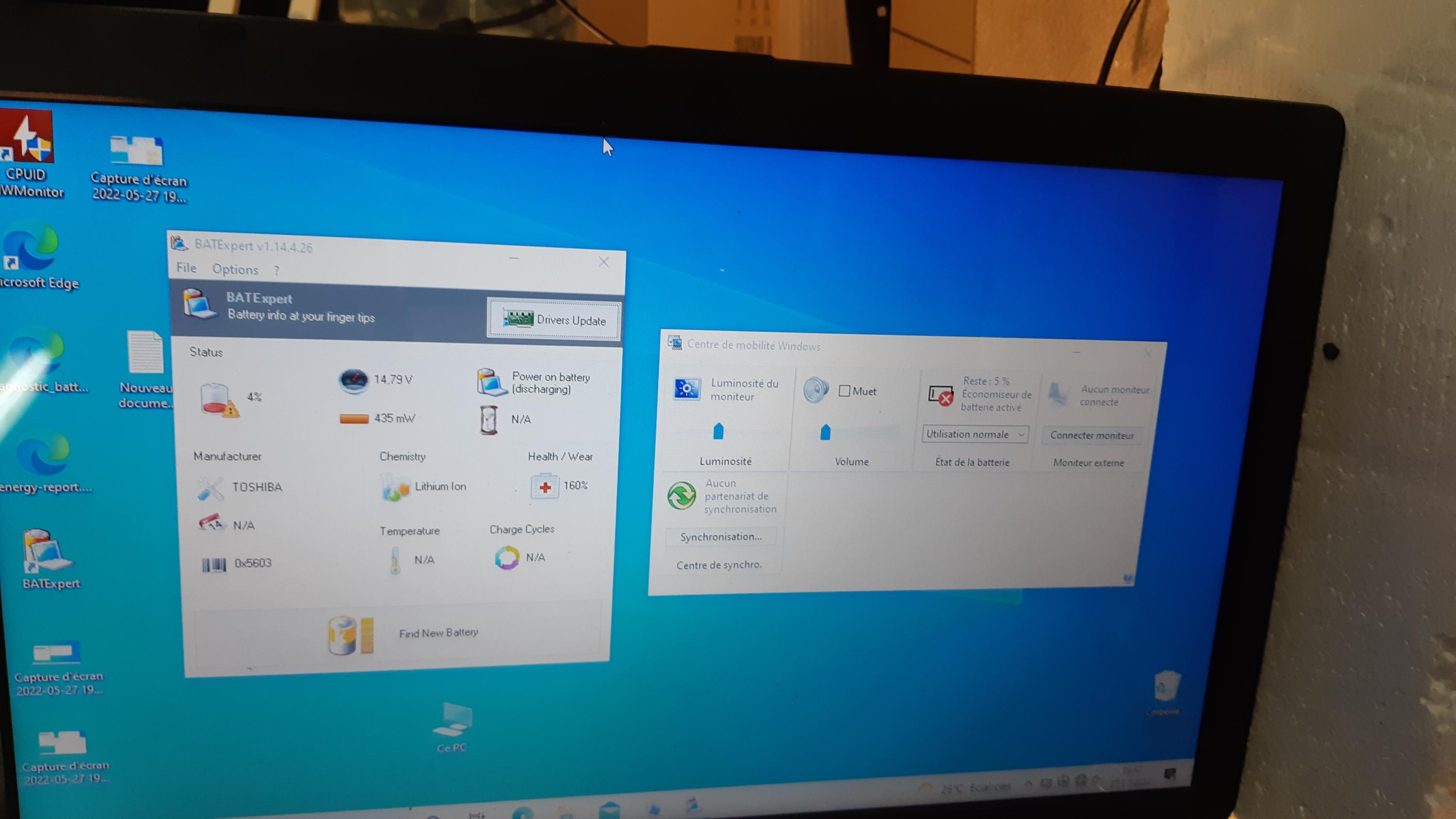

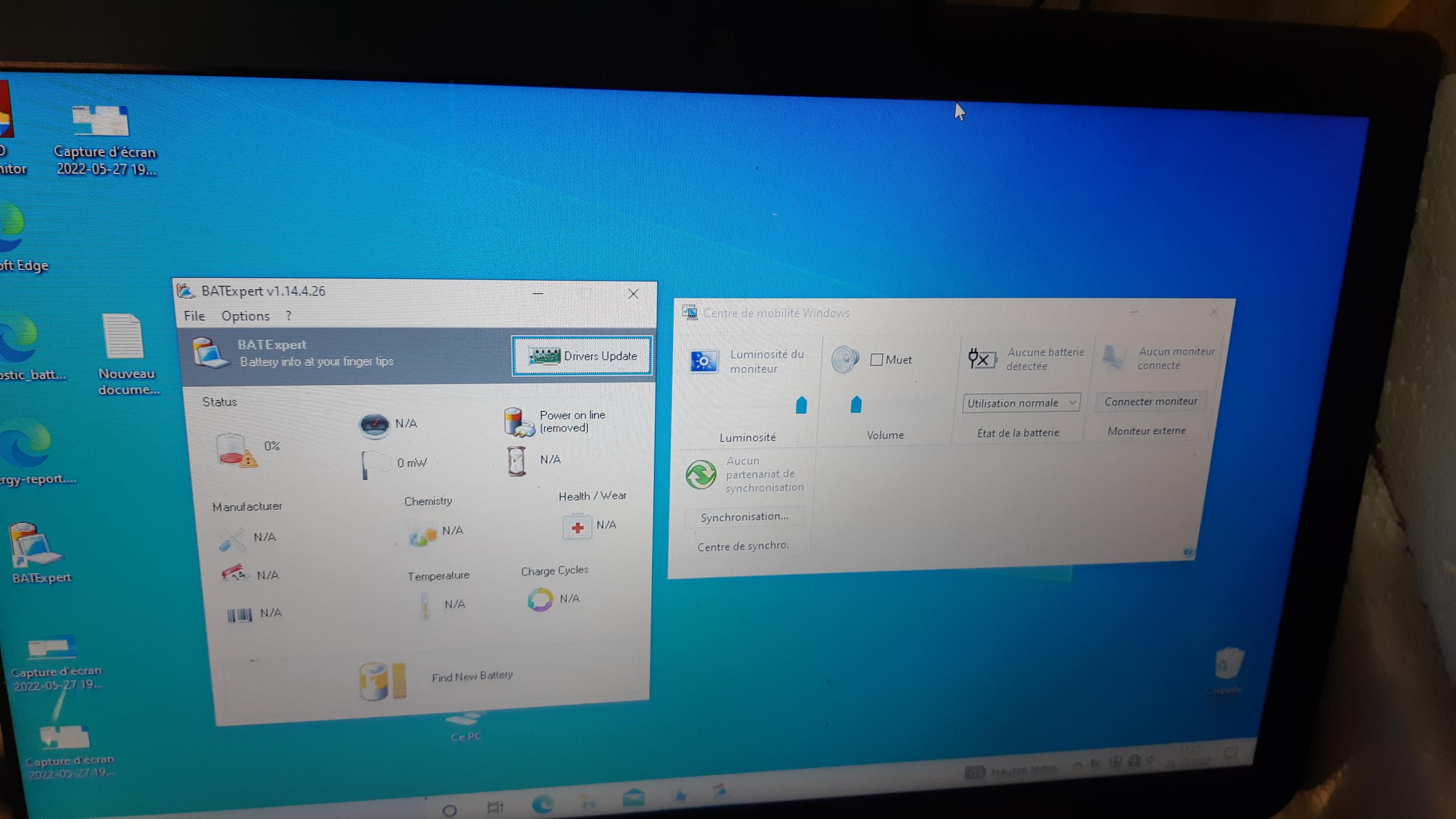

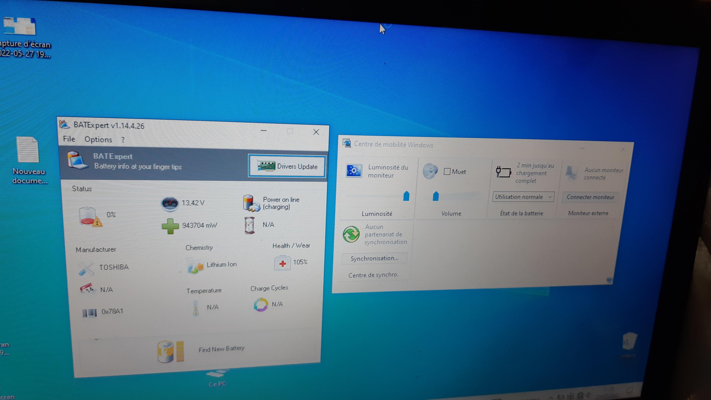

                        As I specify in my first message, in Windows I do have a message of presence / absence battery.
                        I just did a test again (without the wire to the ground) and here is the behavior of the PC.
                        1 Booting PC without battery:
                        Windows announces "no battery detected", I plug in the battery and there Windows closes and the pc turns off.
                        I restart the PC (still with the battery) and there Windows announces me a presence battery with 0% available.
                        2 Booting the PC with battery:
                        Windows announces "2 min until full load".
                        I disconnect the battery and there Windows tells me "no battery detected".
                        I reconnect the battery and there Windows closes and the pc turns off.

                                    From your earlier screen posts, the battery IS detected; the battery brand is being read ok; some data is being extracted out of the battery OK.

                                    The ILIM setting is normal. The gate voltages are correct for the dcin mosfets; the battery mosfet is requested to remain OFF since the main ac adapter is powering the logic board.

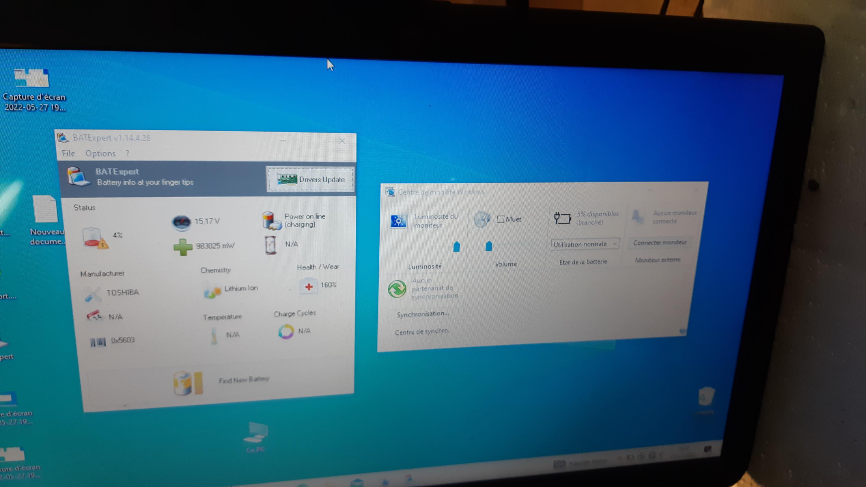

                                        Hello
                                        in the end I disassembled the HS battery and charged each cell individually with a suitable charger.
                                        I found a voltage of about 15v at the battery terminal.
                                        I connected this battery to the AC powered PC and windows now announces me a battery available at 5% and if I unplug the AC windows tells me battery saver activated and autonomy remaining 5%.
                                        The problem is that the battery still won't charge, so I think the problem isn't with the battery but with the motherboard.
