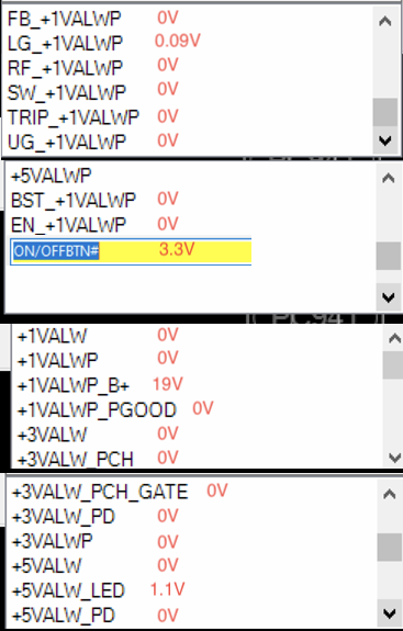

Hi. I have problem with the aforementioned laptop. I replaced the KBC as I found the short on it, with new one short was gone, but I get no voltages across the board apart from 19V on main rail and 3.3V on power button. I definitely need a help to move on. Thanks

I am using Dell AAP11 AAP21 LA-C912P rev 1.0 although my board is rev 2.0, and boardview LA-C912P Echo15MLK_0723B_NV.cad
My question is, if the KBC is removed, should 3VALW and 5VALW be present anyway or KBC does enable it? PU100 TPS51225CRUKR have 5V and 3V have enable
pin that goes straight to the KBC so I presume it's the KBC that has to enable it first? thanksLast edited by kuba2102; 07-22-2022, 05:22 AM.Comment

It is possible that the regulator has an internal pull up and then the default floating state will be to enable the regulator. If KBC drives the pin low, regulator will then be OFF. This case is for active HIGH enable.
Reverse case for an active LOW enable.Comment

Hi. I had to get a new KBC chip and I managed to get the voltages and somehow program the new KBC, BUT it programs itself only up to 00010000 address, which is something like 8MB instead of 16MB code. Im using SVOD4 and have no idea what could be causing it.Comment
