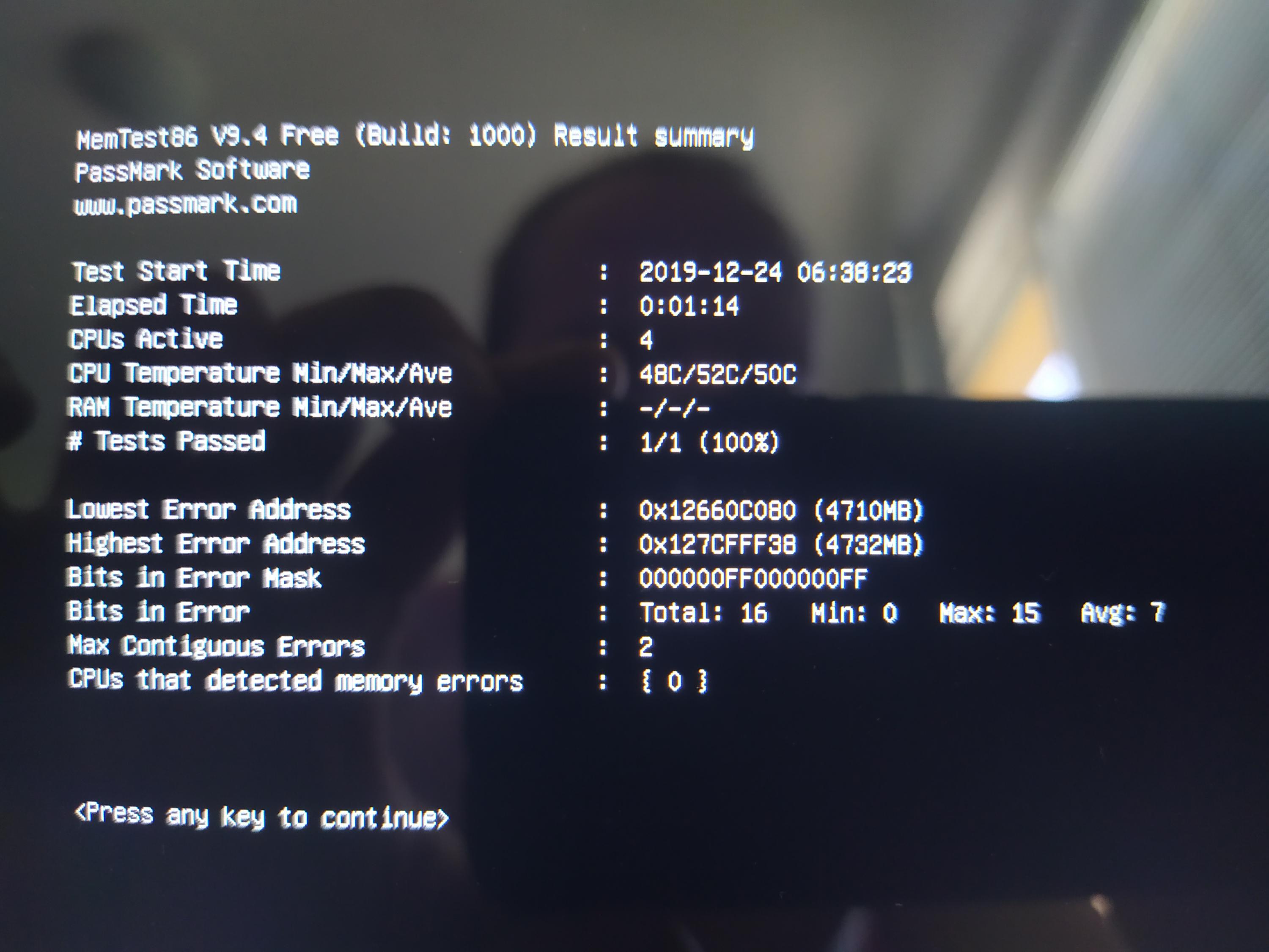

    Helo.
    I have this BMAX Y11 laptop that freeze with BSOD/page fault/ when installing windows. i try MS installation and even BMAX windows deployment tool.

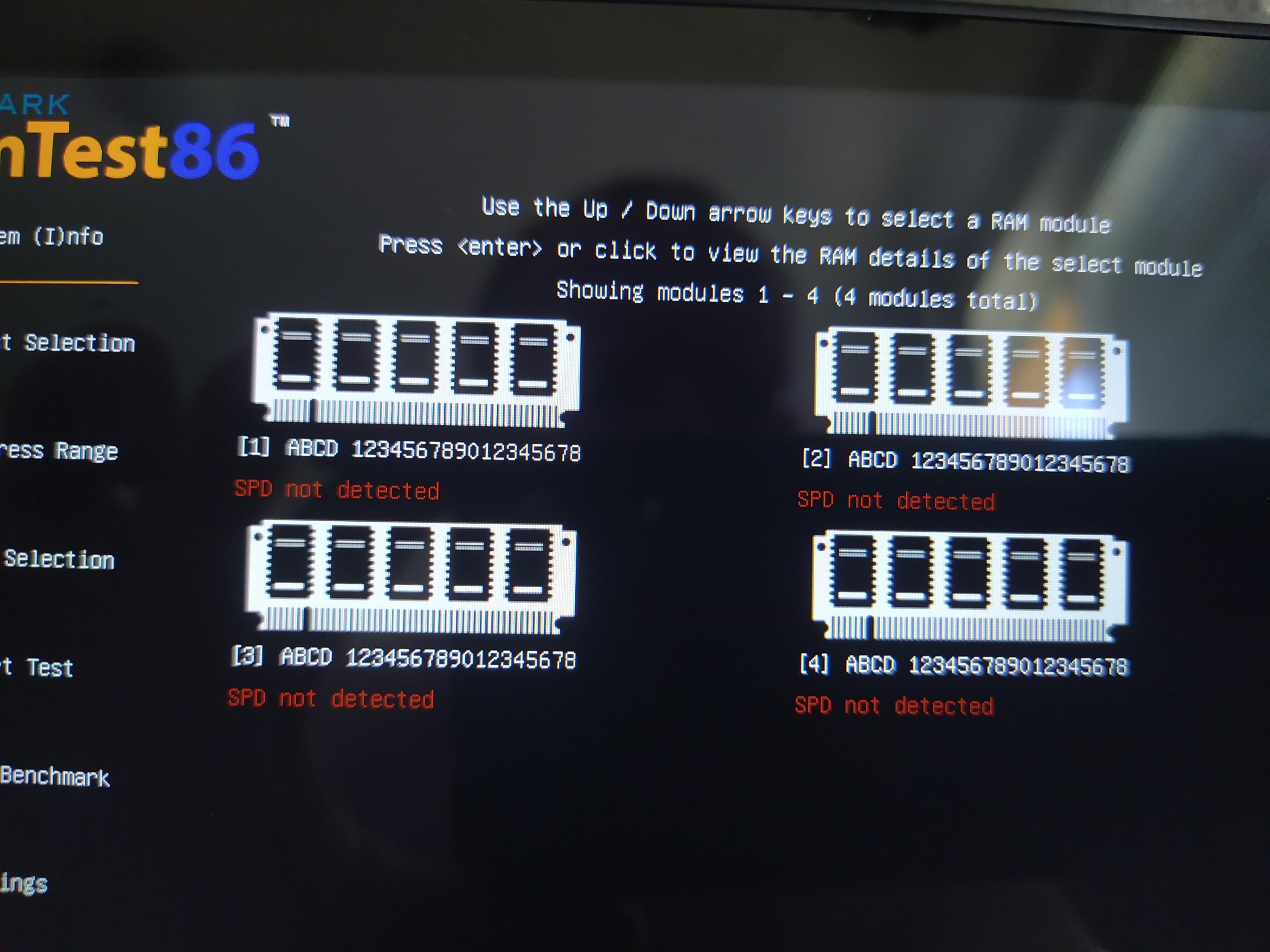

    I download usb memtest that show errors. I see errors is on cca 4.7GB. There are 4 GB chips so it must be 3rd. but how to check from what chip os first to determine bad chip?

    I open it and found 2x4GB chips Micron D9VKN MT53D512M64D4HR-053
    so one of two is bad. but how to determine which one is bad?

      So consider to heat up one of the 2 chips to see if it helps. If it does, likely that is the bad one.

        it is just few cells dead, others work normal. But this is so expencive RAM ic that one cost 60eur. I did not even find stencil for it.
        But repair is for cost of IC too high for custommer so nofix
