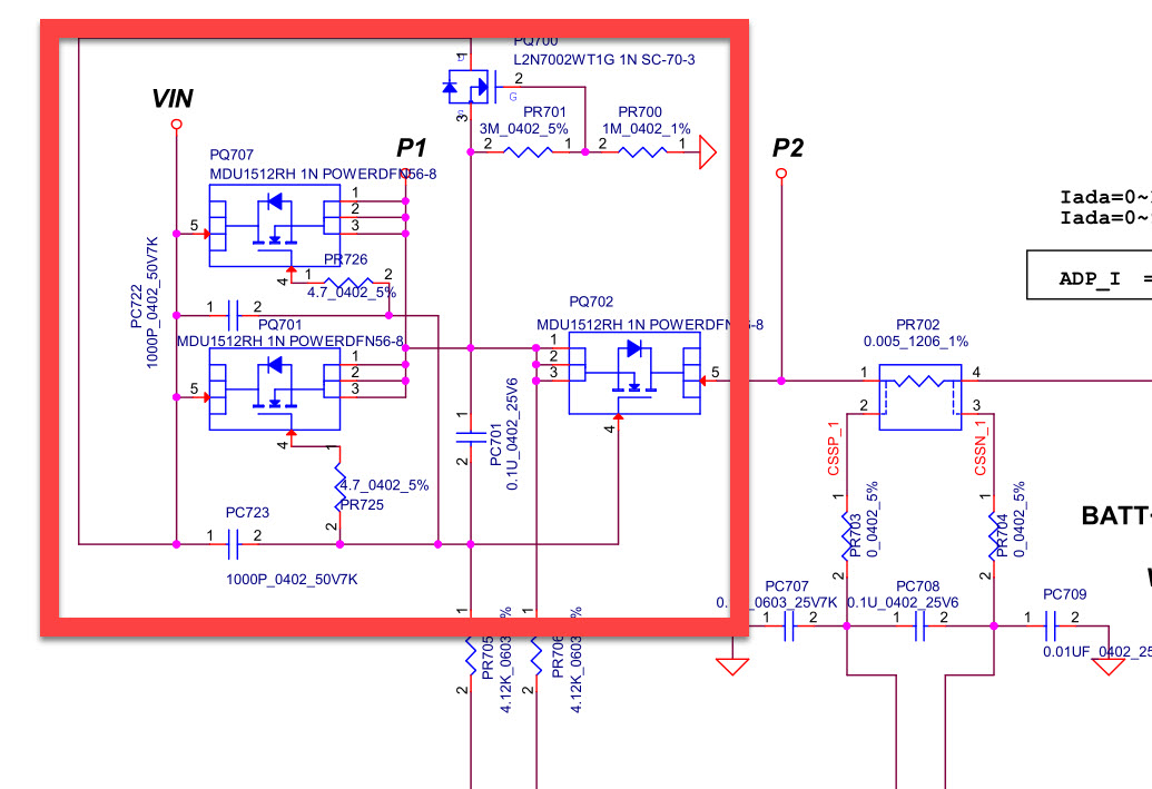

                      #30
                      Re: Alienware 17 R3 (LA-C912P) Powers on then powers off after 4-6 seconds
                      Also there are times when I'm inside Windows and I disconnect the charger and plug it back in and the charger will sometimes shut off.
                      Is the adapter the original ?
                      Inspect the first 2 / 3 mosfets linked to the AC adapter that power your logic board.
                      These are mosfets shown in the attachment.
                      Remove all power / NO battery. Meter in resistance mode.
                      Check the resistance between the mosfet pins as follows:
                      source (1-2-3) & drain (5-6-7)
                      source (1-2-3) & gate (4)
                      gate (4) & drain (5-6-7-8)
                      Post each reading & meter scale that is used. If you see '0.L.' or '1' -> switch to a higher meter scale.
                      Repeat for each mosfet in the attached.

                        #31
                        No power (Battery nor AC)
                        PQ701
                        Source to Drain => 0.2 Ohms
                        Source to Gate => 107 Ohms
                        Gate to Drain => 107 Ohms
                        PQ702
                        Source to Drain => >40K Ohms
                        Source to Gate => 111.8 Ohms
                        Gate to Drain => >40K Ohms
                        PQ707
                        Source to Drain => 0.3 Ohms
                        Source to Gate => 116.3 Ohms
                        Gate to Drain => 116.3 Ohms

                          #32
                          Each of these mosfets are too low in the resistance. They need to be replaced. These mosfets are very inexpensive and usually < $1 USD each (Aliexpress).
                          If in a rush, you can order from Digikey / Mouser / Arrow. There are many equivalent mosfets available.
                          Since you have a donor board - check the mosfet readings there for each.

                            #33
                            I can pull some from the back of the donor board that are measuring healthy.
                            They should be somewhere in the x10K or x100K Ohms range yeah?
                            Lol shoot how did I miss this.

                                #35
                                So I took 5 of the 6426 MOSFETs from the donor Alienware board as practice and out of the MOSFETs I took off (PQ701, PQ702, PQ703, PQ704, PQ707), only 1 of them was bad and measuring 0 Ohms between Drain and Source.
                                It was PQ707 which is the first power MOSFET. The other 4 are good as they measure 3.3M Ohms between Drain and Source.
                                On the working board, PQ701 was the one measuring 0.3 Ohms between Drain and Source, and after taking off PQ707 and PQ701, the resistance of the contact points on the board for those MOSFETs are now up into the M Ohms range.
                                So I really only had to replace one of them since measurements are now normal.

                                    #37
                                    Resoldered the functional MOSFETs onto the board and tested resistances of PQ701 and PQ707. They're now up into the 10k Ohms after replacing PQ701.
                                    The board works. Laptop powers on still.
                                    BATTERY APPEARS TO BE CHARGING!!!
                                    BattInfoView shows 70,000 mw of charge.
                                    That...was also my first real board repair. Capacitors vs MOSFETs; two different beasts.
