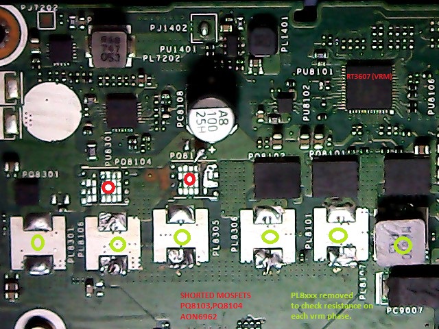

            • lpraderi
              • Dec 2017
              • 31
              • Uruguay
              Re: Acer nitro Nitro 5 FH51M No Power
              Similar problem, 0 Ohms on B+ rail (19V).
              Lifted CPU VRM Phase Coils , short gone .
              ID Phase3 and Phase4 Output mosfets PQ8103 and PQ8104 (AON6962)
              Waiting for new ones.
              Datasheets:
              PCB: LA-F591P
              VRM RT3607CE
              MOSFET AON6962
              • mon2
                • Dec 2019
                • 14677
                This often means that the high side voltage of ~19v has hit the CPU and the CPU is now defective.
