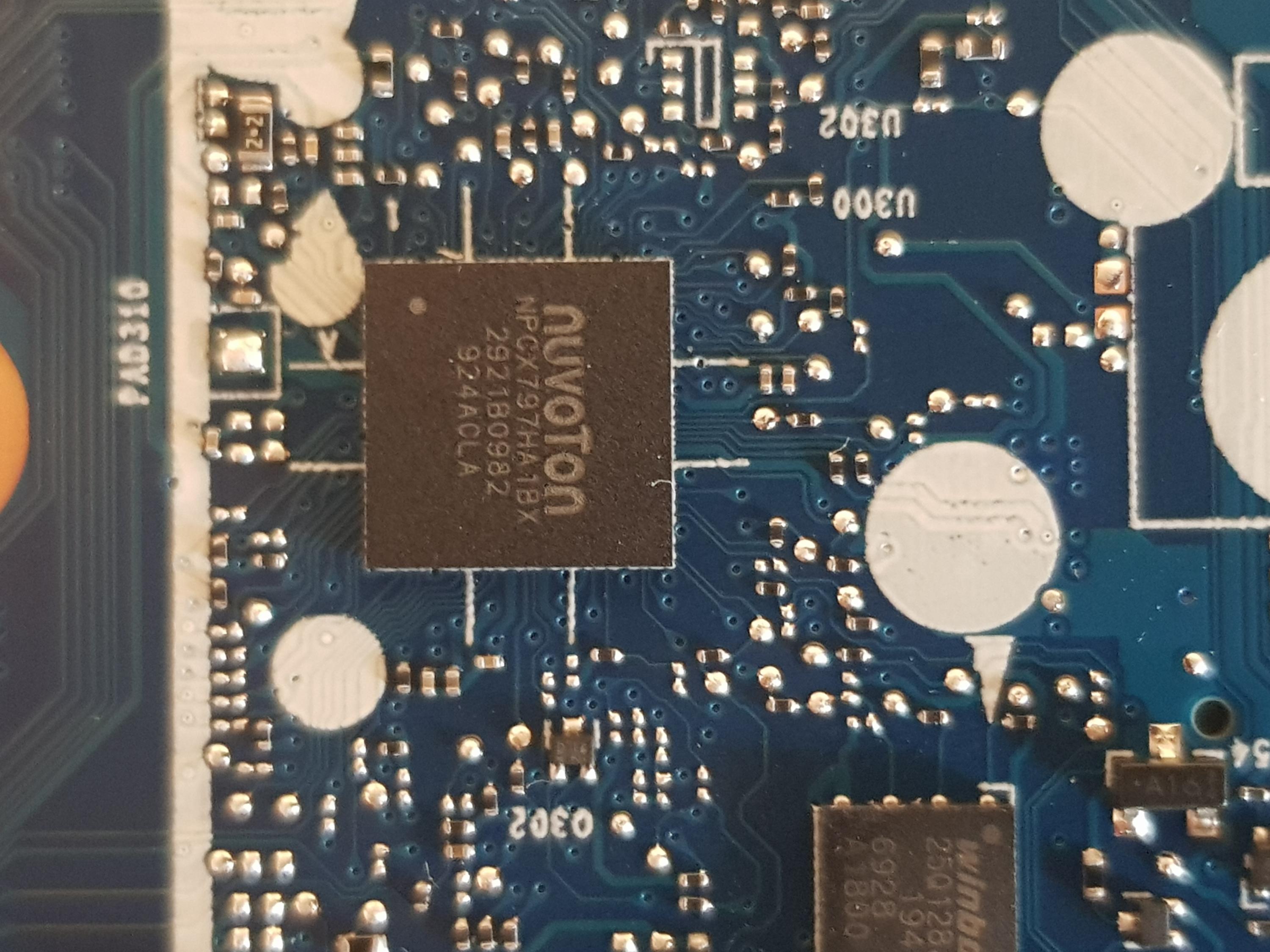

    hp 850 g6 not powering on
    MOBO model: 6050a3022501-mb-a01
    after measuring the coils on board, i have found 12v,5v,3.3v
    also have 3.35v on power button and orange light near dc in conn.
    how can i continue inspect that ?

      Re: hp 850 g6 not powering on
      Thank you for your answer,
      I think the history of the laptop is liquid spill on key board but i found no corrosion on MOBO, also when connecting it to power adapter i see a slight/tiny heat point on the chip on the attached pic
      is there a guide on how to Check the basic requirement of SIO ?
          No. U need to make a backup from the working board and then clean me region of that backup and flash on the board you are working.Your SIO is BGA chip-so almost impossible to check.

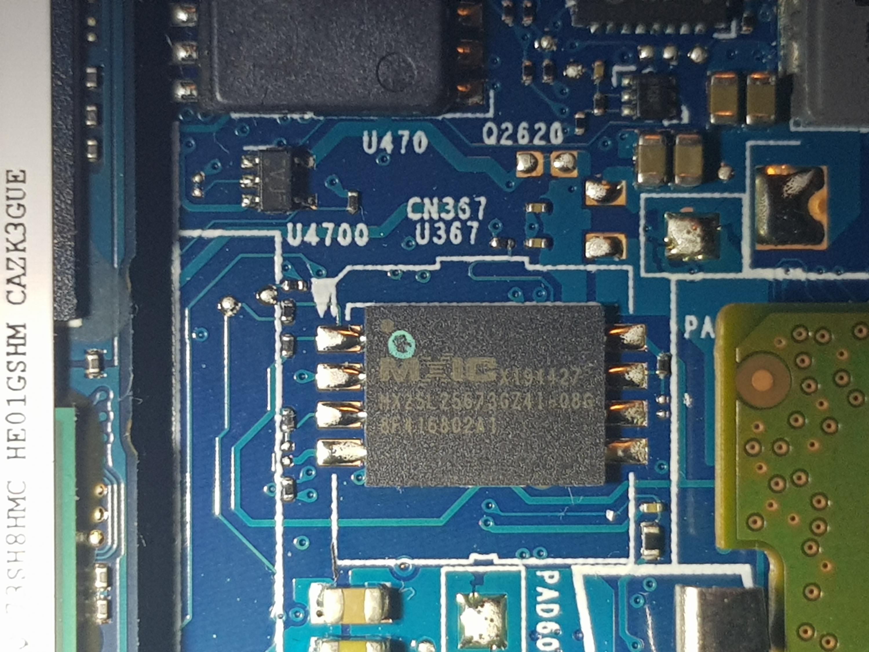

            A question please,
            in order to back up the working one, do i must unsolder and read via programmer or its possible from within OS?
            Also is the chip in the attached photo is the BIOS ?
              Unsolder from laptop mb and read with Spi programmer. Its a 32MB Chip.
                OK, finally i succeeded to read the bios and i have a file.
                  I have flashed bios i have got from the good folks here
                  https://www.badcaps.net/forum/showth...05#post1137805
                  But Laptop still does not power on, i can see its charging the battery but not powering on.
                  any other suggestion? any idea? any direction?
                    about bios i don't have the flash tool.
                    Perhaps SIO is bad as you mentioned its heating a bit. What is the resistance on 3V LDO??
                      Can you please suggest me where to measure ?
                      • mcplslg123
                        • Jun 2015
                        • 7262
                        • india
                        Schematic for this mb is not in my desk. Which 3V regulator is there on this board?? You can download the datasheet of this ic to findout 3V LDO pin.
