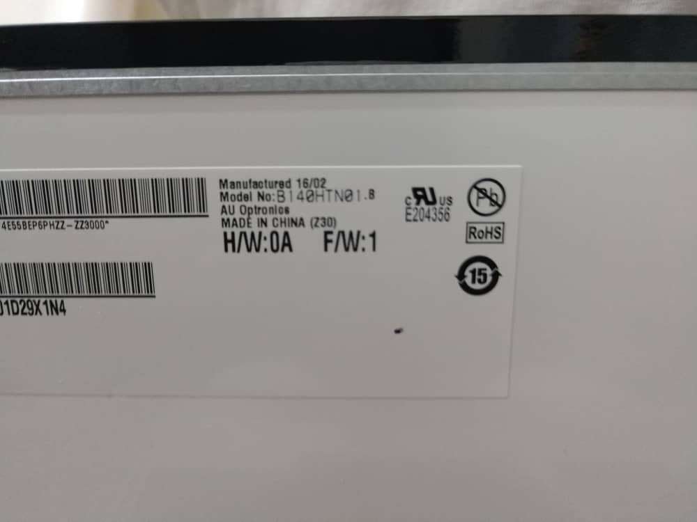

    I am working on an HP ProBook 440 G4 Quanta X81 DA0X81MB6E0 Rev E motherboard that works fine with an HD panel (external HDMI does work) but fails to post on a FHD panel ( no picture on external HDMI either)!
    What can be the problem? Any help would be greatly appreciated! Thanks in advance!

    Hi, are you sure the FHD panel is compatible with the motherboard?
      Re: HP ProBook 440 G4 FHD No Display!
      Yes. It is the one that originally came with it! I have tried another screen, same part number!
