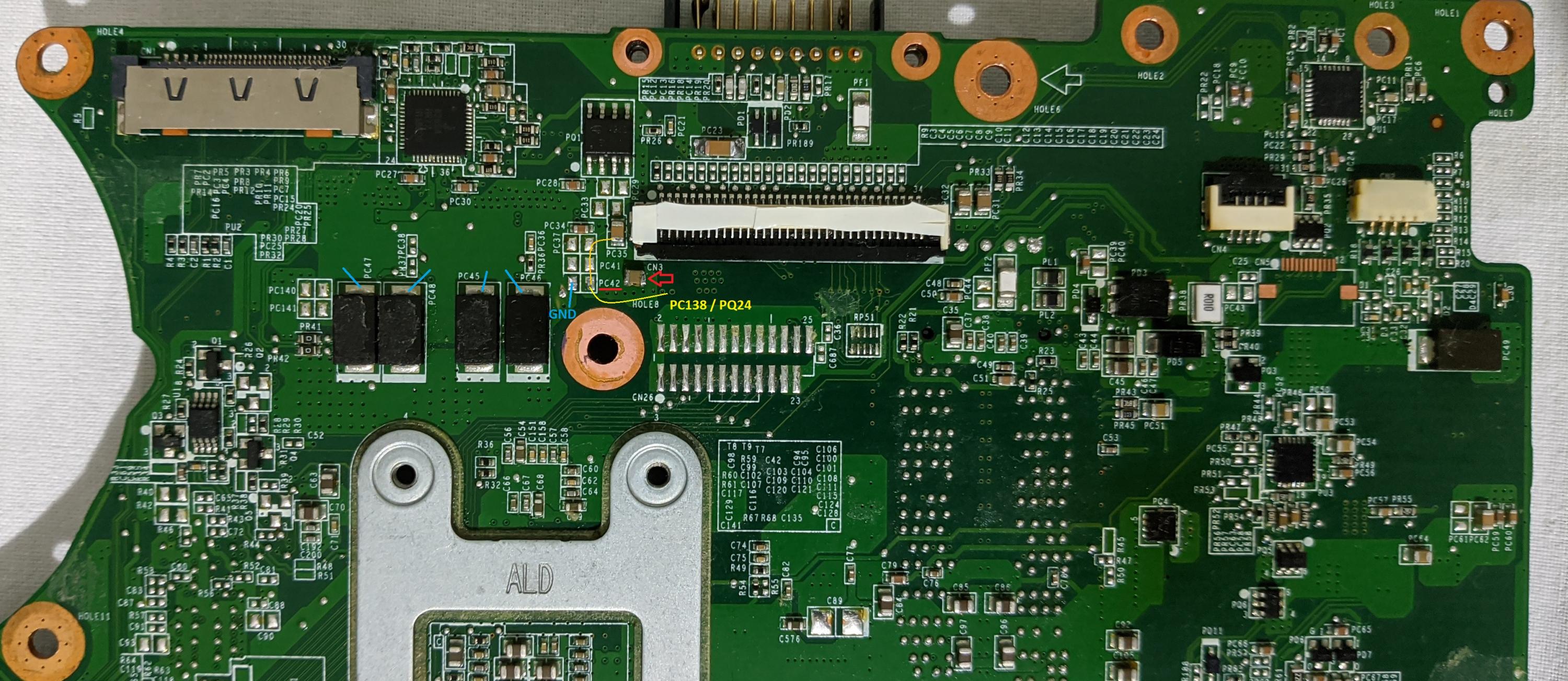

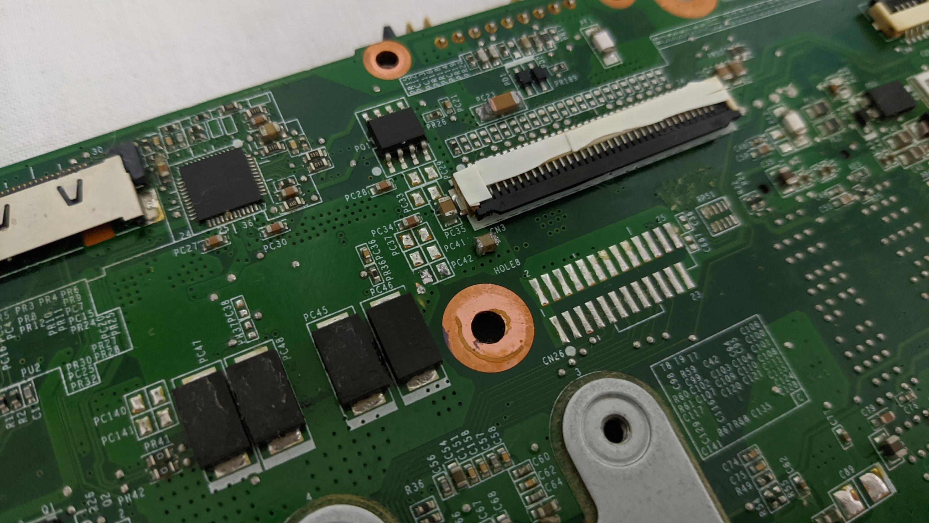

          FOUND IT!
          PC42, left side of the flat keyboard connector (missed in the photo n4).
          I will put a photo tomorrow xD.
          I was so focussed on that part of the board near the ram slots (the ram itself had a burning capacitor!), the mosfets, the hot area with the power supply connected....but the problem was in another part x.x.
          And when a tried with the bench supply, probably i did it wrong. xD
          So, that capacitor has 0 ohm, dead.
          The "ground part" of the first mosfet is gone, like all the other things near it.
          All the capacitors that i disconnected before with double ground sides now have only one side to ground!
          Also, with the plus of the bench supply in that point of the mosfet, now no more voltage drop etc.
          It's really only that capacitor the problem? x.x
          NOW, i read isn't safe to put the dc power with a disconnected component....how can i know the farad value of that dead capacitor?
          Testing the others with the same size?
          Again thanks and tomorrow i will add the photo of the "new little problem" area!

            Originally posted by AidenX
            FOUND IT!
            As I assumed, and as I told you in most of the cases this is the reason, especially when the resistance in the line is so low as in your dead short main power line case.

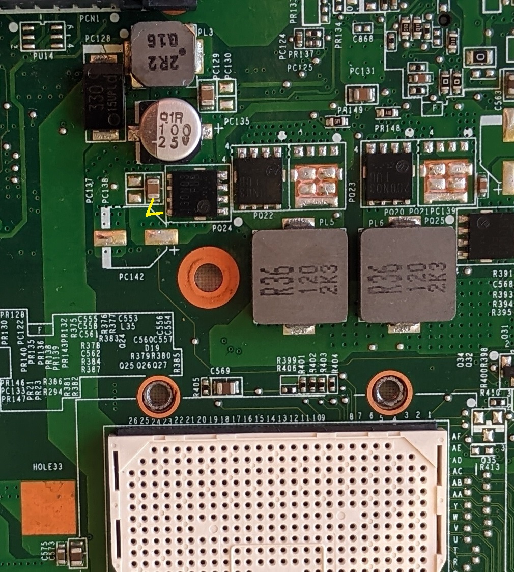

                Re: Toshiba Satellite L750D - 19v missing on the main power rail
                Sooo, the bad capacitor (PC42) is connected with that near cap PC35 (and probably others) and, in the opposite side, with PC138 cap and the first CPU mosfet PQ24.
                Is still safe to power on the board without replace the cap? x.x
                (There is also a photo with no edits this time xD).

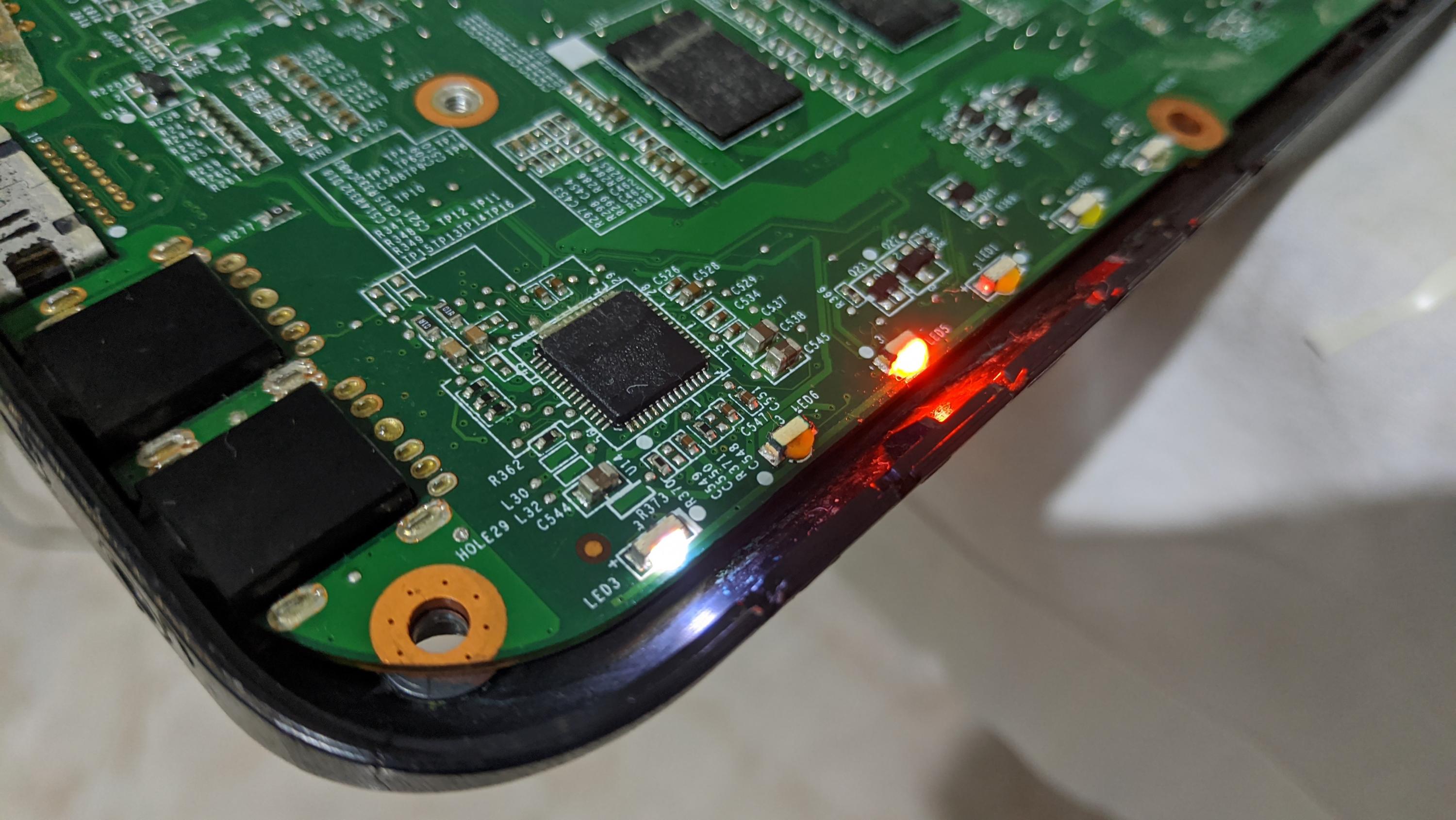

                    I desoldered the burned cap also from the ram (photo n1 first post), now it's not shorted anymore. Can it be used again without replace the cap?
                    EDIT: Oh, the board it's alive!
                    Leds turn on, hope that also the cpu, gpu, etc are fine. x.x
                    Will try all later!

                      Well...bad news...it's turn on, but is not POSTing... :'c
                      Just another led on, fan it's ok but that's all.
                      External display doesn't work also.
                      The notebook is on, also the hard drive, keyboard etc, but blocked before the bios.
                      Without the ram, it beeps (and it's normal), could this mean that the cpu is correctly detected (and it's fine) ?
                      I don't have any other cpu for that socket to test, but with different ram memory it still not POSTing (and no beeps).

                              Here some coil to ground tests:
                              -Mainboard with cpu and ram-
                              Code:
                              PL3   43 Ω   0.043 V
                              PL4  < 4[B][U]M[/U][/B] Ω   2.8xx V
                              PL5  3.3 Ω   0.005 V --- [B]CPU[/B]
                              PL6  3.3 Ω   0.005 V --- [B]CPU[/B]
                              PL7 322.5 Ω   0.378 V --- [B]RAM[/B]
                              PL8 > 16[B][U]K[/U][/B] Ω   1.043 V (near the ram but ???)
                              PL10 > 30[B][U]K[/U][/B] Ω   1.264 V (near the ram but ???)
                              PL9  10.8 Ω   0.013 V --- [B]GPU[/B]
                              PL11  10 Ω   0.013 V --- ?
                              -Mainboard with only the CPU (no ram)-
                              Just one coil is different.
                              Code:
                              PL7 553.6 Ω   0.445 V --- [B]RAM[/B]
                              • AidenX
                                • May 2022
                                • 40
                                • Italy
                                #35
                                Hi! I forgot to say the last voltage values was with the diode mode of the multimeter.
                                So i did the coil to ground tests again but with the DC power on this time:
                                -Mainboard with CPU and RAM-
                                Code:
                                PL3  1.002 V
                                PL4 < 0.900 V (starts from 1.1xx V and then slowly drop)
                                PL5  0.957 V --- CPU
                                PL6  0.957 V --- CPU
                                PL7  1.509 V --- RAM
                                PL8  3.354 V
                                PL10  5.086 V
                                PL9  1.113 V
                                PL11  1.112 V
                                Also is normal for this mosfets to have a low voltage (input to output) instead of 19V ?
                                Test between pins Source to Drain:
                                Code:
                                PQ18  [B]18.86[/B] V --- first main power mosfet
                                PQ24  [B]17.91[/B] V --- first cpu mosfet
                                PQ31  [B]17.75[/B] V --- first gpu mosfet
                                Thanks!
