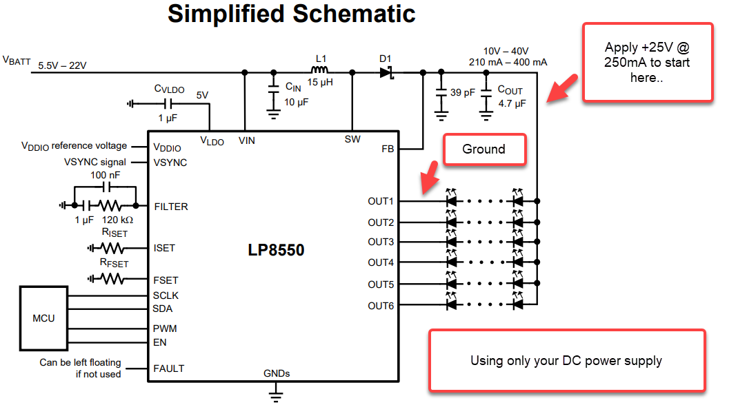

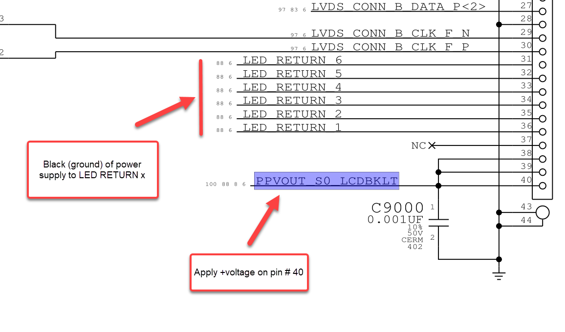

                Re: testing an LCD macbook A1286
                See attached.
                Suggest to start @ 25V and 250mA on your DC power supply.
                Test with only a single return line from the LCD display = GROUND it on your power supply.
                As per attached, each return line is the CATHODE (-ve) leg of the LED string.
                Then increase the current to increase the intensity but stay under the same range as the LP8550 backlight IC.
                For this test, you should only require 2 leads - for now, do not worry about the actual LVDS signals. Just want to see if the backlight can turn on which it should.
                Once one leg is confirmed to be working, move to a different return line = will light up another part of the backlight and so on...
                      Correct. This entire test is based on the missing backlight IC.
                      You will be using your external DC power supply and performing the job of the missing backlight IC. The difference is that your power supply will be considered to be 100% duty cycle = always full on. Where the backlight would have an adjustable PWM = variable intensity using the keyboard controls.
                      You can solder a wire to the backlight pin on the LVDS connector on the logic board = + for your DC power supply.
                      Then for the first return on the LVDS connector = - for your DC power supply.
                      This is much like a light bulb but has a polarity since they are LEDs.

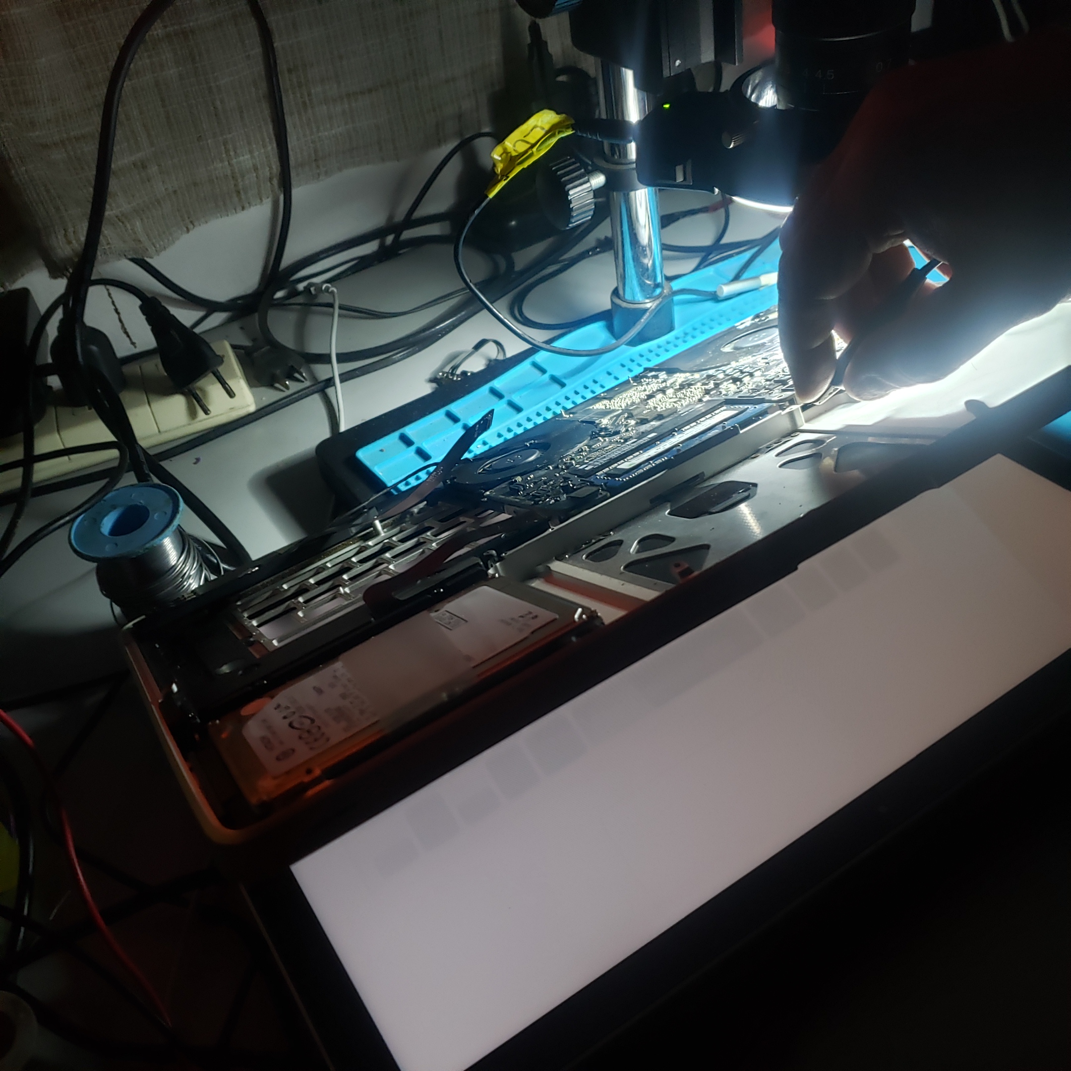

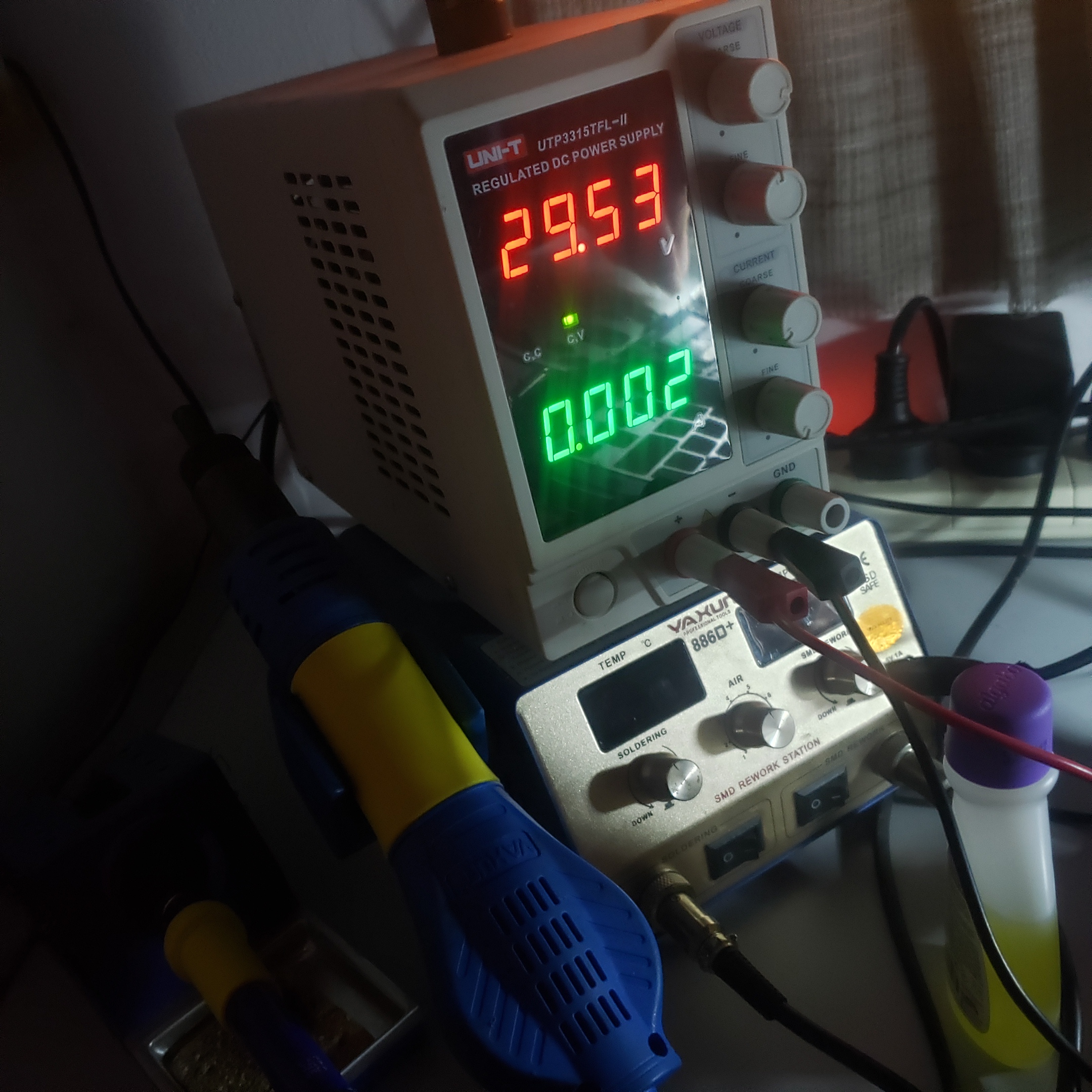

                        Nothing... maybe pwm "not being seen"... used 25v and up to 800mah (working screen off course) and nothing at all... 0.0000mah... used pin 25 (in the 8550) and all you ve stated...any hint?
                        Marcelo J
                        • mon2
                          • Dec 2019
                          • 14368
                          With 0mA current draw, the circuit is not complete.
                          On the same note, do not dial up the current so high else you will permanently kill the backlight strip. Stay within the range of the LP8550 datasheet since we know that works in the real world for this display.
                          The display is known good for the LCD graphics but also known good for the backlight ?
                          See attached and test again. It should work - personally have never tested it but it should function. You may have to increase the power supply voltage but if you do, again, keep the current down to not overshoot.
                          PS: The schematic / pin #s for the LCD connector were taken from the 820-2915-B schematic. Please confirm the same is present for the schematic you are referencing before proceeding.

                            ok ill try that way volt up and currwnt constant........ yes 2915b and of course yes it is a good screen (both backlight and image) i will report back ... thks
                            Marcelo J
                            • marce002
                              • May 2018
                              • 316
                              • Argentine
                              Yes!! worked at 29v and just 2mah was enough to see a nice white screen!!
                              thnks i will try more lines tomorrow... thks mon
