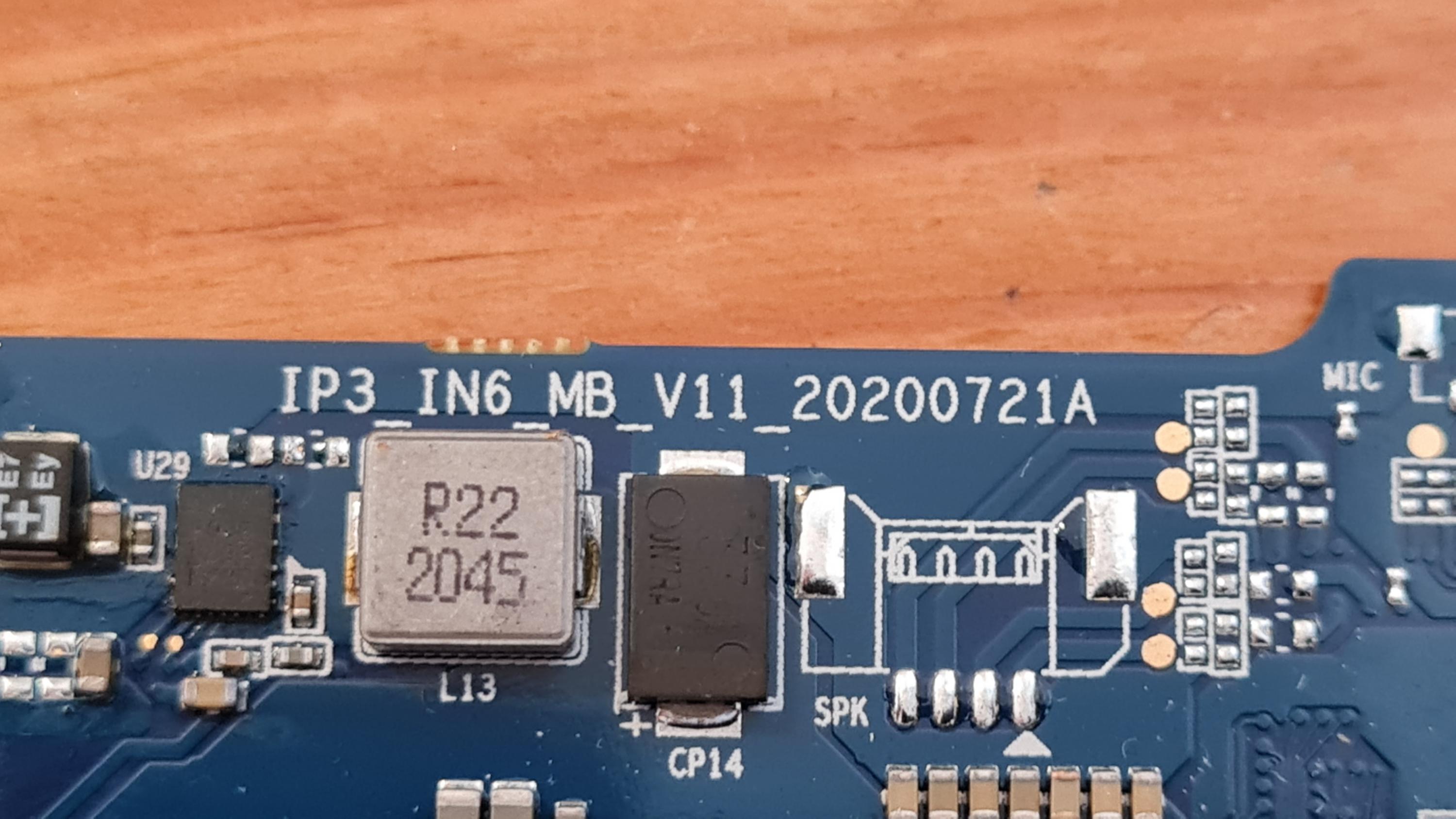

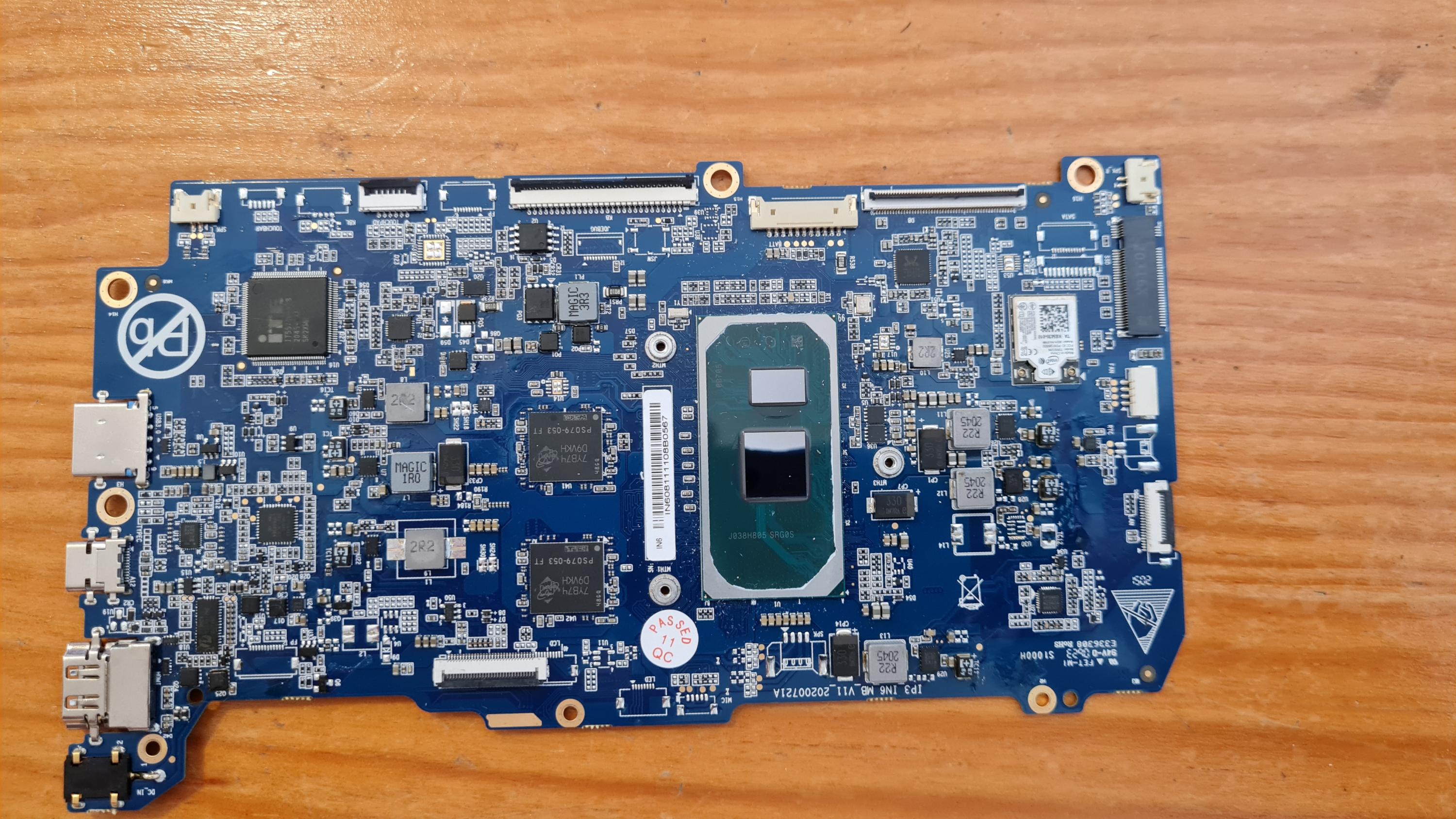

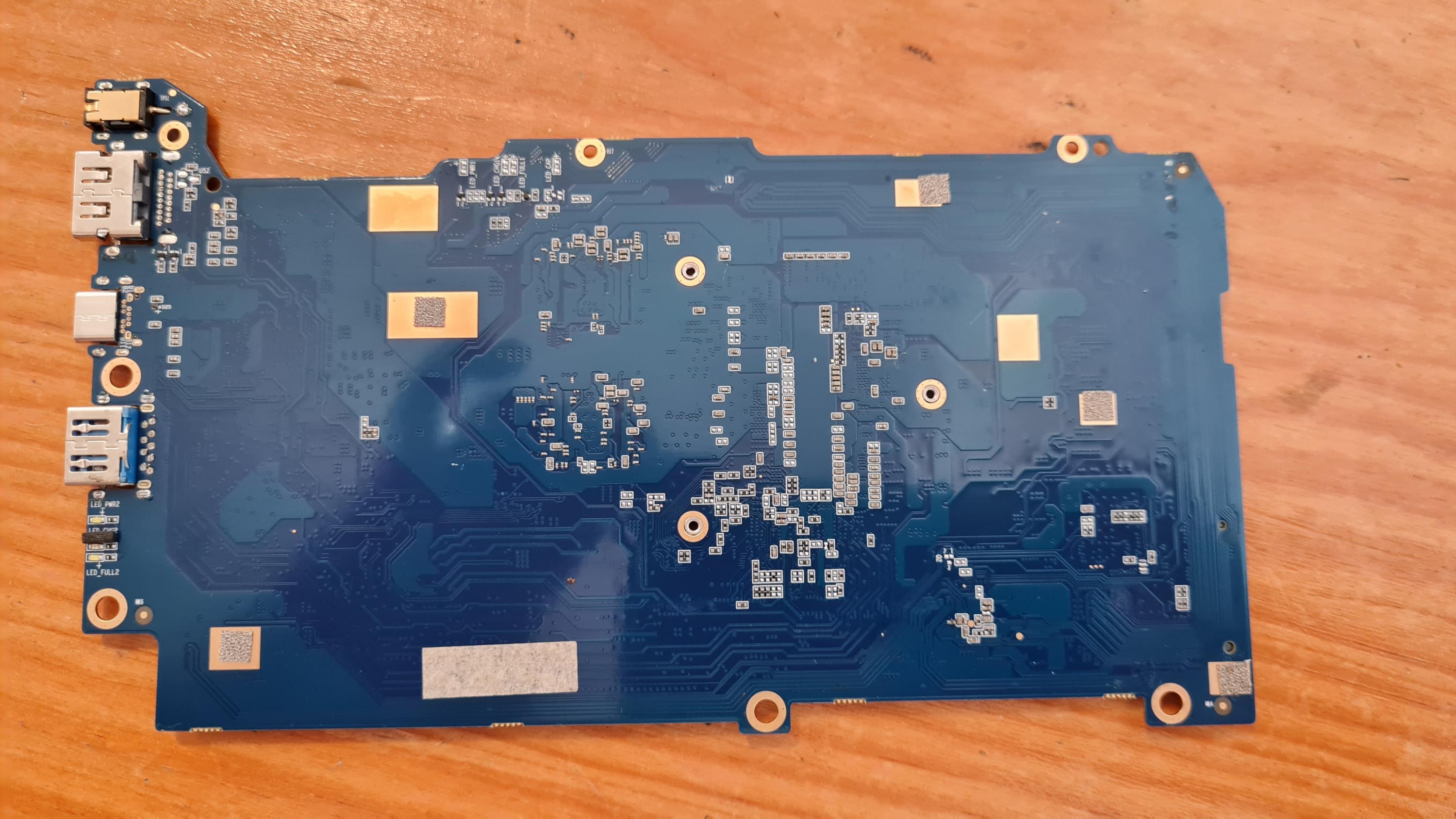

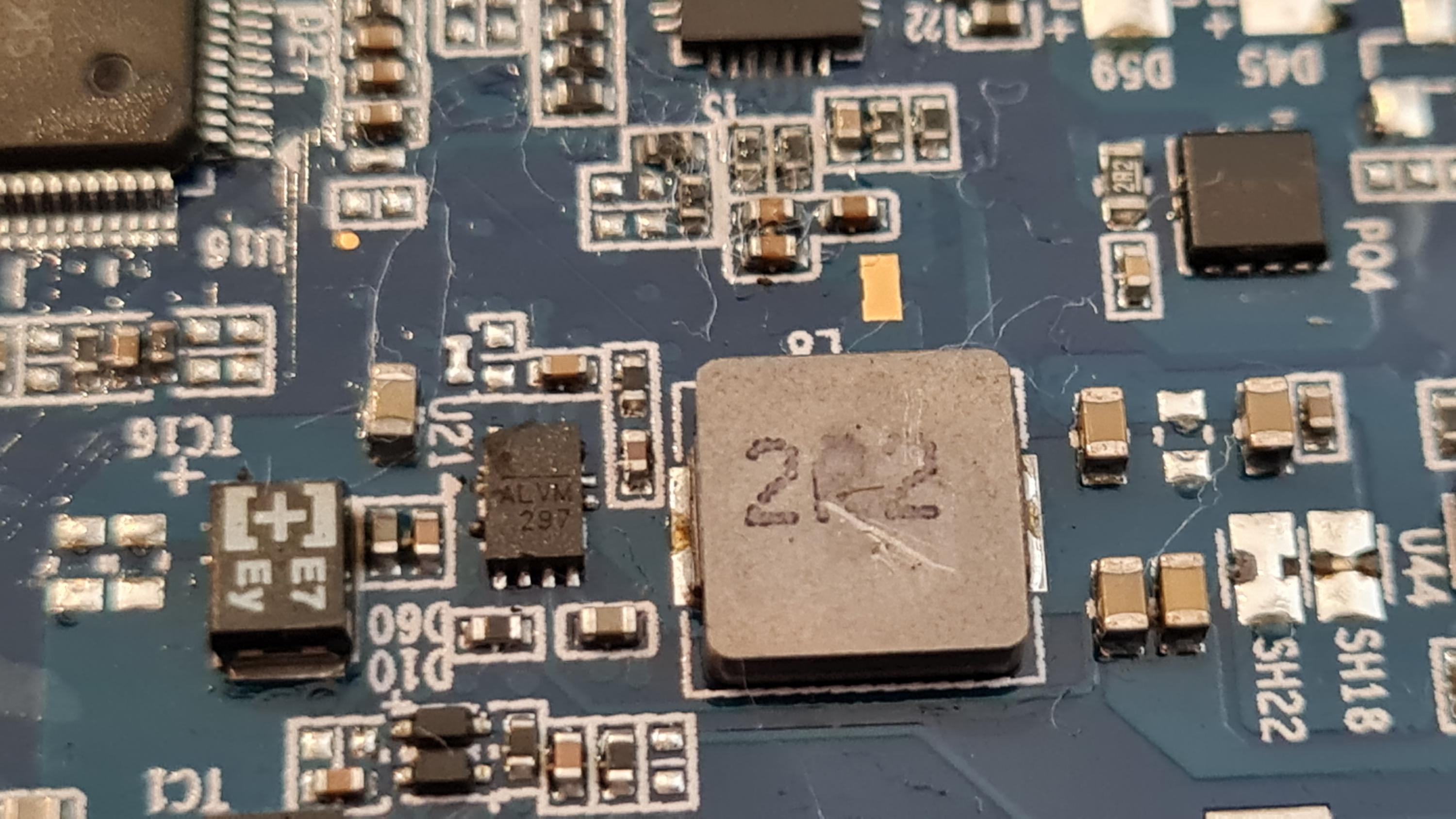

    Need some help identifying a component on an motherboard.
    Motherboard model is IP3_IN6_MB_V11_20200721A and I need to identify component U21 which is marked with ALVM 297. Processor is an i3-1005G1.

    p/n NB680GD-Z
    Datasheet is attached. Courtesy of thread up above by @SMDFLEA.
    https://www.aliexpress.com/af/NB680G...20220510092053
    PS: Do review the suffix to be sure it matches your original.

        Thank you very much.
        This will help me alot.
