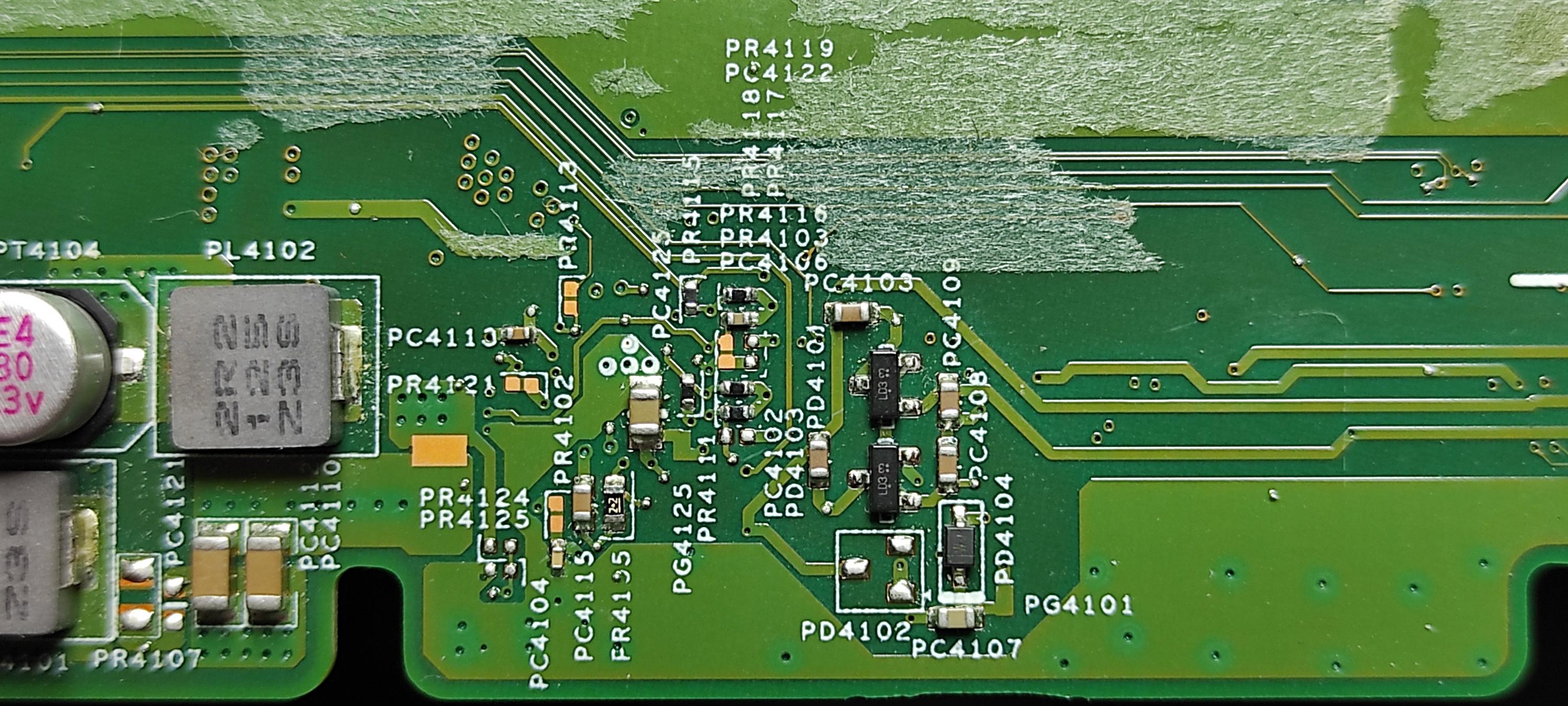

        Re: Dell Inspiron N5110 dead
        I feel a very light heat on this region of the MB, so oight that i'm not sure what component causing it.
        Perhaps is from the opposite side where these tiny FET are.

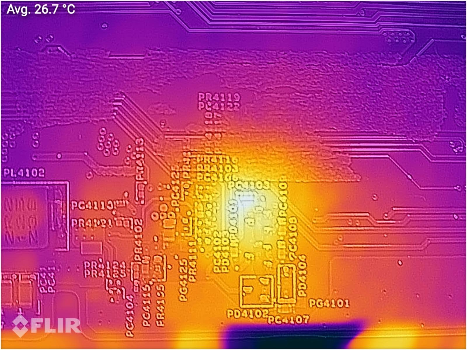

          Thermal cam indicates heat at PC4103
          What do you think?
          • Stevedb
            Stevedb
            • Feb 2018
            • 624
            • Belgium
            If the capacitor is heate you must reoved and test if short is gone
              I don't get it, the capacitor doesn't indicate short to GND in neither of it's pins or between it's pins.
              Why it's overheated?
              • Stevedb
                Stevedb
                • Feb 2018
                • 624
                • Belgium
                Because it is probably partial shorted. Has resistance a capacitor if you removed it must be Ol (open line )
                • Andreasbest
                  • Aug 2014
                  • 1196
                  • Hellas ( Greece )

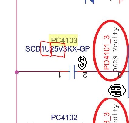

                  I'll replace it, what is the value or it?
                    • 21853
                    It says in the file name 1U 25V , so 1uF 25 volts
                    • Andreasbest
                      • Aug 2014
                      • 1196
                      • Hellas ( Greece )
                      You solve it my friend, looked like hieroglyphics to me
                      Going to replace it and come back with results.
                          Cap replaced, no heat now but MB still completely dead.
                          Other advises please??

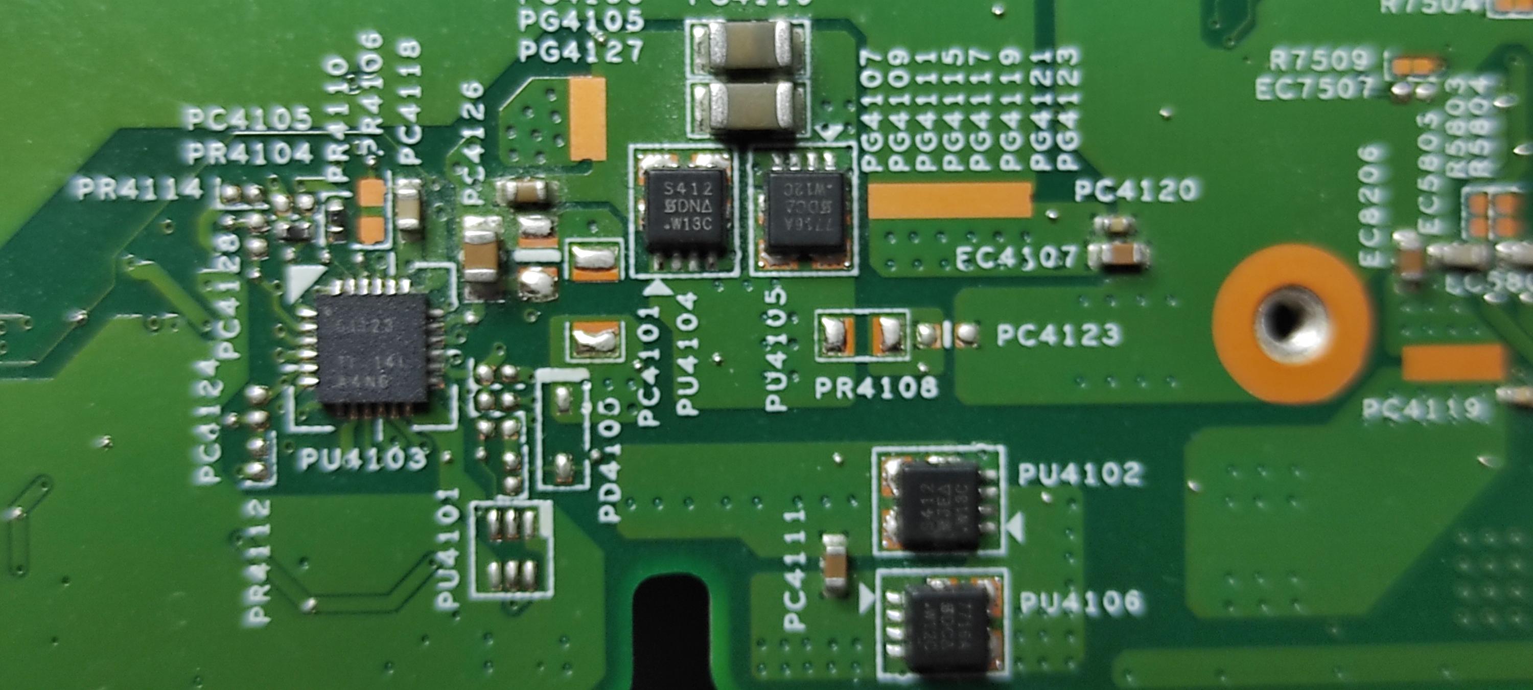

                                    Measure voltage on all pins of 3/5V regulator and post it here. What is the consumption on your dc supply in offline condition??
                                    • Andreasbest
                                      • Aug 2014
                                      • 1196
                                      • Hellas ( Greece )
                                      Ok i'll measure later.
                                      The dc supply stays on (Dell blue led), no shortcircuit detected.
                                      • Andreasbest
                                        • Aug 2014
                                        • 1196
                                        • Hellas ( Greece )
                                        You mean the PU4103 ?
                                        That's the only component where 3 and 5v are meeting.
