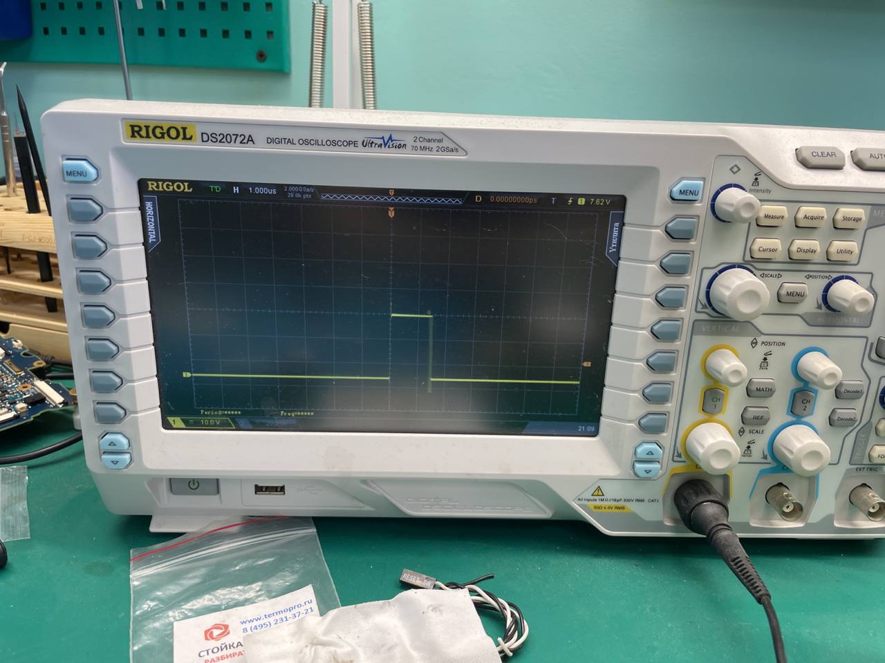

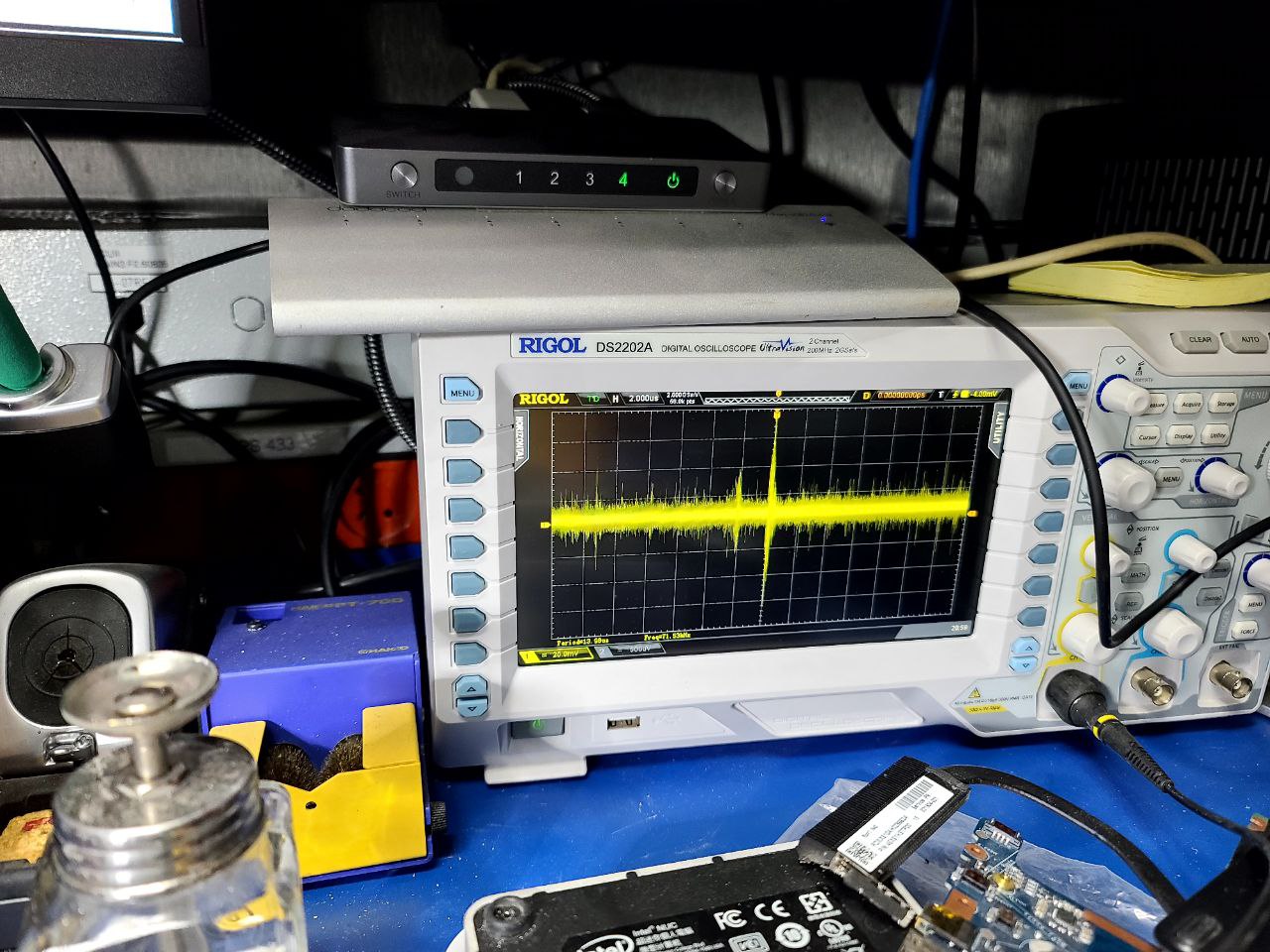

              Have another two LA-9591P mobos. Won't power on. There's 3 and 5V powered up, but no 3V on flash memory. In this case, check U45 3rd and 5th pins with oscilloscope. If you see sawtooth waveform - replace ECE5048-LZY, because the EC do not send signal to open U45 and U45 powered flash memory.

                How do you understand the problem was the EC chip? With the oscilloscope?

                  Re: Dell Latitude E7440 battery issue
                  The good signal should be looks like this one
                  And this one - what I see on the bad EC
