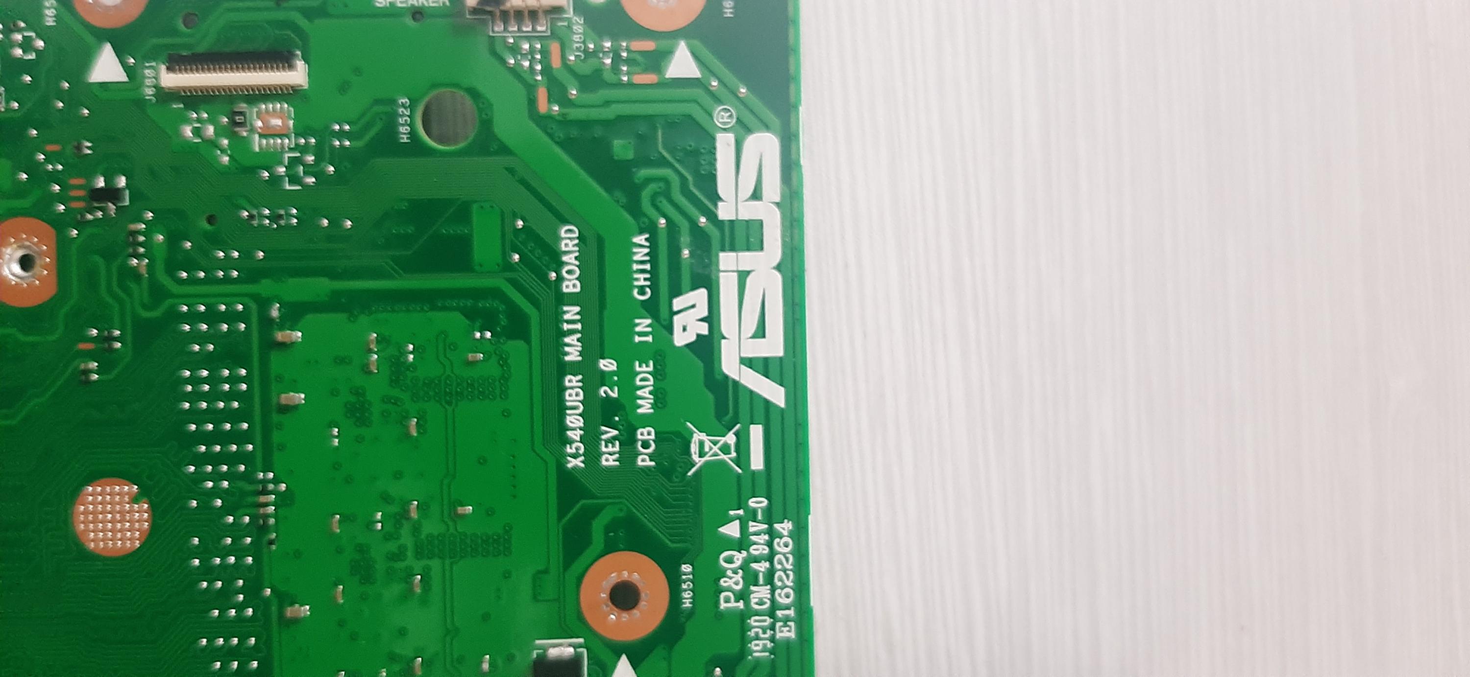

    hello.

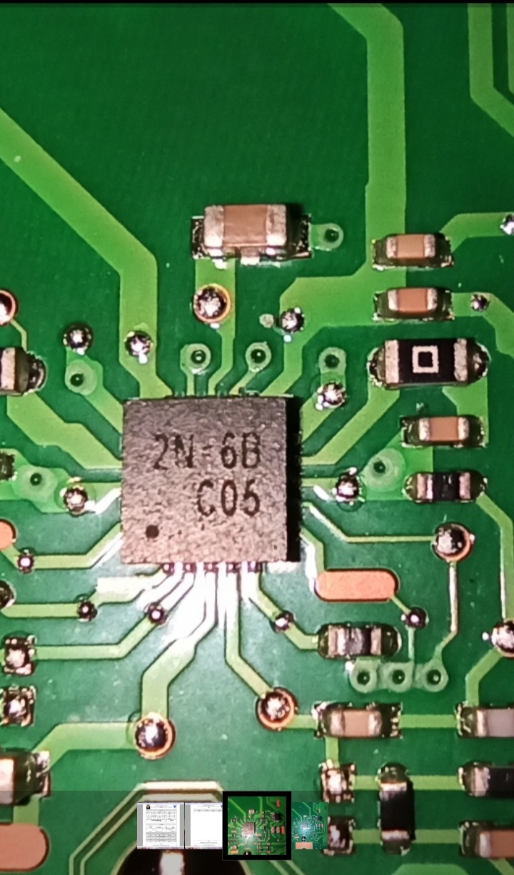

    I have an Asus K543 laptop that did not turn on without any special problems after the last operation. The motherboard was checked for short circuit and tin dead. There was no particular problem. Mainboard model X540UBR ver 2.0 All accessories including hard drive DVD burner and ... It is disconnected from the board, but the IC shown in the picture (probably the battery charger IC) gets very hot as soon as the charging adapter is connected, and since it may damage the rest of the circuit, I could not get much voltage. I did not find this model of mainboard, friends, please help. Thank you

    The part that is heating up should be replaced.
    Richtek p/n RT8249CGQW
    Datasheet is attached. You can source from Aliexpress.
    Be sure to buy the correct part with the same suffix in the part number. Also recommend to buy some spares.
    The part will have the same '2N=' markings on the top side.

      Thats not a charging IC but PWM controller for 3V/5V. You should check resistance on its LDO pins and if resistance is low,remove the IC and measure LDO pins again. If the resistance goes up significantly, the IC is dead. However, if the resistance doesnt go up after IC removal, your problem lies elsewhere(may be KBC) which we can tackle after your feedback. Dont put power to the mb when "2N" ic is removed,else it will become unrepairable.

        Thanks for your help. I measured pins 3 and 13 against the ground when the IC was on the board.
        Pin 3 resistance 1.49 k Ohm
        Pin 13 resistance 686 k Ohm

            Pin3 resistance is low and it stands for LDO3. Now remove the IC and recheck resistance on Pin3. If the resistance remains same(very likely that will be the scenario), something is shorted on that line pulling excess current and thats why the IC is hot.

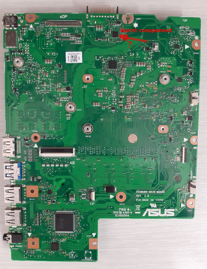

                          Hi guys, I need someone to tell me the number of this component, marked next to the battery connector, which is burned and I can't identify it to buy. ;-)
                          Identification in the photo of the burned component

                            Go here and download the boardview file for the logic board.
                            https://www.badcaps.net/forum/showthread.php?t=79704
                            Then locate this ic and see if it helps to identify the component. Looks to be the battery charger IC since it is so close to the battery connector.

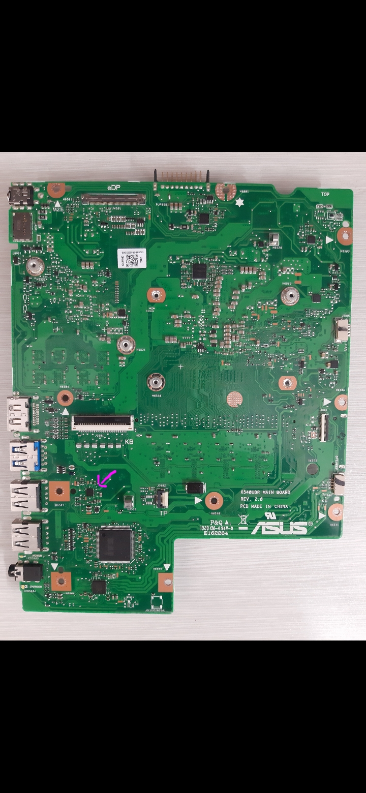

                                  Hi seg2, thanks for the program that opens files with extension ".fz", I found that this CI does not have in the files "Asus_X540_BV_Files.zip", it seems to be a PWM battery charge CI and only the end of it is left ".. .780S" 28 pins (7pins x 4)

                                    Re: Sudden shutdown of the Asus K543 laptop
                                    See attached. This could be your charger IC.
                                    You can buy it from AliExpress.

                                      Hi seg2, there's no way to thank you, I save a customer, thank you very much.
