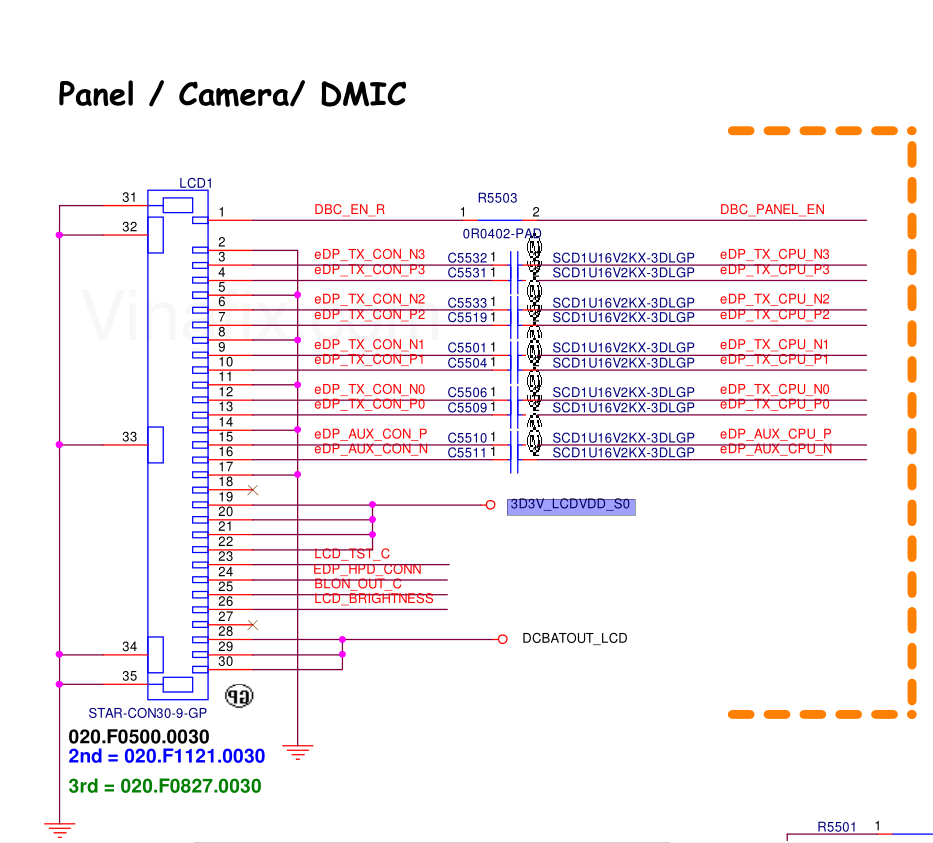

    Hi I've got dell with no backlight
    The display is pitch black but if I shine light into the panel, I can see image just fine.
    I have check lcd LED power fuse, ok, voltage is around 8volt.
    I don't know which pin is lcd backlight enable, so if anyone know, please.....
    Since it is 2 in 1 touch , lcd panel is strongly glued to top panel, it's hard to take of and probe the lcd connector directly....
    There is possibility that Lcd inverter MOSFET could be bad, which is a nightmare to replace, since I need to teardown the upper panel and LCD itself...
    Any help appreciated.

    See attached. Meter in DC volts scale.
    Measure the voltage for pins 1, 19-30. The pins 2-16 can be skipped since you can see the graphics / text on the screen with a flashlight - so the eDP data lines are working fine.
    Post your measurements.

        Re: Dell 7391 2 in 1 i5 10th gen
        Here is the measurements
        30-28 8.2v
        27 x
        26 1.5v
        25 3.1v
        24 2.3
        23 0v around 125ohm to ground
        22-19 3.3v
          Pin26 needs to be 3.3V.
            Edit
            Wrong measurement
            Pin 26 is around 3.1v
            So does this mean I need to disassemble the panel ?
              So after opening the panel there was indeed blown fuse inside between 8v.v line and led driver. Luckily no short on the driver. Phew....... Replacing that fuse fixed it
              Thank you all guys
