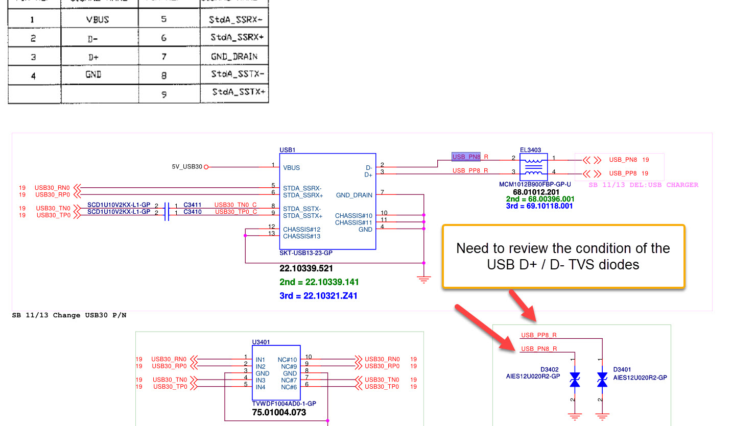

    It is odd that all USB ports are appearing to be defective.
    Remove power to the logic board.
    Meter in resistance mode.
    See attached. Check the resistance to ground for the USB D+ / D- ESD diodes.
    Red meter probe on the D+ & black meter probe to ground.
    Repeat for the D- line.
    Post your measurements.
    Your load switches appear to be working but can you confirm, the voltage of Vbus after you dock the USB keyboard ? Curious.

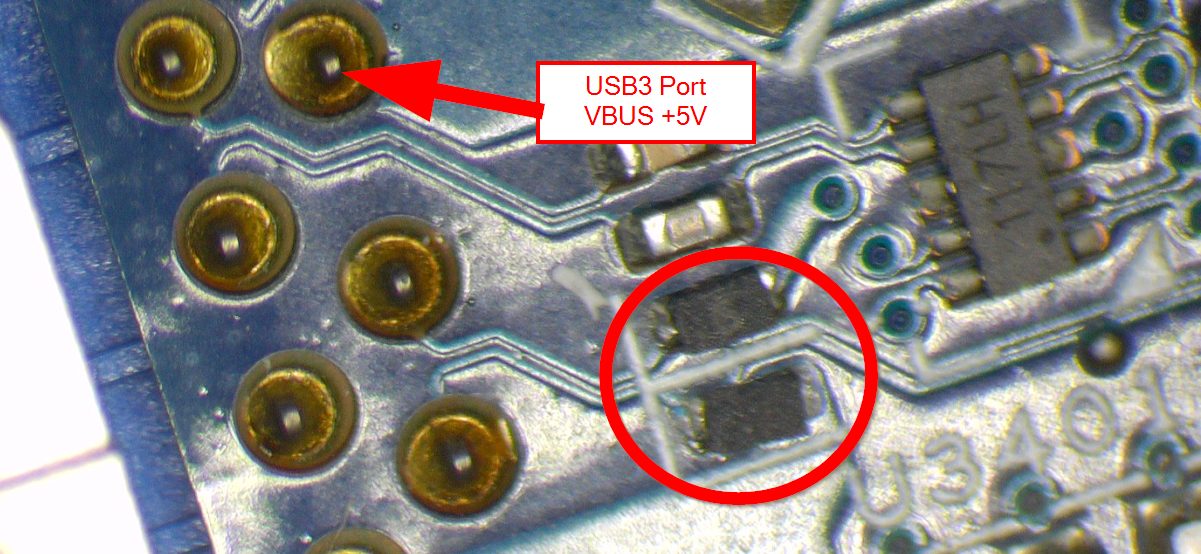

      first of all, thank you for you support, I just measured the two diode and i found that both are around 0.5V (diode mode)
      Just to be sure that I checked the right components.. are the two diode in the attached picture? sorry if I ask but I don't have the boardview and with a visual inspection, I can't find any component with D3401 and D3402 i just use some intuition.. These are my first repairs attempts :P
      (sorry for the picture quality... I do my best to take the picture :P)
      for the Vbus i measured 5V on pin shown on picture... I'm also not sure that is the right one..
