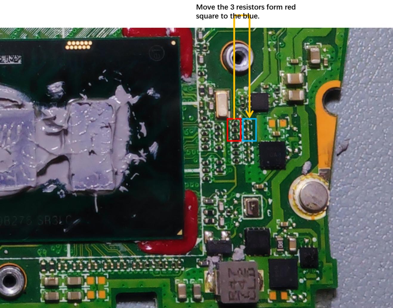

        I have done the ram upgrade.
        The origin mem IC type is SKhynix H9CCNNNBJTAL*4. I buy the SKhynix H9CCNNNCLGALAR-NVD*4. And changed the chip. After that, change 3 resistors beside CPU. detail as the attachment.
        The MB support max ram 16G. I upgraded it from 8G to 16G.
        For now, IT works well.

          I got the x360 13-w031ng model and its also max 16GB possible. Are the resistors mentioned above the same for this model? if not where to find the schematics to find out the resistors to change?
          And alternative: Can I still try to replace those 3 resistors above. if theyre wrong. what would happen in worse case?
