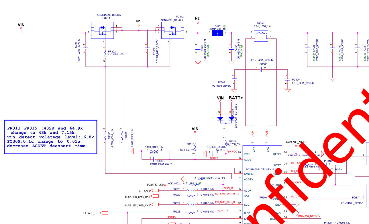

    Hi, I'm new to this forum, I registered because I have a problem with my laptop.
    It was recently acquired, broken, not working. First when I plug the charger, the charging light was amber, the led next to novo buton was white and the power button was on (led white). I measured de voltage at the battery plug and it was rising, after a while the charging light turn to white. No picture, no fan spinning, no backlight.First issue, with charger plugged in, the power button won't turn off(light). Only battery, the power button light is turning off when I press long. I did measure voltage on various point and I get something like this:
    PL1401-0v, PL801-0v, PL802-0v, Bios (25B64csig) pin1 3.38v, pin2 3.37v, pin3 3.38v, pin4 0v, pin5 0v, pin6 0v, pin7 3.38v, pin8 3.38v, PL302-0.82v, PL1001, 1003,1002-0v, PL402-5v, PL401-3.3v, PJ401,PJ405-20v PJ404-3.38v
    On the back I found:
    PL501-1.21v, PL500, PJ501-1.00v, PJ500-5v, PJ502,PJ510-3.38v, PJ503-2.5v, PJ511-1.79v, PJ504-0.6v, PJ506-20v
    All voltage measured without battery, with charger plugged in. From the schematic page 50 i understand that I get left side, first two up in the middle and last three bottom left power source working. What I have not working are the 4 power source form the middle bottom. On the KB connector I have pin 1 and 30-3.3v.
    What do you think, it is possible to have the EC cip IT8586e-fxa broken, or a power issue.
    Sorry for my long post, thank you!

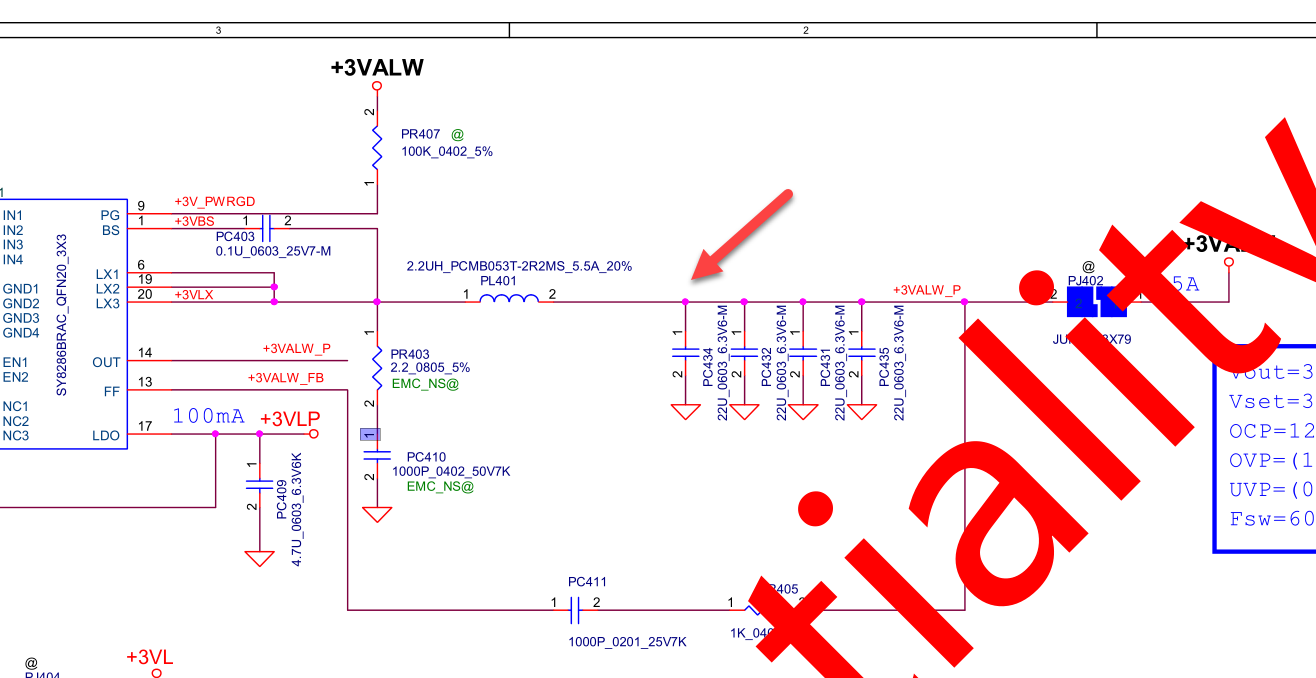

      Re: Ideapad 320-15ISK model 80XH, no picture, no fan spin, pwrbtn on, charge led on!
      Remove the battery.
      Post the voltage readings with the adapter for the first 2 mosfets.
      Do you see the adapter voltage after the first 2 mosfets ?

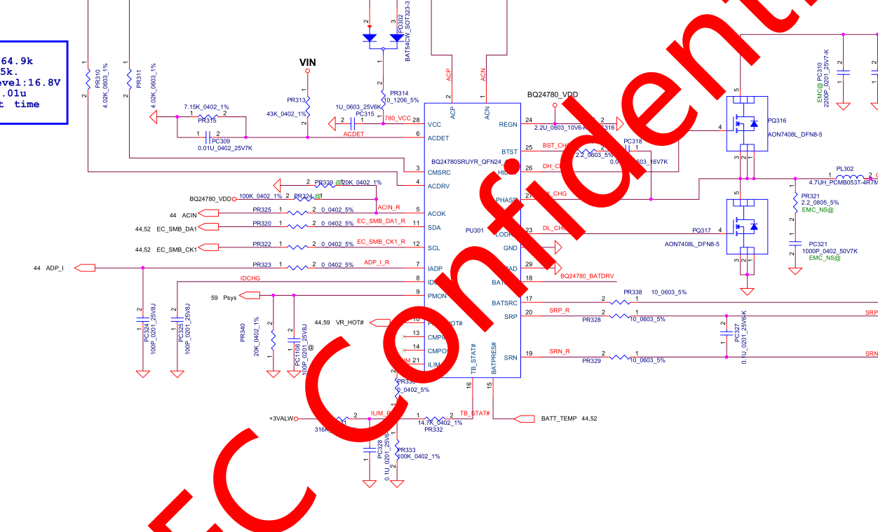

      if not, post the voltages on each pin on the charger IC BQ24780 (PU301).
      Confirm that PU401 is ON and supplying the +3 always ON rail. Often, this part is damaged.
      Check this rail @ pin # 2 of the inductor PL401.
        Thank you! With charger plugged i have the 3.3 and 5v on pl401 and pl402. I downloaded the schematics and I know where to look. If I put only battery i can make the power button to get on and off, but with charger it stays only on, no matter how long i press the power button. On the motherboard i don't see any mark's of burned components, i think i should see what power consumption i have on the charger plug. Maybe i have some short-circuit on the mainboard and the EC is not powering the last PU for core cpu, gpu and memory.

        • mon2
          • Dec 2019
          • 14175
          Often the areas to inspect are the first 2 mosfets of the charger IC.
          Remove the battery for now. Remove the power adapter.
          Meter in resistance mode (2k scale is OK).
          Check & post the resistance measurements for:
          source (1-2-3) & drain (5-6-7-8)
          source (1-2-3) & gate (4)
          gate (4) & drain (5-6-7-8)
          Do this for PQ311 and then PQ312. You may have a damaged mosfet which is just acting like a closed switch and therefore remaining always ON.
          If you read a low resistance for the above, then that mosfet is a suspect and will need to be checked out of circuit (remove it and check the resistance values again). Most likely will be damaged and needs to be replaced.
          Aliexpress is the best source for such parts but often the mosfets can be replaced with other compatible ones from Arrow / Mouser / Digikey / RS Electronics online stores.
                NM-B242
                DG421 DG521 DG721 rev 1.0
                I've checked the PQ311 and PQ312, each transistor have G to S and G to D OL and S to D and D to S one way OL and the other way I get the resistance of internal diode. There is no short-circuit on the fets.

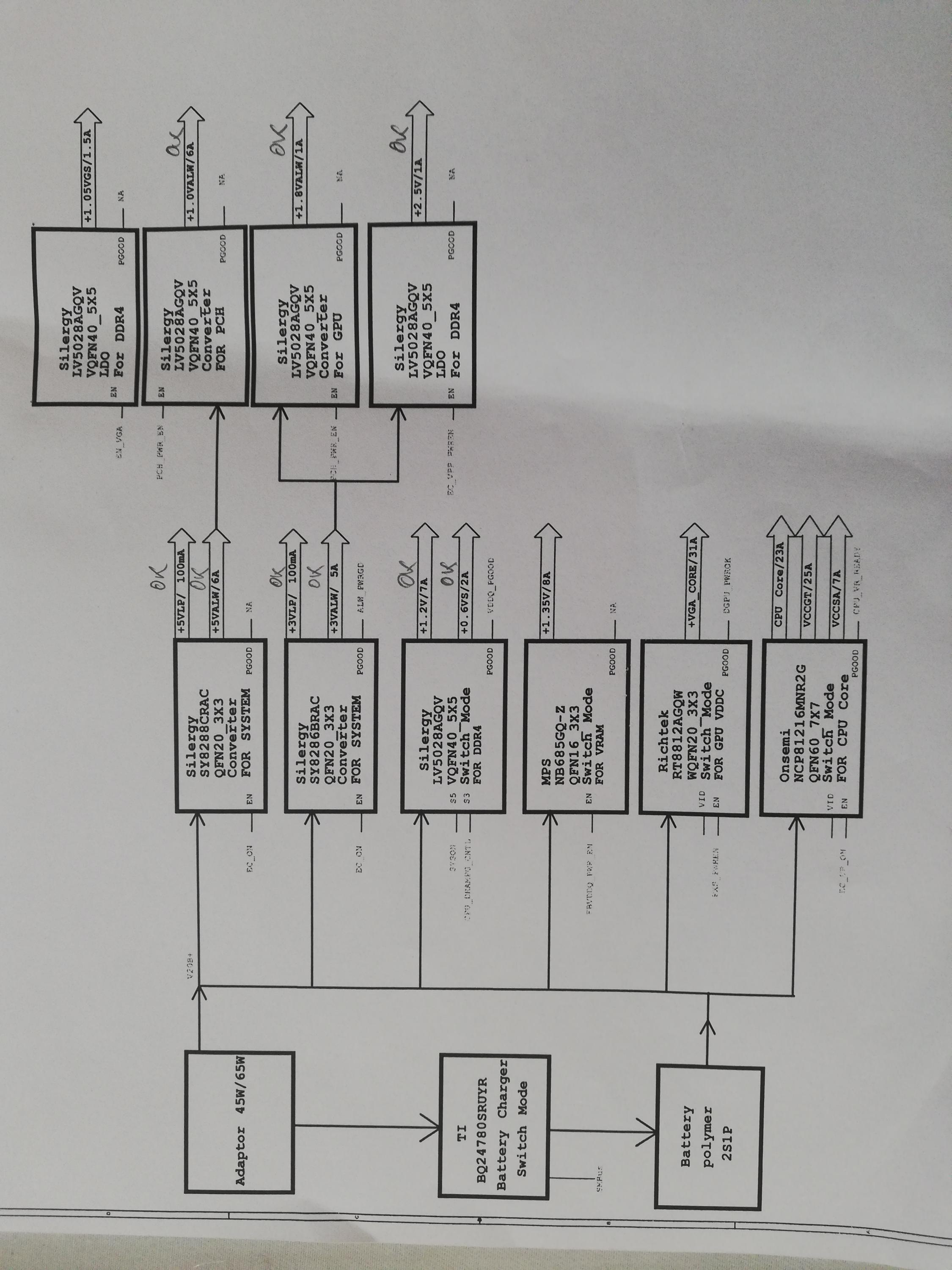

                        This signal is tied with DGPU_PWROK & FB_GC6_EN. Graphics chip generates FB_GC6.Pu801 generates DGPU_PWROK.
                            Hi, on the power-on sequence on page 47 it is specified a PU904 . I could not find it on the mainboard, maybe a typo, should be PU401 and PU402? I measured all the pin on EC and I have a bunch of voltage, all measured with PWR-BTN ON , what should I compare, for instance I have 0 V on pin 33 which is tied to a resistor of 7.14MOhm at 5V, on pin 35 I have 0,44V, DPWROK_EC, I think it should be 3.3V for the PCH and so on. On KB connector on mainboard side I have 3.3V on pin 1, on pin 31 I have 3.3V, when I short this pin to ground I can cycle between ON and OFF. Pin 110 stays at 3.3V no mater what I do on. Any help please.
                            • ArchangelGabriel
                              • Feb 2022
                              • 37
                              • Romania
                              Short update, I've searched on the mainboard for U13, it's switching from+3alw and +5alw to +3 and +5 vs, no output, susp# is missing, after i made some short from susp# pin on EC to 3.3V the fan start spining and the CPU and GPU is warming up. I will put the heat pipe on place and further investigate.
