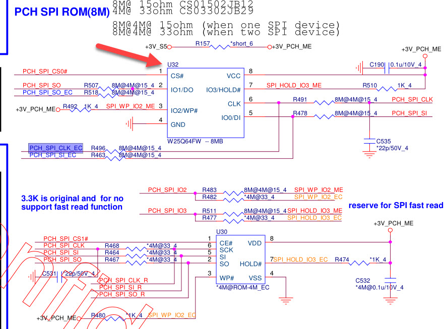

              Does your schematic reference the same SPI Flash as attached ?

                Re: Acer E5-771g Black screen
                Yes bro spi placed on same place (U32) 8mb flash and resistor present and ok on r507 14ohm.
                only difference is that my chip is 25Q64FVSIQ.
                i have tryed all online availible dumps but same problem.
                • mcplslg123
                  • Jun 2015
                  • 7262
                  • india
                  W25Q64FW is 1.8V bios chip
                  W25Q64FV is 3.3V bios chip
                  So not compatible. Change the bios chip as specified in diagram. You may need a 1.8V adapter to program bios chip.
                      mine is W25Q64FVSIQ =3.3V and it looks like this chip Set by Factory on this board (No new soldering traces on it) i think your Schematic is from Rev 3A board and mine is Rev E

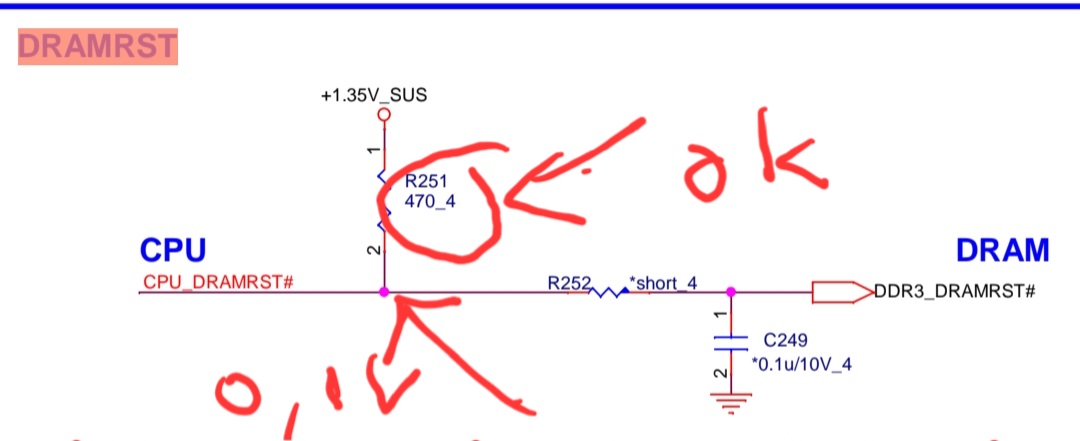

                          • Ariu
                            • Dec 2020
                            • 138

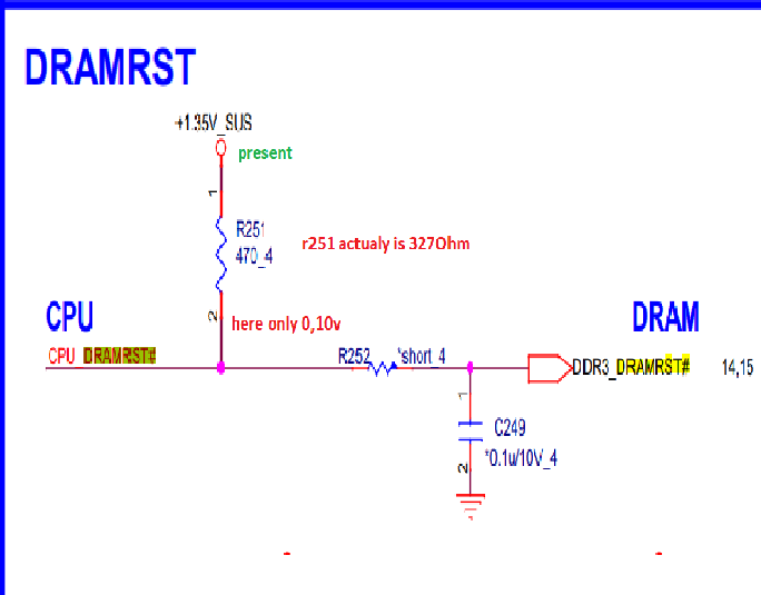

                                • Ariu
                                  • Dec 2020
                                  • 138
                                  Too early to jump to any conclusion. DRAMRST# will be pulled low if bios is corrupt(Though there are many many other reasons). Since your bios chip is not as per specs, you wont get dramrst#.
                                  DRAMRST# is also missing in my fall , i get only 0,1V.
                                  U12 is also ok .
                                  What can be the reason of this low voltage (suspecting 1,5V?), because i can not find any other references...
