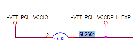

    Hello guys,
    what exactly are components that start with SLxxxx, it seems they are just wires. Not sure what is their role on the motherboard. There is an example in the attachment.
    I hope someone can clarify this.
    Thank you.

    Re: Schematic components with mark SL...
    I do believe that these are like testpoints?!
      Yes - they should appear as blobs of solder or maybe a component which will be like a 0 ohm resistor = short circuit across the pads.
        Thank you guys.
