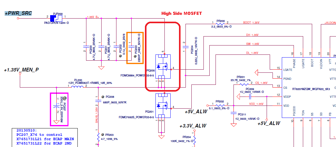

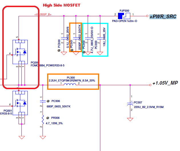

                Yes, that is true. If Gate is shorted to D-S that it is most probably hit by some higher voltage. This means that IC chip (driver) could be bad. ON the other hand. D-S short on high side MOSFETS are very dangerous for the rest of the circuit, because it can send much higher voltages on low voltage power rails.
                Please have a look at the attached pictures. In one case 1.35V is produced from the PWR_SRC (can be 12V or higher) and in other case 1.05V is produced.
                High side MOSFET D-S short can cause 10 times higher voltage to hit that rail and all components on it.
                  Well i measured 19v around the MOSFET I found bad, so that's not good news. Now it seems that I have many dead mosfets, found at least 3 on different positions that show really low resistance between s&d. I tried to disable them by touching dmm's positive to gate and negative to source and even to the ground.
