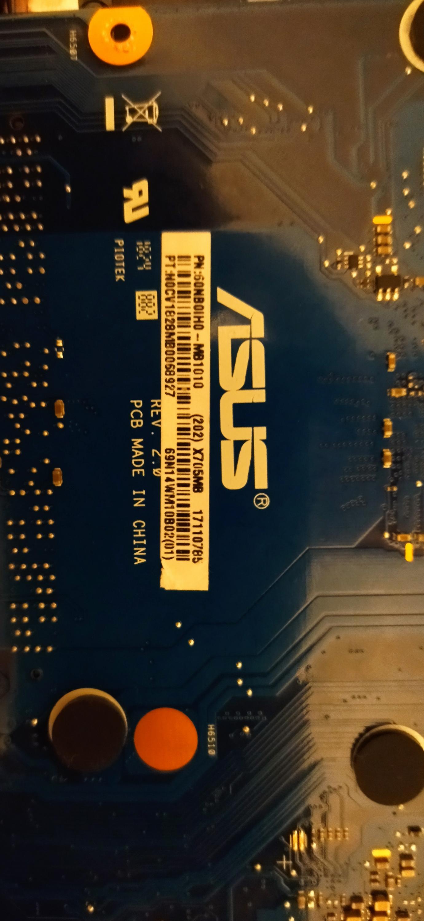

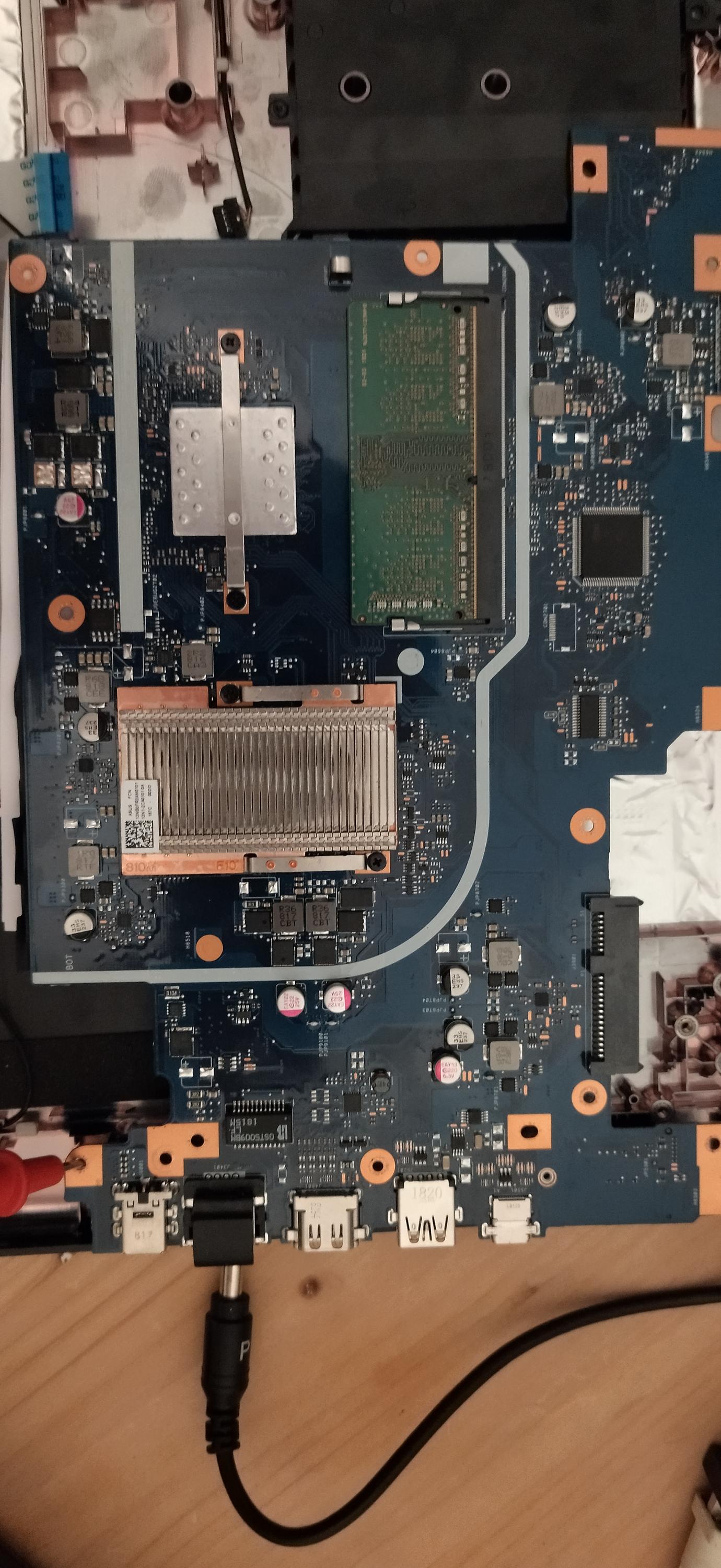

    Hi everyone,
    I have an Asus x705mb at my hands, that powers on but doesn't start. I read the beginner's guide as i'm not really experienced in repairing motherboards and i can't find the board's schematic but i tried to get vcore voltage, which i'm not sure where to measure, i'll add a picture about this.
    The notebook was hit hard in the middle of the keyboard, the housing shows heavy damage, but the board itself looks totally fine.
    The memory used is working, i tested that in another board.
    The CPU produces heat over time, and the fan is running when required.
    Charging works as intended.
    My first guess was the bios, so i started with searching for and writing a working dump on the chip. I attached both the original dump and the one that i tried. Unfortunately it didn't help. But caused a minor difference: with the original bios it restarts like every 10 seconds, with the new it doesn't do that.
    Other than that, sata seems to have no power, usb port have, but bios crisis recovery never seem to start.
    What i'd like to ask of you:
    - Is the original bios ok or can anyone help me fix it?
    - Schematics if anyone has
    - Ideas, to continue
    The board is important only, because the hard drive that was in the computer has bitlocker on it and we don't have the recovery key.
    I'm not a professional, and not working in this area at all, but measuring, soldering and coding is isn't a problem and my curiosity about this is just endless.
    Thanks in advance for any help!

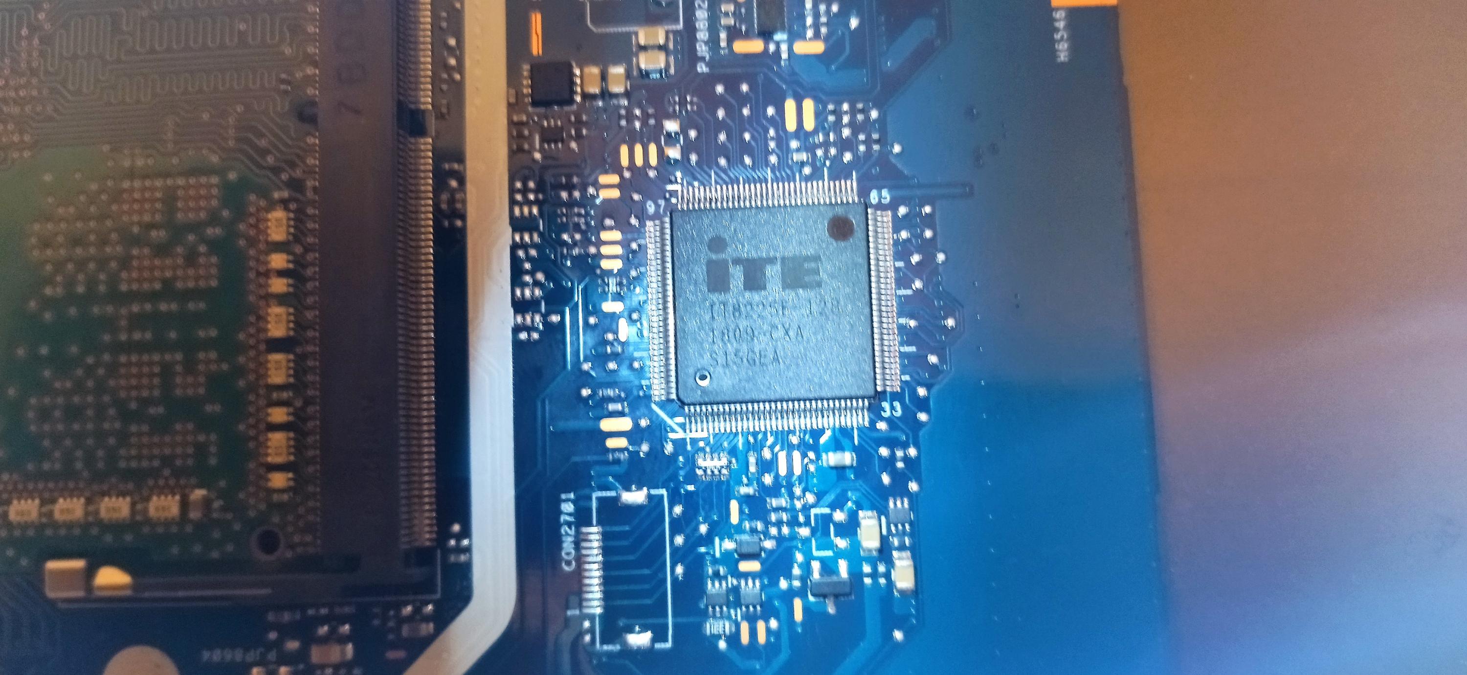

            Based on the pinout of IT8225E found in this thread i measured a few pins that looked interesting in the pdf and in this thread

            The pdf seems to contain a few values measured by the owner of that pdf, my values differ here and there.
            Which values are wrong and what could be the reason?
            • piernov
              • Jan 2016
              • 4439
              • France
              Re: Asus X705mb - not turning on
              Most pins are GPIO, assignment can be different between platforms. No way to know correct pinout without having schematics or boardview of the board, or at the very least a very similar one.

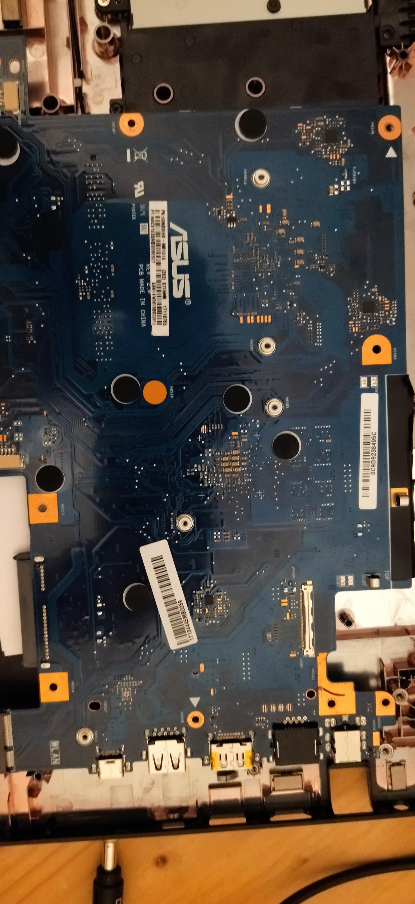

                  I removed the heatsinks and checked what hardware i have, and it seems that this X705MB has 920MX somehow, i cannot find any other X705-GC030T with that video card.
                  the exact type of the motherboard is: 60NB0IH0-MB1010
                  Is it possible that the bioses that i wrote on the chip expect an MX110 (that all GC030T has based on google) and it cannot start?

                    Check all power rails at the coils
                    I had a similar board which had the same symptoms after a Bios Update from Windows Update. One rail was missing but I never solved the issue
                    Probably bad KBC flash in my case
                    That was my thread
                    https://www.badcaps.net/forum/showthread.php?t=99527
                    Does your unit also blink?
                    Does it react to capslock on/off?
                    • reformatt
                      • Feb 2020
                      • 1507
                      As it stopped working after a physical impact, then it's not likely to be BIOS. As ASUS motherboards rarely have any schematics available, I always start by a physical examination of the board under a microscope. Somethings which aren't visible to the naked eye stand out like dogs balls under a scope.
                      As the board has physical trauma, I would focus on the centre of the board, nudge each passive component with the tweezers to check for broken solder joints (mainly 0402/0603 components), Also check the bare copper test pads ASUS use on their boards. As they have no mask, they are the first things to get corroded, especially under the fans etc where dust may accumulate. Fixed a lot of ASUS boards with corroded test pads.

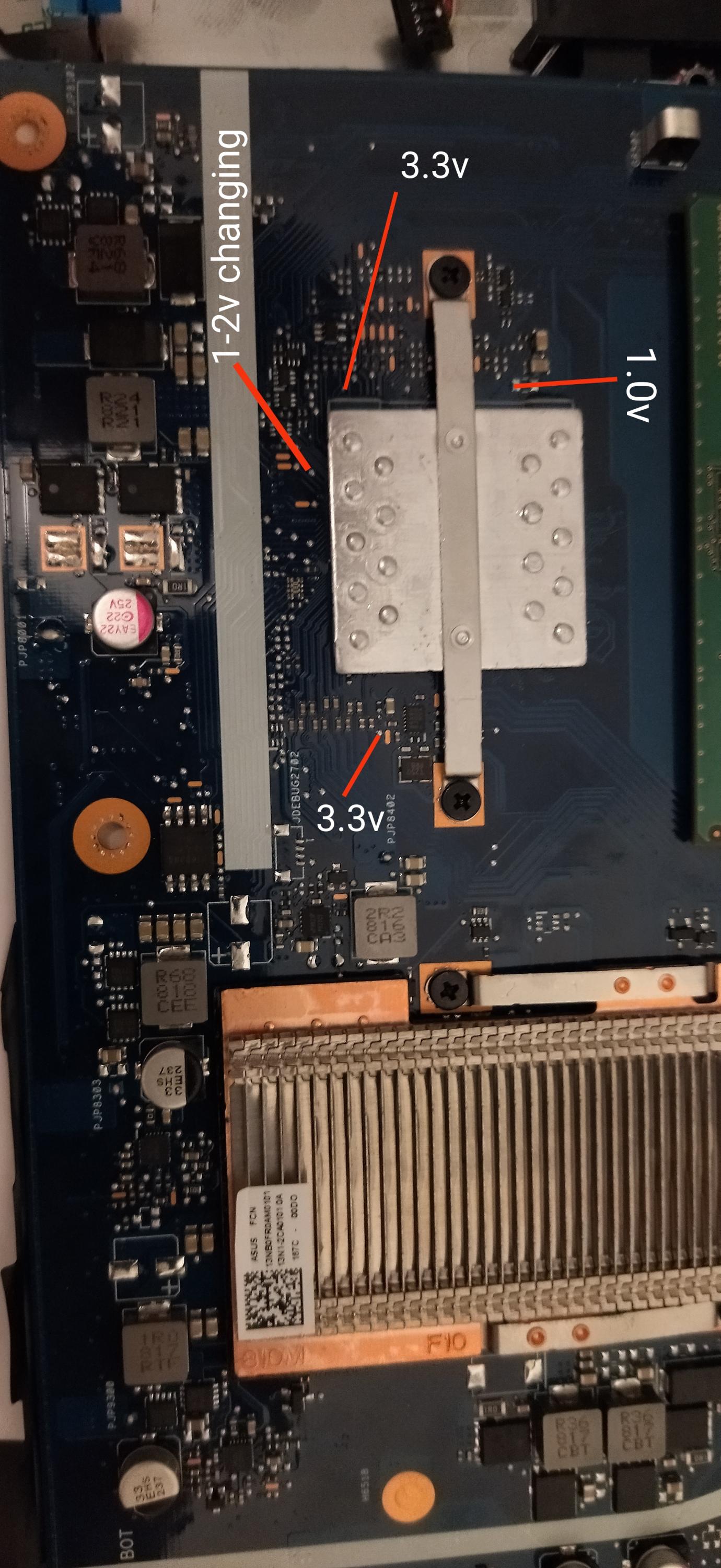

                            Is it normal for ceramic capacitors (around the CPU ,under it) to show 0-1 ohm resistance to ground on one side and 20-40 ohms on the other?
                            Edit: also many inductors seem to show close to or 0 ohm resistance to ground

                                Normally all ceramic capacitors have one side on ground, so 0 ohms on one side is normal.
                                A low reading on the coils near the cpu is also nothing to worry about, but below 1 ohm is too low..

                                    It seems I have finally found a dead MOSFET drain shorted to source and probably a bad ceramic capacitor near the MOSFET that seems to show infinite resistance.
                                    • Adenitz
                                      • Jan 2021
                                      • 122
                                      • Congo
                                      When measuring resistance between drain and source of a MOSFET and the value is small (ohms rather than k ohms), then the MOSFET is bad.
                                      If you measure resistance of a capacitor and it is infinite, then most likely, the capacitor is good. When capacitor fails, it goes short, when resistor fails it goes to infinite resistance. Keep that in mind.
