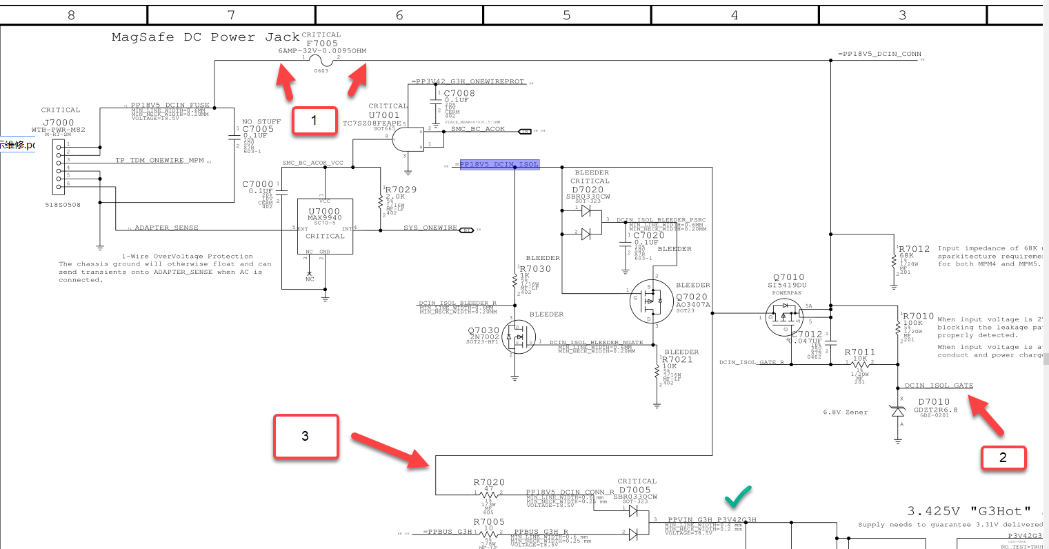

    Hi.
    1) Can you confirm your logic board # ? Believe it is 820-4924 ?
    2) See attached. Post the voltages for the requested area.

      1 Both sides of DCIN fuse F7005 Is same value. ~0.47V (going up and down sometimes between 0.6v - 0.4v
      2. Pin 1 (and 2) on R7020 = Close to 0V ~0.0x...V
      3.Same as F7005 on TP_DCIN_ISOL_GATE between 0.6v-0.4v
