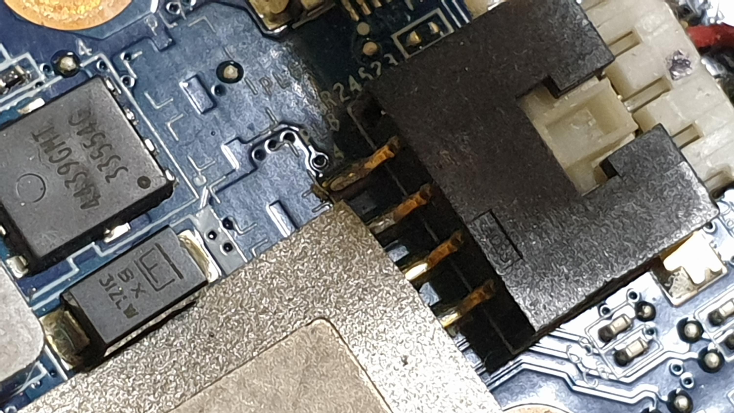

    I opened a sony vaio flip SVF14N because it has no power and when checking the power jack i am able to see 19V.
    I am wondering if this part is a fuse or not. Kindly let me know.
    It has a marking of BX 31ZL with big F but i am not so sure about it.
    Really appreciate your help.
    If it is indeed a fuse kindly provide me the specs.

    Its made by littlefuse (capital L with a capital F inside) .Not sure what it is yet,could be a TVS diode.
    Edit: littlefuse SMAJ22A ,marking BX https://www.littelfuse.com/media?res...smaj-datasheet
    SVF14N schematic https://www.badcaps.net/forum/showthread.php?t=66994 ,PD5 page 28 - Diodes Inc SMAJ22A-13-F https://pdf1.alldatasheet.com/datash...J22A-13-F.html ,marking IX

      Thanks for your very accurate reply, indeed it is a diode.. i tried to take this part out and found a marking underneath it as a diode hence i tested and re-soldered it back because it was working fine. I also tested all the fuses i could find on both sides of the motherboard and all are good.
      On the other hand, I just cleaned the thermal paste which became crappy and could short out some parts since it was scattered on the processor out to the PCB. I then replaced with a small amount of arctic silver and also tried to clean all the motherboard parts.
      I was amazed it booted normally and was charging normally.
      What went wrong, still i cannot explain it. I was really surprised it boots up and run normally.
      I still dont know what caused the NO POWER, NOT CHARGING issue. but i guessed cleaning solved the problem. Switched on my laptop for the whole night and already get 100% batt.
