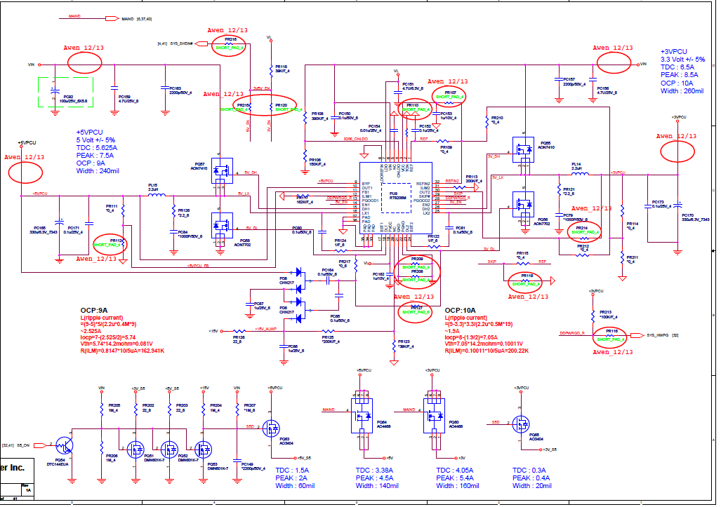

    I Have a ACER TravelMate 5360 dead
    DA0ZRJMB8C0 rev:C
    with the AC adapter plugged and battery i have a orange charging light , but no post, not turning on
    Schematic attached
    voltage present:
    EC bios u23 3v
    Main Bios U27 0v
    power button SW1 3V
    pq60
    +3VPCU 3V
    +3V 0V
    MAIND 0V
    if i understant will for activate +3V i need MAIND and it come from pq45
    PQ45 pin 1 GND- pin 2 6,4 v- pin 3 MAIND 0v
    any idea?

      This is the explaination of this circuit
      Before trigger on : pq46 is off , pq37 on ,pq40 on , pq42 on , pa41 on , pq45 on = maind 0v
      When trigger on : pq46 is on , pq37 off ,pq40 off , pq42 off , pa41 off , pq45 off = maind 12v
      Start with PQ46 , if when trigger on you still have 6.4 v ( voltage divider you must find 10v and not 6.4v) than pq46 still off so chang it
      nb : i presume that when trigger on MAINON is rising = 3v
