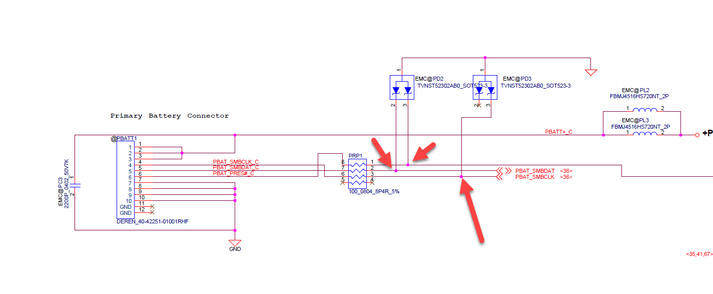

    Hello!
    I have 2x Dell Latitude 5570, both came without batteries and cables, so i bought 2x cables (from China) and decide to use them with 2 batteries i already own from other laptops, one genuine Dell and one OEM (Green Cell).
    In my surprise i noticed that both laptops indicating both batteries as "No Genuine Dell Battery", i'm out of ideas as i have never faced similar problem before.
    Is there any chance the chinese cables to cause the problem?
    How can i test them?
    Thank you in advance!
    Schematic: https://www.badcaps.net/forum/attach...9&d=1623062271

    Batteries these days are 'smart batteries'. These slave devices communicate with the SMBUS (I2C) bus master (host CPU) to relay blocks of information including the # of charges; capacity; serial #, etc. and unique vendor IDs.
    Unless these details are spoofed, the target 3rd party battery will appear to be a fake.
    The communication lines are the:
    PBAT_SMBDAT
    PBAT_SMBCLK
    Using an I2C bus analyzer, it is possible to snoop on the traffic between the battery & the host.
    It will be easier to just find a compatible battery that will offer a BMS (battery management system) that will then spoof the required data. No idea on the quality of the battery chemistry but at least the above alarm message will be resolved.

        What are the details of this Chinese cable ?
        Can you post a quality picture or maybe a pinout diagram ?
        Also, on the laptops that are NOT working with this battery & cable harness, use the meter in DC volts mode (20V is ok) and confirm the voltage readings on the SMBUS pair of pins used for the battery interconnect.
        The SMBUS cannot be stuck for this all to work. You should see ~+3v3 on each SMBUS pin - please confirm this very important detail.
        Then attach the battery & cable harness - measure the voltage on the SMBUS lines again. They should remain @ ~3v3 which denotes open-drain pull-up resistors are doing their job.

          SMBUS is on PL2 & PL3?

            See attached.
            Measure and post the voltage reading for each of these lines (WITHOUT the battery & cable).
            Then repeat the voltage measurements WITH the battery & cable.

              Trying to locate this PRP1...
              • Andreasbest
                • Aug 2014
                • 1193
                • Hellas ( Greece )
                Re: Dell Latitude 5570 indicates "No Genuine Dell battery"
                MB is LA-C641P but no schematic for this, 841P is very similar but still can't found PRP1

                  Ok found it.
                  Without battery and cable but with charger i get 3.3v on both pins
                  With battery and cable without charger both pins @ 0v
                  Laptop switched off in both cases.
                      0v @ pin1
                      3.3v @ pin2

                        Are these the voltages on the resistor network @ PRP1 ?
                        List the voltages on PRP1,
                        pin 1
                        pin 2
                        pin 3
                        with the battery & adapter connected.
                        Then turn ON the laptop - what are the voltage readings when the board is ON ?
                        • Andreasbest
                          • Aug 2014
                          • 1193
                          • Hellas ( Greece )
                          With laptop turned off and on with battery & cable and adapter i get the same readings.
                          pin1 0v
                          pin2 3.3v
                          pin3 3.3v

                            I tried with a cable from E5450 (it's exactly the same but longer) and i still get the "Not Dell battery" error in 5570.
                            While with the same cable and battery i get "Genuine Dell battery" on E5450.
                            So apparently the cables are fine and i have 2 motherboards with the exact same fault!
                            Now what are the odds for it to happen?

                              If I am following the logic correctly, the non-working 5570 is requiring a different set of parameters from the battery.
                              The 5450 works since that logic board is ok with the battery pack configuration data that is sent over the SMBUS (I2C) lines.
                              The voltages on the SMBUS (I2C) lines is ok and they are not being pulled down.
                              Try again with a compatible battery for this laptop and it should work.
